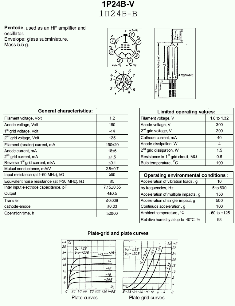

Gerd, have you been able to decypher the datasheet of the 1P24B, and if so, could you mail me or something similar?
Thank you very much.
