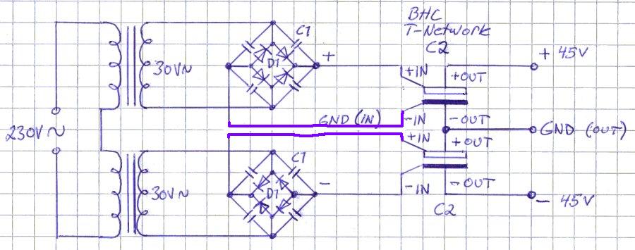

BTW, if we build our own supply using dual rectifiers, would it be best to join the main psu caps grounds together there or keep them separate and join the grounds at the UCD module?

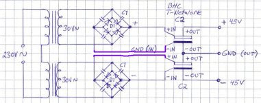

This is how i have made my 4-pole cap supply. It is "accepted" by Bruno
Pasi P said:
This is how i have made my 4-pole cap supply. It is "accepted" by Bruno![]()
Thank you Pasi🙂
So the grounds are joined at the caps and then a single ground wire goes to the UCD module

Yes, i have made grounding as you said.
