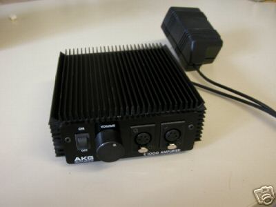

After an hour of contemplating whether to buy the K1000 amplifier on Ebay and having second thoughts by the sight of its horrible plug-in transformer jacco is in a bad mood
