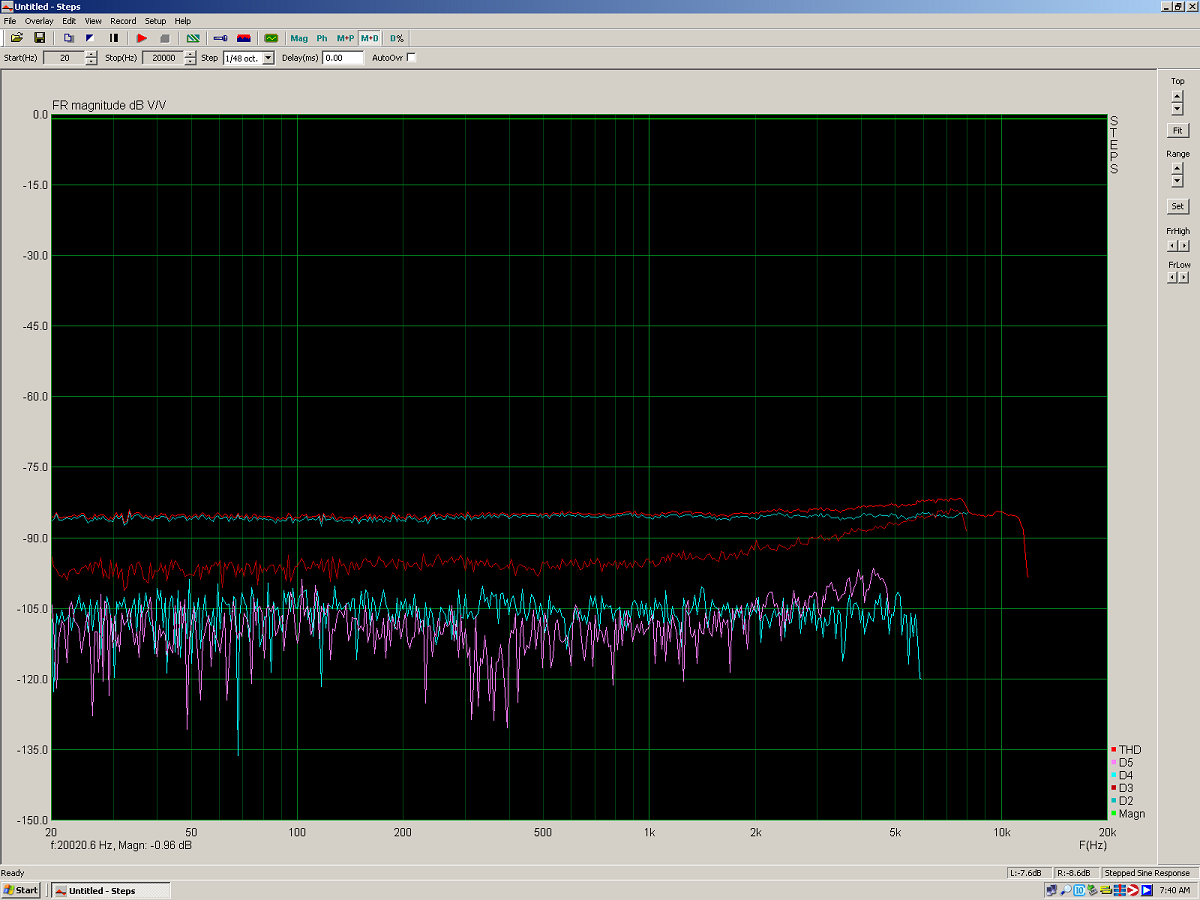

Okay, well here's one to start you off.
This is an ARTA distortion sweep with input/output levels at approximately 0.5VRMS.
Regarding noise floor: I've posted numerous measurements in the past few years showing it. And another just the other day on the miniDSP forum.
Regardless, you'd have to specify which platform since the 2x4 and 2x8 are quite different in this respect.
Dave.

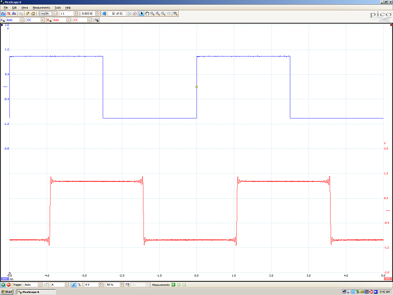

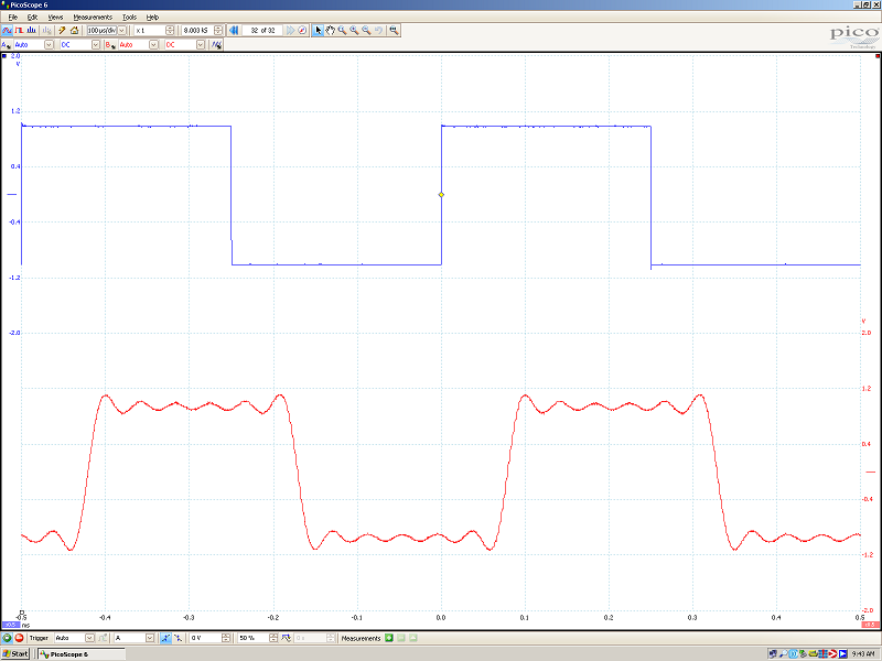

200/2000Hz square waves. (input blue, output red.)

Dave -
Many thanks. Much appreciated.
The square waves are as good as anybody could ask for*. The ripple on the 2kHz wave seems to be around 22kHz, which should be no surprise for a miniDSP 2x4 sampling rate esp. if tested with computer hardware.
But could you explain the ARTA traces, please.
As far as noise/garbage floor, I'd be happy just to hear the number dB below .9 volts and if much of that is at power-line frequencies.
I am curious about both the pedestrian 2x4 and the high-octane 2x8.
My application (a corner folded horn, mid-wall OB, and mid-floor large panels) might require two DSPs in series to produce enough (and long enough) time delays. Is it correct to suppose that if the signal is kept digital end to end, the total harm is no more than with a single DSP?
Ben
*sure, if you've tested a DC-to-X-ray pre-amp, you've seen better, but not a helpful comparison

The square waves were captured via my Picoscope 6. Not technically "computer hardware" since it's not a soundcard-based system. The results are consistent with Gibbs phenomenon for that sampling rate.
The ARTA plot is from the STEPS (stepped sine-wave) application which is a simple two-channel differential measurement where the excitation signal output is applied to the device-under-test and also looped back to one channel soundcard input. The other channel input monitors the device-under-test. What you see is just a simple relative signal plot. In this case there is only measurable distortion of the 2nd/3rd harmonic....the 4th/5th plot are essentially meaningless and buried in the noise floor. If you're more interested in a percentage figure for THD/HD, just simply convert the level on the left.

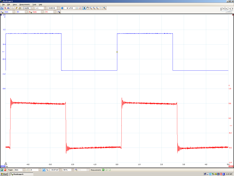

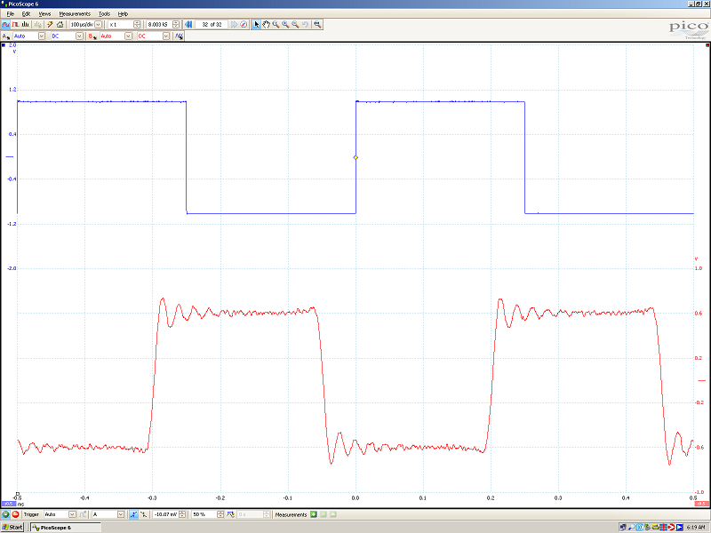

Dave.
Can you do those for the 2x8 as well pretty please?
That response is a probable explanation why I do not like my 2x4, it sounds "wrong". I actually listen to a lot of square waves. 2nd and 4th order analog filters sound better, but I want steeper filters.

No question the 2x8 board has nicer square waves and wider bandwidth. I suspect nobody but a dog could hear the difference... unless there are other limitations of the 2x4 which the square wave shortcomings are hinting at.
Still not the kind of needless over-excellence in square waves you'd expect from a good pre-amp (or an old Mcintosh tube amp, no kidding).
Ben
Ben
Nobody but a dog.....or an audiophile. 🙂
I can hear the difference between the two units fairly easily. Whether this is related to bandwidth or distortion performance or whatever is hard to say. But there is definitely a subjective difference.
Dave.
