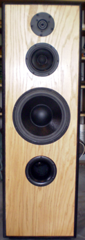

Are there any DIY loudspeaker builders in the KC area? I need some help. First speaker project
I built a pair of towers that rate at 4 ohms but when I hooked them up to the new NAD T754 A/V receiver they clipped out at around -38db after only a few minutes.
I had a MET build the crossovers for me.
My friend brought over his old Yamaha M-70 300 watt per channel and they sounded great.
I bought an older NAD 2200 PE power amp and hooked that up and they sounded even better.
No clipping on either one of those.
My question is why are they clipping the NAD T754? It is rated to handle 4 ohm speakers fine.
Would adding more polyfill tighten up the mids as this might be dropping the impedence down to the 2 ohm range?
At least that is what one friend thinks. It's just odd that the other two power amps push them fine.
This is the drivers I have in it.
Vifa XT25TG30-04 1" Dual Concentric Dome Tweeter
http://www.partsexpress.com/pe/psho...55&FTR=264-555 &CFID=3880583&CFTOKEN=50561794
Seas MCA15RCY is a 15 cm (5’’) cone driver, developed for use as a high quality midrange unit.
http://www.madisound.com/catalog/product_info.php?manufacturers_id=149&products_id=1315
Eosone 10" woofer ( Eosone was Polk Audio's high end series. Designed by Arnie Nudel)
Woofer was used in the RSF1000. Bought two of them from a company in Tennessee that purchased a lot of them when Polk shut down the division.

Specs on Eosone 10" Woofer
Ohm rating is 4 ohms
Power is 200 watts RMS (300 watts Peak)
2 inch voice coil
SPL is 91db at 1 watt at one meter
Freq. Response 30 Hz. to 3500 Hz.
Part Number on the woofer is 1RD0002-2
FS - 36.8926 Hz.
Revc - 3.3481 ohms
Zmax - 14.8696 ohms
Qes - 0.8663
Qms - 2.9809
Qts - 0.6712
Le - 0.5216 mH (at 1 kHz)
Vas - 22.0267 L
Stiff Paper Cone, Foam Surround, Heavy stamped metal basket, 4 pound magnet structure, vented voice coil.
This is a top of the line Eosone woofer used in their 910 Powered Sub Woofer, and also the RSF1000 series.
It is 10 1/8" in dia, and fits into a 8 7/8" mounting hole, and is right at 4.5" deep. There are 8 mounting screws which are 9 3/4" center to center on the diagonal.
Great for a cabinet size in the 1 to 2.0 CF range, port tuned to about 36 Hz.
