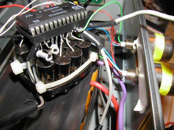

And I like them too😉 And this location seems to be specifically suited for the convenient size of 5 X 7mm non polar, good quality electrolytics. Since the size of up to 4.7u is the same, I would be tempted to use higher value if it doesn't interfere with anything else. What about those green ERO square type caps? .68 or 1u comes in pretty small size too.
Somehow the idea of stacking caps as illustrated doesn't appeal to me much.
