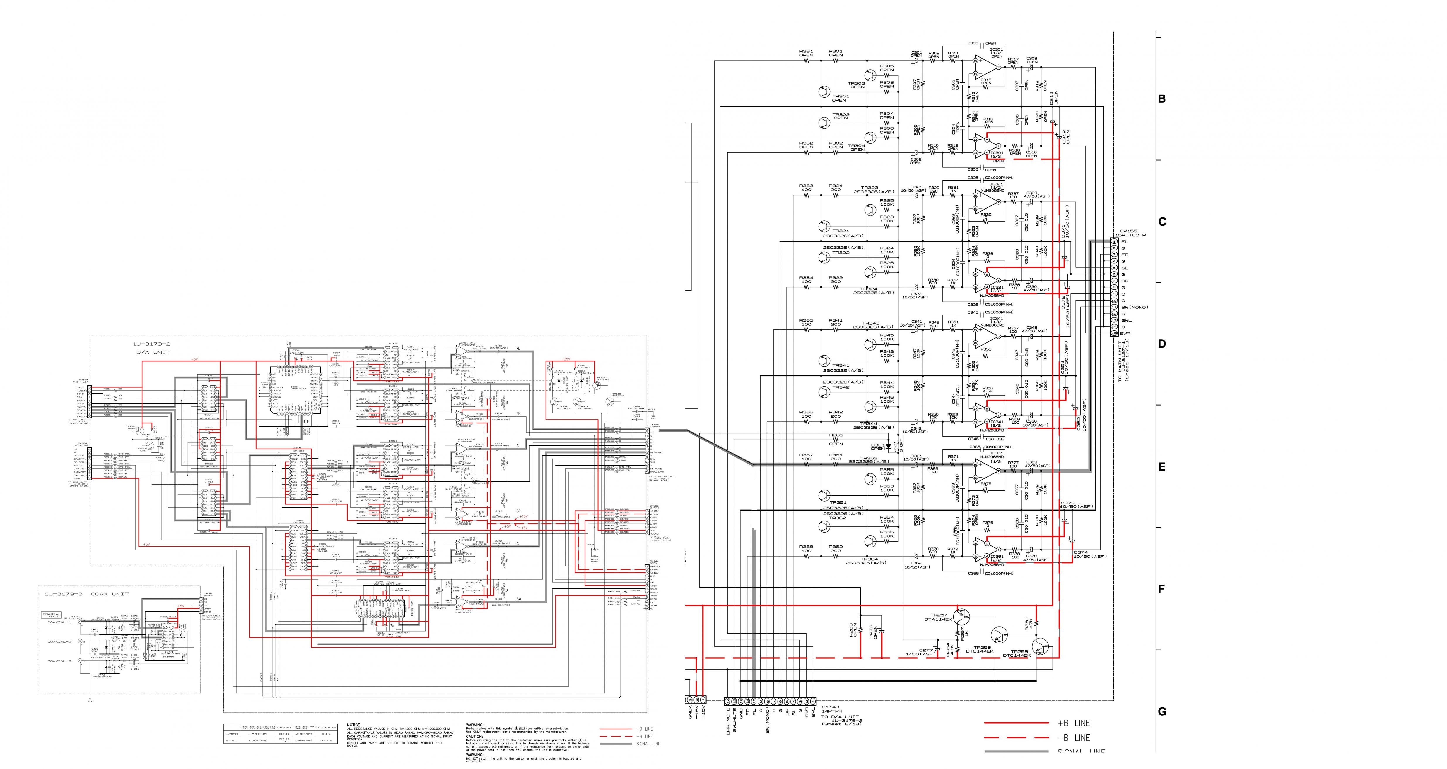

Hi there, looking to upgrade IV/amplification of this dac. dont like the sound( sintetics clear hights, dark midrange without texture,looking for more organic, open ,analogic sound)
as there is 4 chanel dac (actualy 5+1) and i use only two( thinking to simply paralel them (2+2) by paraleling data input and cuting wires from df1704) shoud
any ideas apreciated, thanks

Looks like a lot of work to make that better. Fix/improve one area and the remaining areas that need work may be more audibly exposed.
Looks like clock distribution design is far from ideal. Maybe running from a PLL instead of a crystal too, can't tell since it looks that signal comes in from some other board.
Easy things to play around with might include replacing the I/V opamps with OPA1612. Replace any caps in the audio path with at least 50v or 100v NPO, good film might be better (wound foil and polypropylene film are quite good but not cheap, good metalized film down a level but depends on exact cap design). Decoupling caps for opamps might be easy to swap, again good, low inductance, low ESR film can help a lot for decoupling analog circuitry (not ideal for digital though), but it depends. Have to try one thing at a time and see if you like it better, different, worse, or no change.
Clocking quality tends to affect sound quality significantly too. Change I/V so you like it better, and, again, you may just expose the next lower level problems more clearly.

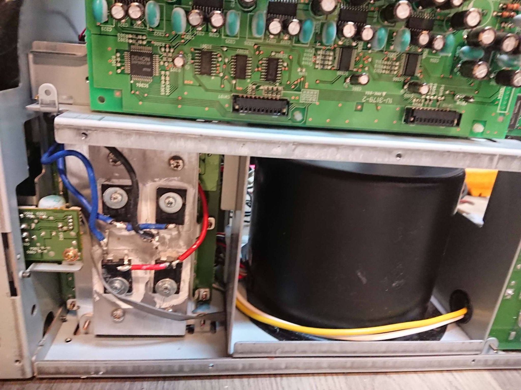

Well I like sound now much better, i did small upgrade to unit which seems change sound a bit

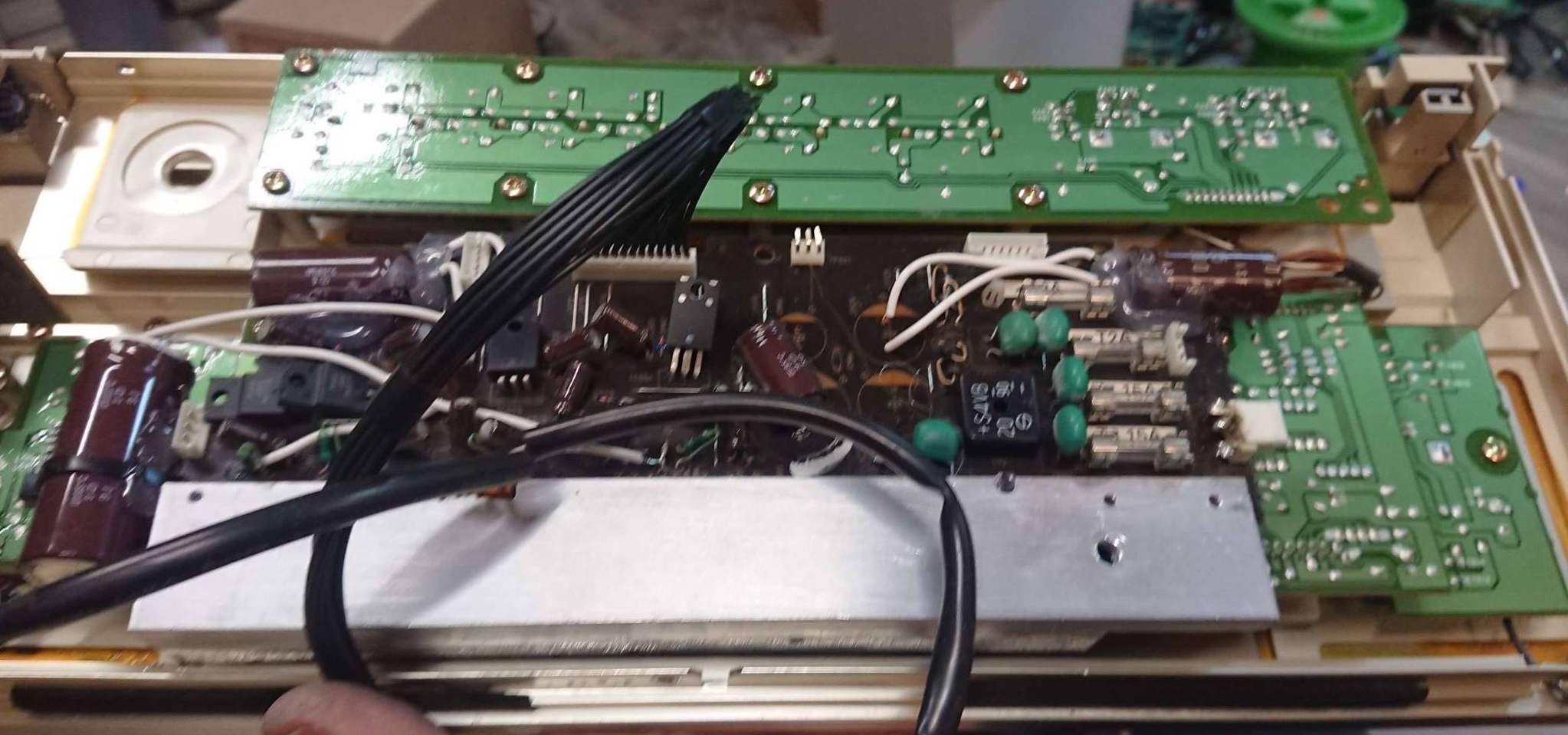

1) one of power suply modified and hided in front panel with custom heatsink. powersuply caps shunted wth variuos MKP (20-30psc) Need to fight with milimeters here.
2) dedicated ultrafast diodes and custom heatsink

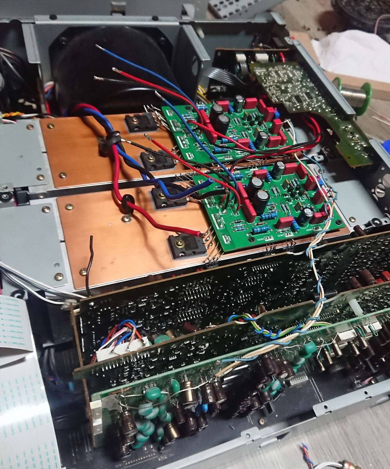

3) omron DPDT relays for 5.6ohm load when speakers protection unload amp

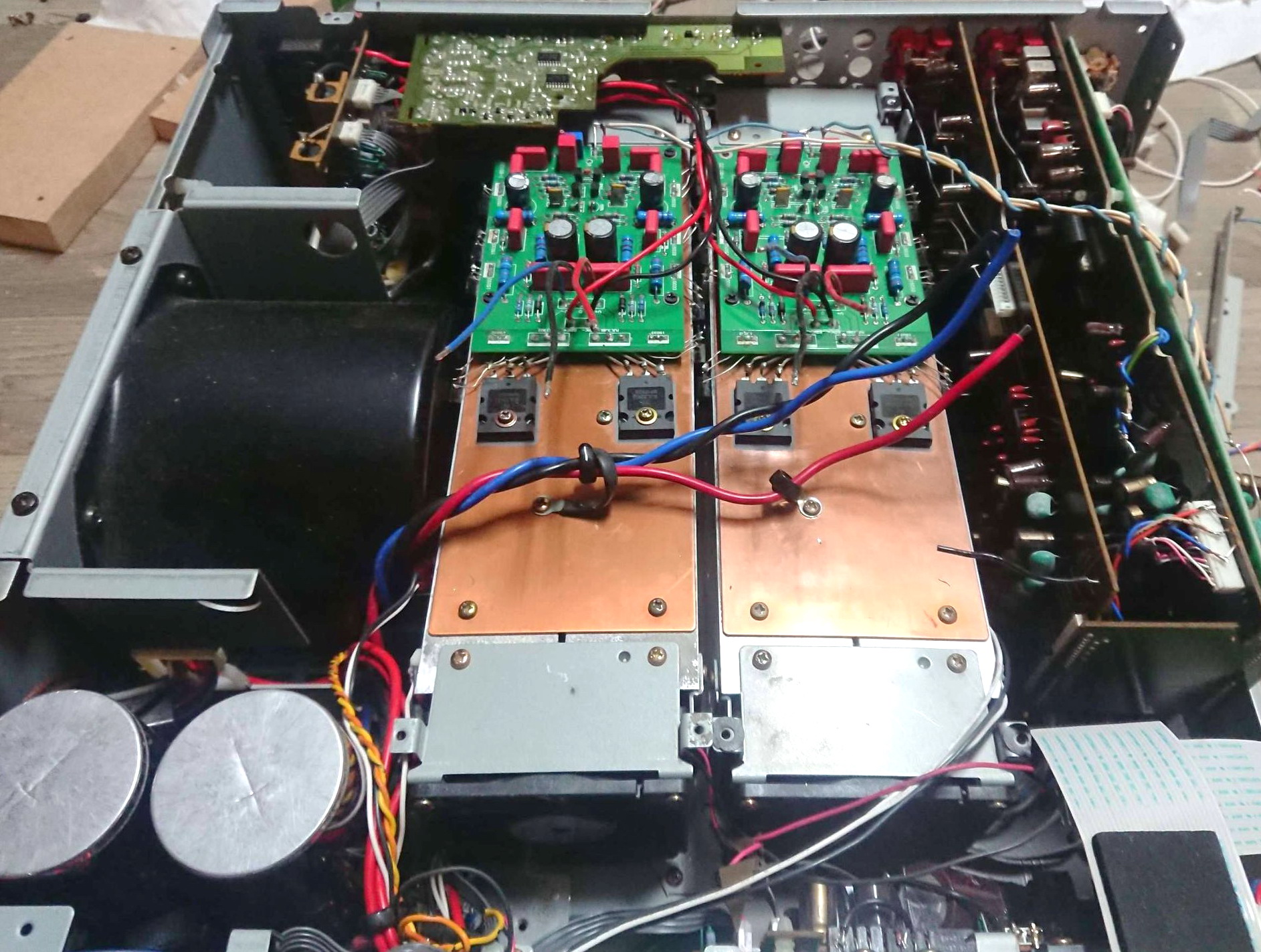

4) video input/ output pcb boards removed and together with 1) enabled to fit second heatinks(total 4 fans and 4 heatinks) fitin is so tight it needed to machine aluminium – fight for milimeters not centimeters
5) 5 channel darlington type power amp section remooved(left only termo sensors) and dartzeel model 108 clone fitted. I needed DPDT realys to protect it (it would blow up and no feedback-goes to osicaltion) when amp security checks and enables outputs

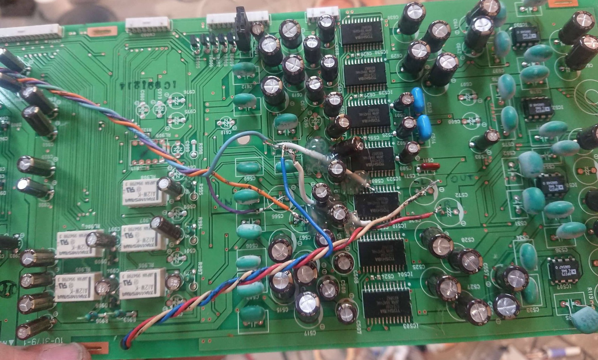

6) removed/bypassed every single amplification from preamps,inputs left only toshiba analog volume regulators, around 26 operational amplifers left out
7) remooved ALL coupling caps in the signal path. there were 9 signal pssing caps per channel (45psc total) no DC ofset of any kind after removal in any secton, not sure why they used so many Elna Silmic caps in signal path..
8) bypassed cuted all signals from pcb to main boards and back, changed with silver and cooper wiring. , most not needed relays signal paht bypassed.

no problem with current- on pcb there is 5x1704. paraleling them will be equal result as pcm63, just not sure what to do- paralel them or make balanced revert phase and feed them from al24 processor(there is outputs for the second pair and its used in other denons)
I think i will go discrete way with d1 mosfet ,its revision or j-fet CEN.
