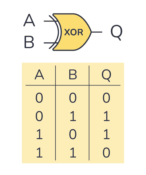

with pcm1704 there is invert pin, now need to invert for older dac chips and not sure how to do this properly.
If you really want to do it properly, you should do it with software because the samples must be negated; just inverting the bits produces an erroneous offset. The easiest way is with a foobar plugin that does the negation and manages binary overflow if it happens.
Thanks Tam Lin, I remember your advices regarding computer for my 24x pcm63p-y dac. unfortunately i will not use this dac (wadia) with computer. after 18years of use computers i moove back to disc transports(cd transport and dvd-audio transports) so in hardware i just reverse data with 74hc86, reclocking at the same LE and clock? ? i didint thought it was so simple. i want to try balanced wadia. all wadia i have is single ended.
As I said, just inverting the data introduces an undesirable offset. It's better to use a transformer to create the balanced signal from the single-ended output of the DAC chip.
The problem is that with binary arithmetic, there is a difference between inversion and negation.

This is implying at hardware invertsion od the data word. Since there is no "software" burned into the pcm1704.with pcm1704 there is invert pin, now need to invert for older dac chips and not sure how to do this properly.
So If this hardware way is working for PCM1704 the same way should work with other PCMs with same input format. I would try the same logic for booth data lines original and inverted. To have same very small delay of data lines.
