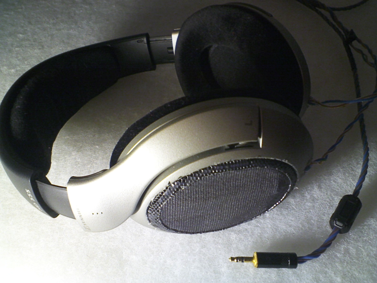

Anyway, I'm using a modified pair of HD555s. I've not only done the "soundstage mode" but I've gone a bit further and done a bit more. (The metal grill is just gone basically. Instead of either the plastic or metal there is only a soft speaker grill cloth meant more to protect it from gathering any dust inside than anything else.) I've also put the Canare L-4E6S cable on it. (I've attached a picture in case you're at all curious.) The end result is something that just simply suits me. It may not be the best of the best and definitely isn't for everyone, but for me it basically is just perfect. I actually also have had a few others in the past and even still have MarkL-modded Denon AH-D2000s that I've been trying to sell for a while now. None of the others have suited my preferences and hearing quite like these modified HD555s have done. (The ultimate irony is I got them on a whim thinking they might be more convenient for my portable devices when they were marked way down on Amazon once and did the mod more just as a fun project, then ended up loving them so much that I've abandoned everything else and will probably have to buy and mod another pair someday so I'll have a backup.) It's worth noting that on the go I sometimes use a pair of modified HD280 Pros instead (due to how well sealed they are -- I don't want other people hearing what I'm listening to and don't really want to hear too much outside noise either) which I've modified with the Bluetak mod and put in a couple of capacitors to act as a first-order high-pass filter to some small extent (it's not perfect, but it's sufficient for its purpose.) I don't really like the HD280s at all, but with the AD8620 they do tend to still sound a bit better. (I should add here that I don't actually use them too often.)
Then, when I combined them with that AD8620, not only is the sound more accurate and detailed, but it just seems to fit with them for me. I love it like this and want to keep it that way. I'm willing to some extent to accept "similar" but I'm a little hesitant even about things others find to be better since not all of the "better" things suit me so well. That iBasso D3 for instance is obviously a far higher-end headphone amp than my CMoy, yet it just doesn't work for me like it does. I don't hear that detail or get the enjoyable sound from it that I get with the AD8620 CMoy. (It seems to me like the AD8620 overall a lot warmer by comparison. I don't really understand why the iBasso D3 seems to not have as much detail and everything though. I guess it just is so much more neutral that I simply don't notice those details as much. Overall to me the iBasso D3 just seemed "boring" for lack of a better term. At this point I'm trying to sell it too, lol. I really only got it to complement the D2000s anyway.)
Anyway, yes these are low impedance headphones, but trust me, the CMoy drives them just beautifully with clarity and detail through the full range (or at least all I can hear of it. Beyond 16KHz or so I don't really hear much due to hearing loss from age and too much music too loud over the decades.) Even the bass is just amazing and I absolutely love it. (At least with the HD555s.)
