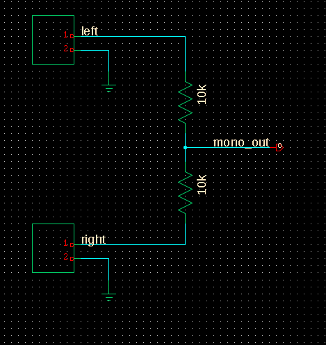

Really? This question crops up every few weeks and a simple short is often the agreed solution, provided the resistors are present. A few hundred ohms is plenty to avoid any damage, and this is the range of most 'stability' resistors. Shorting two outputs is fine when they are just L and R of the same stereo signal. There might be a bit of distortion, but mono isn't really hi-fi anyway.
Do you guys mean something like this?

If a buffer is also necessary, you could need such bells and whistles as you would find in an audio mixer but assuming your output is to a high, line impedance > 10k and you just want something for a couple of weeks, there's little point complicating the task.
This is all most stereo amps and subwoofers use to derive a single source.
Its still poor advice and will cause distortion even though destruction might
be unlikely, in some cases it isn't. There is no need for the outputs to service
the excessively high difference currents such an arrangement would cause.
A particularly bad case is deciding to use only one stereo input "as it ends
mono anyway", I'm sure you can work out the very poor consequences.
rgds, sreten.
I think you should use that method. With 2 resistors.
It is perfectly good enough.

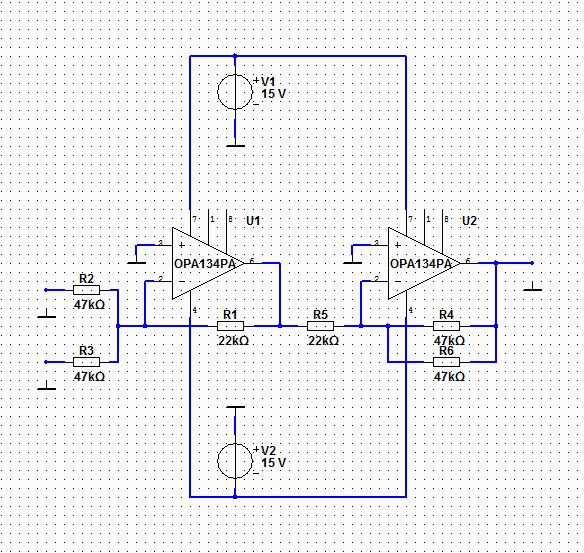

I dont think you should bother to build this. See my diagram.
It is however an OP-based mixer for 2 channels.
It will keep level and phase of the signal.
The OPamp is one OPA2134 = a dual op.
