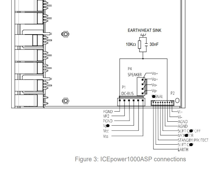

The 1000A is a complete amplifier with power supply. It's bandwidth limited, that's the only difference to the ICEpower 1000ASP. The connectors of the DC-Bus are identical.

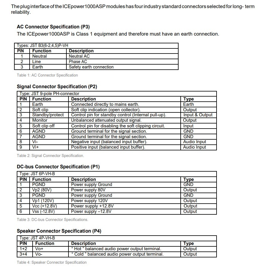

You can use practically every power supply between 42 and 80V, 75V suggested for 4 Ohm, 80V for 8 Ohm for full power, it doesn't even have to be stabilized. It needs additionally +/- 10-15V which need to be stabilized.

You don't need the PS to provide all 3 voltages, if you have a separate one for +/- then the high power one is easier/cheaper to get. I don't know where to get SMPS in the US but I'm sure you can find some. The amp has a very high ripple rejection.

If so, I would just get another 500ASP unit off of Partsexpress. Replacing it with a 1000ASP (also at Partsexpress) to power the two 500A modules will still provide 80vdc as the 500ASP, so you will not get more power.
Do not try to power the 500A modules with the 120 vdc header. It is for the 1000A Unit, and the 500A will NOT like it.
Dont forget the +/-10-15vdc line from 500ASP to 500A
I thought that was clear by mentioning that the 80V are the upper voltage limit (esp since he said he got an EE degree) but it's good you've explicitly said that.

It's good to know about the 120 VDC header on the 500A.
I'm unsure what you mean about the +/-10-15vdc line from 500ASP to 500A

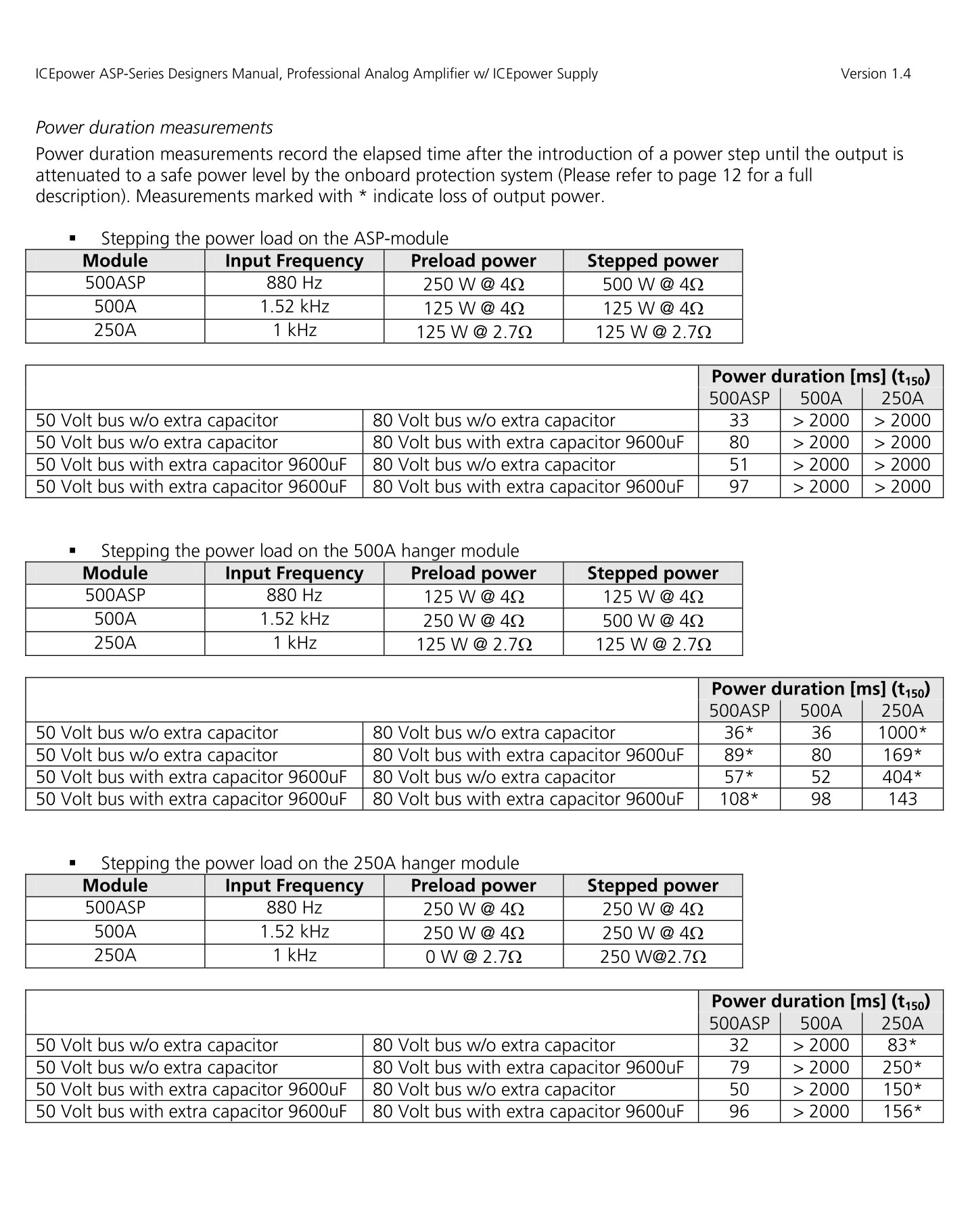

That's definitely worth it. And it's not 'just' 50W more, with the big PS it can hold the peak power a lot longer. I'd suggest to install it with the additional capacitors (rail voltage + 30% (or above), low ESR).
Disagree, it's a marginal improvement at best - especially if the amplifier on the 500ASP is not connected to a signal and just idling. Have you got measurements to back up how much power you really need or is it just speculation?
Also, the 1000S is a positive/negative supply for the newer 300A2/400A2-modules, so the output is +/-. Some symmetric PSUs do not like if you just use one rail and if that is a not a problem you are unlikely to be able to get the full 1000W power out of it, so this is IMO completely off the mark for this application.
