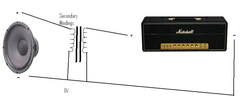

Can you clarify the wiring of the transformer for me? Is the speaker wired to the secondary or primary? Does it have to be center tapped? (I assume not)

Yeah, sorry. I was on a week's skiing holiday, so I haven't been replying.
I'll explain the drawing here.
You'll need a tranformer of suitable VA rating. 100VA for a 100W head, etc.
It needs two secondaries, because having only one means you can't keep the voltage the same. Anyway, you wire the speaker to one of the secondaries. Say you picked a 30-0-30 transformer. You'd put the speaker positive terminal to the first 30V winding, then the amplifier positive output to the second 30V winding. The 0V is shared.
Important: you must insulate the mains taps. It's a transformer, so you'll get lots of voltage out from those, so tape them individually, then tape them all together, to ensure they don't go astray.

I'd advise you make it switchable, so you can choose between transformer on/off, so you can get a direct comparison.
