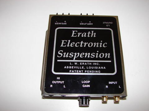

His servo had an "ideal model" or "electrical equivalent" of a loud speaker in it.
His servo compared the original RCA input feed to the the output of the amplifier and looked for a difference. It ALSO in conjunction looked at the response of the "modeled" loudspeaker and compared that to the original signal. Then it made corrections based on both of those PLUS the "known parameters" of the actual loudspeaker being driven.
In the home I used a pair of Eminence 15's each in a 1.25 cf sealed enclosure which was flat down to 20 hz. Those are being replaced by dual Aluminum 10's.
In the car I used a pair of Parts Express 10" woofers in a 1 cf box. WAY MORE than flat to 20 Hz because of the cabin gain. Now I am using 8's in a .5 cf box. I will eventually get around to reducing the feedback of the servo to adjust for cabin gain. It just hasn't been a priority in life.
