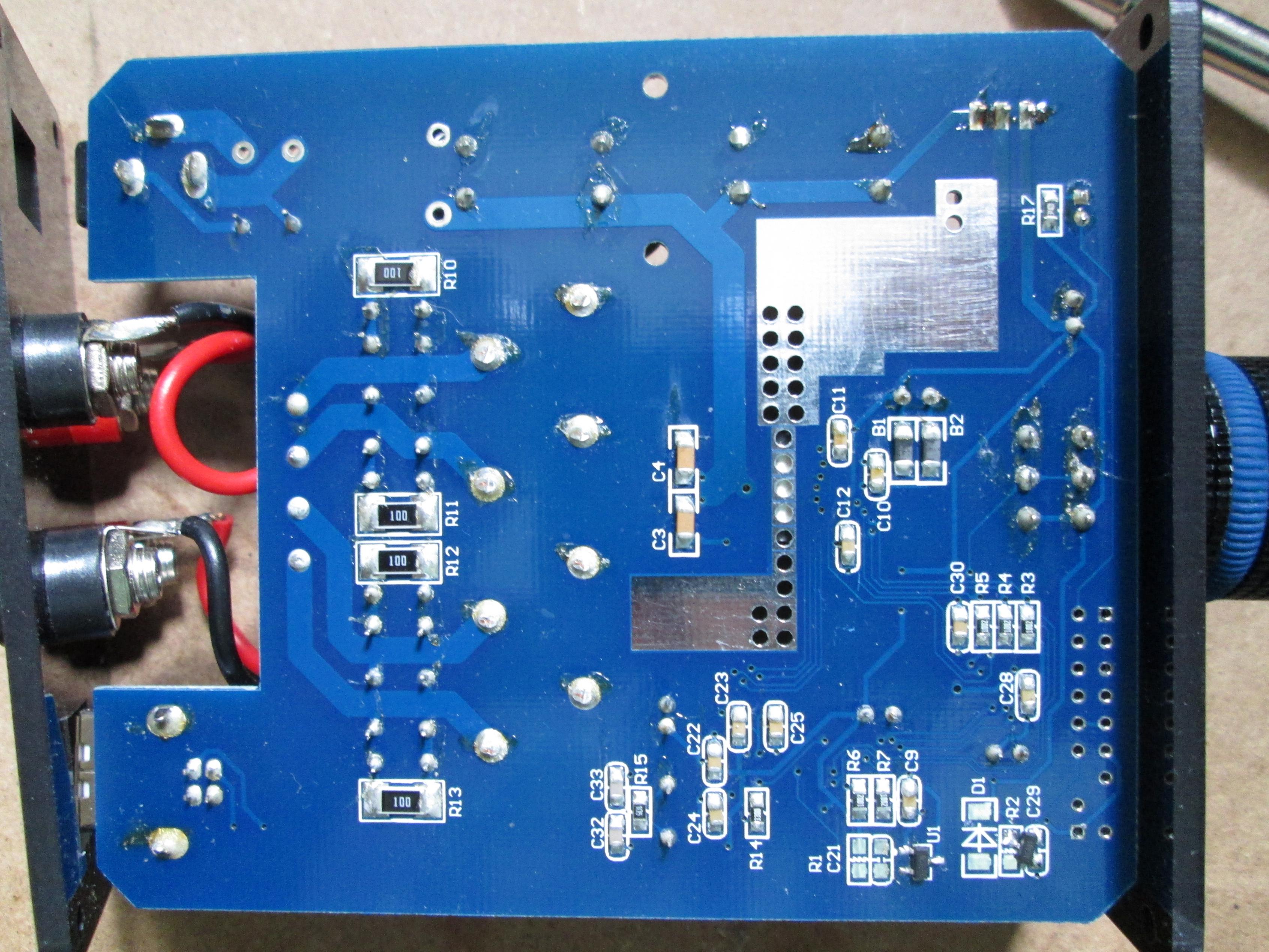

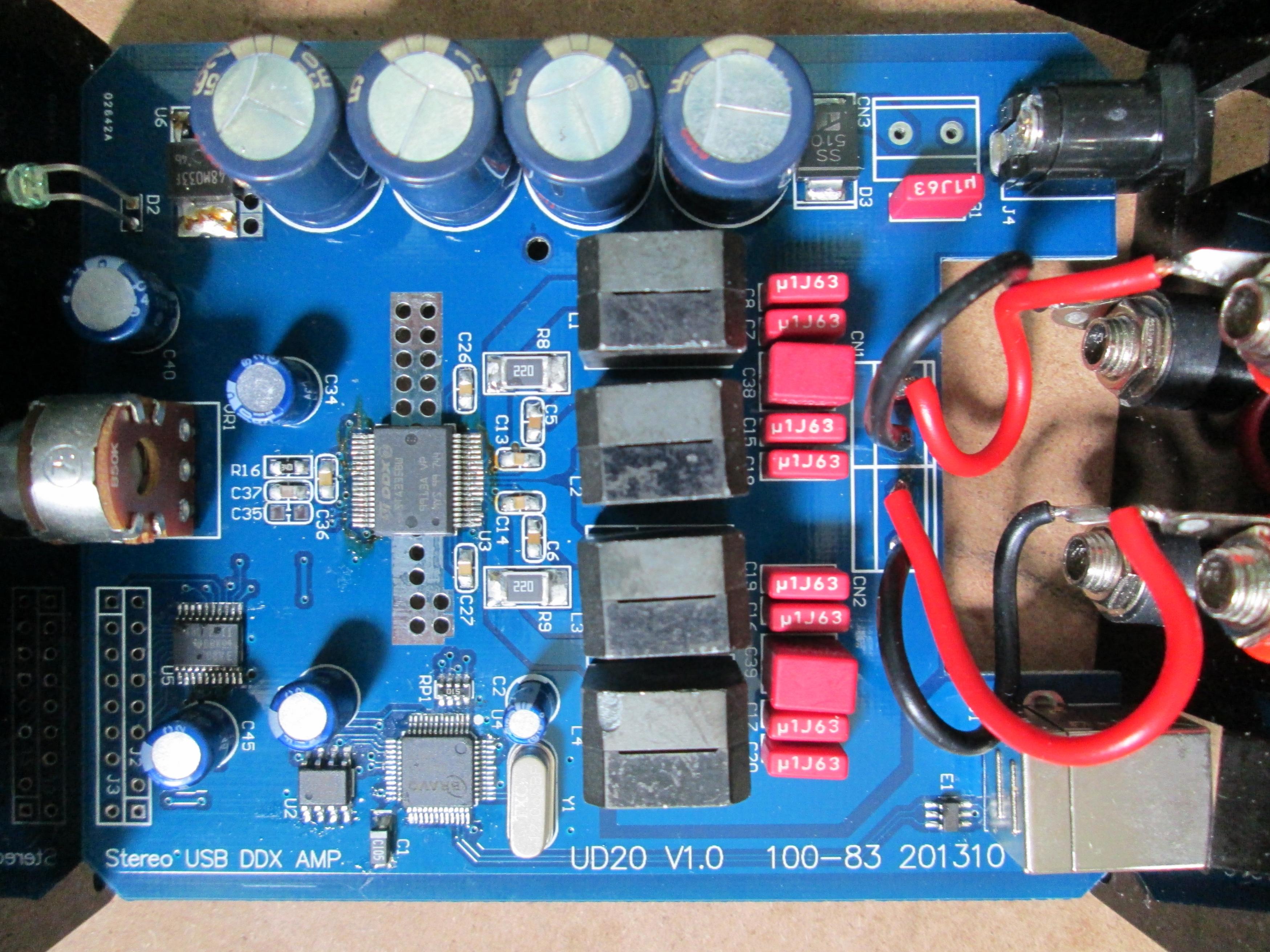

UD20 and UD80 both use the Savitech SA9023 USB receiver and then pass on I2S (with control I2C on the side) to PWM STA335 20W (UD20) or STA328 80W (UD80)
Anyone know where to find the SA9023 datasheet? 😕
Just about to mod my UD20
UD20 20W STA335
View attachment sta335bw.pdf
UD80 80W STA328
View attachment STA328.pdf
PS oh ya, check out the un-used features of these kinds of chips (and that's 2007/8)
