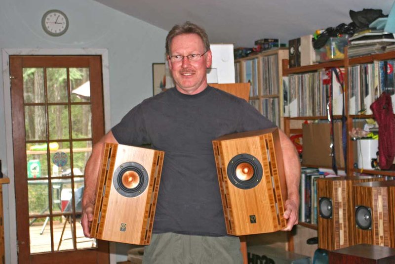

The Mar-Ken7's you built make quite nice desk-top monitors.🙂

FWIW, I think a desktop nearfield system is an almost perfect scenario for a single driver system. I mentioned the specific WK models in keeping with the Fostex theme of this thread, but yeah, there are several other flavours on the menu, and MA such as Alpair7, Pluvia7 or Alpair6P would be near the top of my own short list. We are now blessed(?) with truly an embarrassment of riches from which to chose in this category- certainly compared to when I first dipped my toe in the pool - beware analysis paralysis.
The MarKens to which Jeff alluded would be found here:
Frugal-phile | Box Library / Mark Audio
Note a wide range of enclosures for specific driver models - not all of which I think any one person built. I came close, but not all. Dave devised a general topology that allowed for fine tuning per driver by adjusting net volume and slotted port dimensions.

Here’s a photo of MarKens referred to above

That has the Classic Golden Ratio version of Jeff’s dMar-Ken7.3. The more exotic rectangular and trapezoidal as well as the compact floor standers, are part of a much larger paid planset.
[/quote[ not all of which I think any one person built. I came close, but not all. Dave devised a general topology that allowed for fine tuning per driver by adjusting net volume and slotted port dimensions.[/QUOTE]
Chris has built a large number of miniOnkens, but really only a fraction of the large number of them … who knew, when Chris named the 1st FE127 unit a Fonken, that there would be 100+ designs based on the same theme and alignment.
