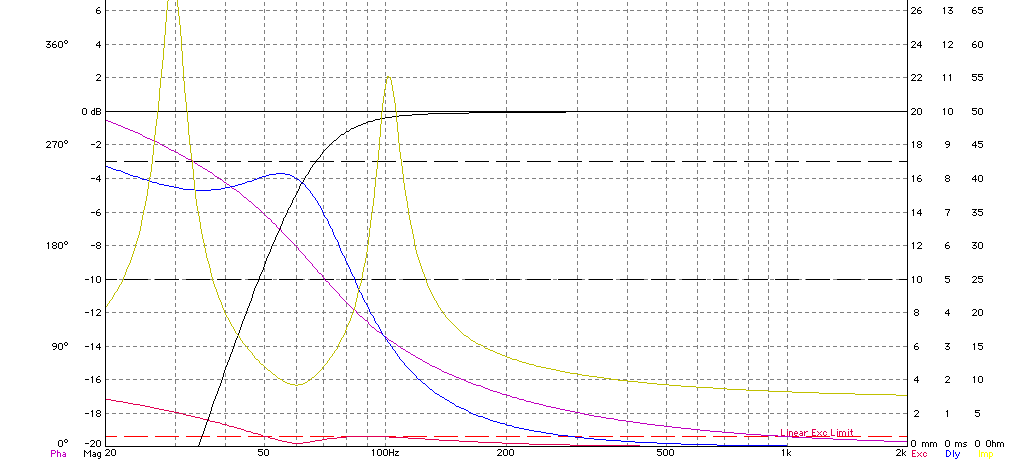

Idono Dave, the sim looks pretty bad.😱
Ok, I take that back. With the Fostex published ts values, it looks fine.

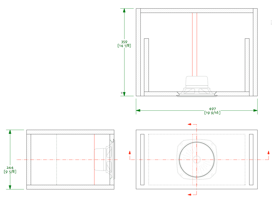

Right, sorry for the delay. Maximum sizes I could get away with are 18" height, 20" width and 15" deep. That help? If it's too much aggro let me know and I'll just knock-up a bog standard Fostex box.
Ta for the offer of help.
DTB
The design is pleasing and looks uncomplicated to execute. Thanks for posting it.
variation on a theme by P10-gnini
Not described in detail, but taken as "given" by anyone familiar with Dave's designs, is that the vertical panel / brace "kissing" the driver magnet should be mounted off center line, and "holey". As well, we've found best damping with all panel walls lined with something like the 1/2" Ultratouch denim insulation - don't occlude the internal slot port openings - and adjust as needed with addition of your favorite flavor of cryo treated virgin cashmere wool fiber-fill - you know from the ugly goats.

<Doffs cap> Thank you DaveD + ChrisB.
Off to the shed I must go.
*salutes sharply, turns 180 degrees about on one foot and collects plans from printer*
