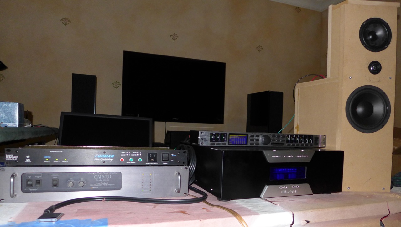

Finally was able to find the time to complete the first prototype speaker. This is a satellite portion of the 3.3 or 2.9 with some minor modifications using 3/4" MDF instead of 1" MDF.
I have the top two drivers off to the wrong side due to late night SNAFU, but the cabinet is only screwed together right now anyway. There were also a few other lessons learned regarding cabinet construction that, so that I will definitely just rebuild when I'm ready to do something more final.
There are a few options for the subwoofer. I have one NHT 1259 in a 3.5 ft^3 sealed enclosure (pretty much just followed the standard builds posted on the net for almost 20 years). I have a NHT SW2 that I used for my quick demo connected through the Carver PM1.5 you can see in the picture below. The other amp is an Elan 12 channel amp I scored on Ebay (70-90W/ch). Really neat for quick hookup and testing of active speaker designs when combined with the Behringer Ultradrive Pro. I used the published XO settings and have the upper two drivers wired out of phase with the 6.5" woofer and subwoofer (or did I misunderstand the wiring issue?).
The enclosure is not 100% sealed as it is only screwed together, but its pretty decent. There is no stuffing yet either.
Despite all of that, it's pretty good. I haven't taken any measurements and all amp and gain settings are at best ballpark. I can't wait to (a) build the real XO and (b) dial in the correct gain and amp settings using measurement data.
One remaining question is whether to keep the sat/sub configuration or attempt to build a full range 3.3 clone. Since I only have one 1259 woofer it won't be 100%, but I am interested in several options:

The baffle width is critical- there's some interesting subtlety to how they avoid the baffle step. Likewise, you'll want to use the original height- the interaction with the floor was taken into account, no "Allison dip" in any of my REW measurements. Use an open cell polyurethane foam strip on the outside edge- it makes a difference.
Thanks Sy,
I wasn't aware the baffle width had that big of an impact. Likewise I never thought about floor interactions. I agree about the foam strip, but it's not necessary yet at this stage. I will have to dig up the e-mail from NHT suggesting where to buy the right kind of material (assuming it's the same used on the VT-2 and other speakers).

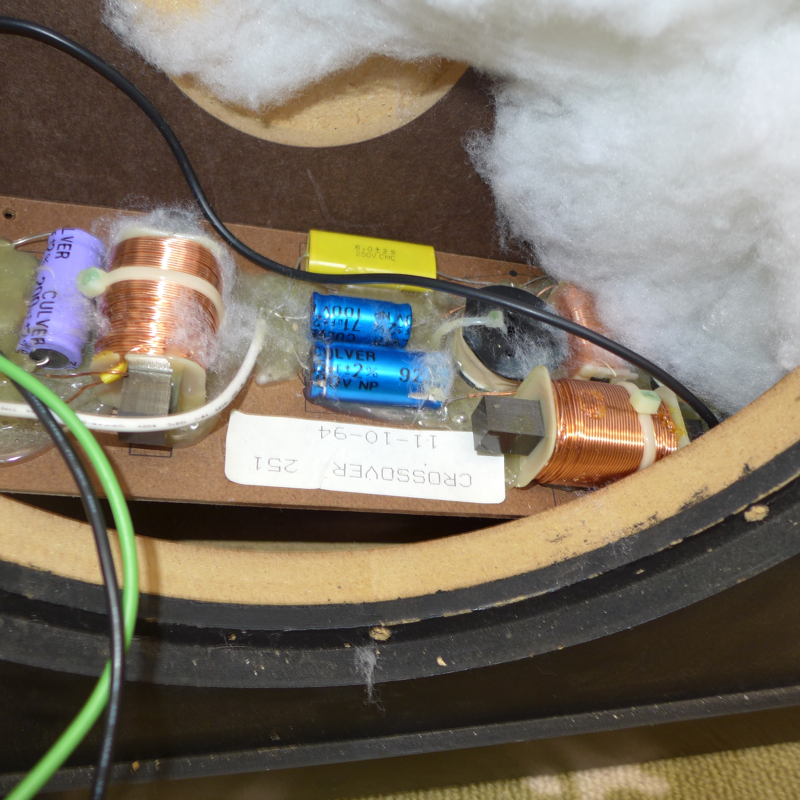

Sorry been away for a while, but stumbled into a great find the day I came back home. Knocked $100 off the asking price because one of the 6.5 inch woofers was silent, but I have spares and figured based on Sy's and Jack's comments it was likely in the crossover anyway. I've been waiting so long to get a pair, I wasn't going to let that stop me.
Sy, I know you'll recognize this picture in your sleep ... just wish I hadn't spent 45 minutes trying to get the 12 inch woofer out before wondering "how did Sy do that?" and re-reading your pages.
A 100uF, 50V capacitor from Radio Shack is connected in there temporarily until I can reach the NHT support folks (hopefully they still have some old stock parts) or someone else can point me to where I can find a 92.5 uF NP electrolytic capacitor. Bottom line though: The lower-mid is again functional!!! All I can say is thanks Jack and Ken and the rest of the team that created these beasts - unbelievable! I had no idea. I've never heard anything even remotely close to this good - and I don't mean to be knocking the two pairs of VT-2 speakers I own. Even with one dead low-mid woofer it was clear I had entered a new realm of sound quality.
You can build it up out of smaller values- it will help to have a capacitance meter since electrolytic tolerances are, ummmm, generous.

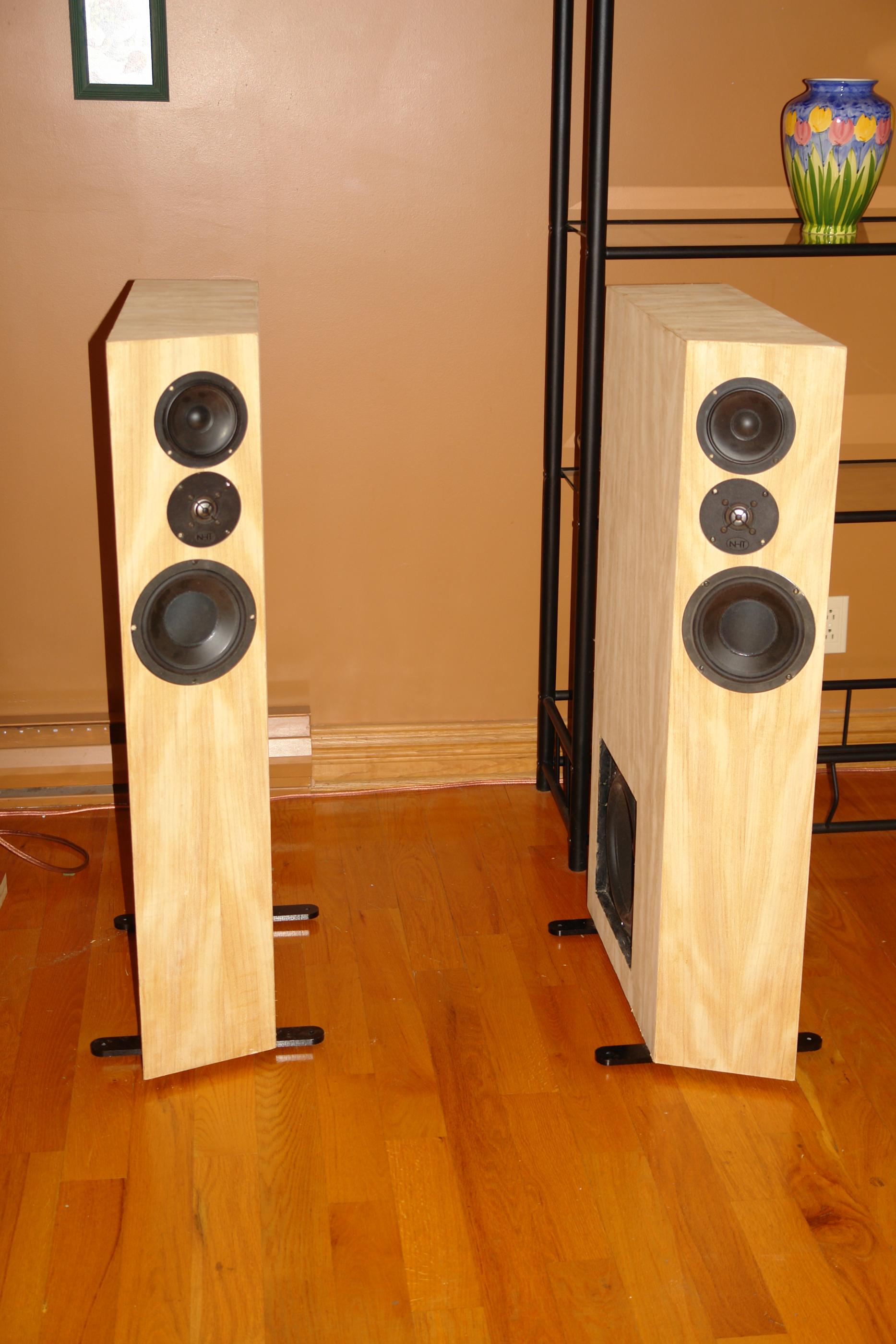

These are truly great speakers, even before the mods. When I first got mine fired up, I spent a few hours playing with the setup and got them singing- it really is worth the time to really get all the distances and angles locked in. The dynamics and the precision of image and soundstage are what really hooked me.
WOW! Awesome!!!
Is that a wood veneer or did you use solid wood construction? It looks fantastic.
Thanks! Yes this is wood veneer. As I said, I'm up for cloning the 3.3 ( got all the original drivers and Xovers bought on Ebay ) However the cabinet drawing on SY site confuses me quite a bit. I can see on this pic that the side or part of it has a backer board just as well... Is it a 3/4 or 1 inch thick ? Same dimension of the one the one in the back ( 13.5 x 13.5 ) ? The separator boards should'nt the be 5 inch wide instead 7. Do both of these separators have 3 openings ? Would be very grateful if you could provide me with these informations ( while your cabinet is still opened ). Finally I replaced all my NP electrolytic capacitors and agree with SY have a capacitance meter handy when buying them. Yes their tolerances may sometimes exceed 10%...
I will still continue with the cloning project, but am finding out rather quickly that sourcing the XO components is only slightly harder than getting Mr Spock to be emotional ... or at least I'm obviously looking in all the wrong places. The only places I know to look at Mouser and Digikey and as a relative newby in electronic circuits I can't say for sure I'm right, but it seems like they don't carry even one single component that matches the 3.3 crossover spec sheet. I must be missing something here, but I have no idea. I might have to settle for an active XO approach in the end.
You should use non-polar electrolytics or back to back polarized types of twice the value.

Those look like steel laminate from the inductors that I can see in your picture, try to use same type of same gauge.
