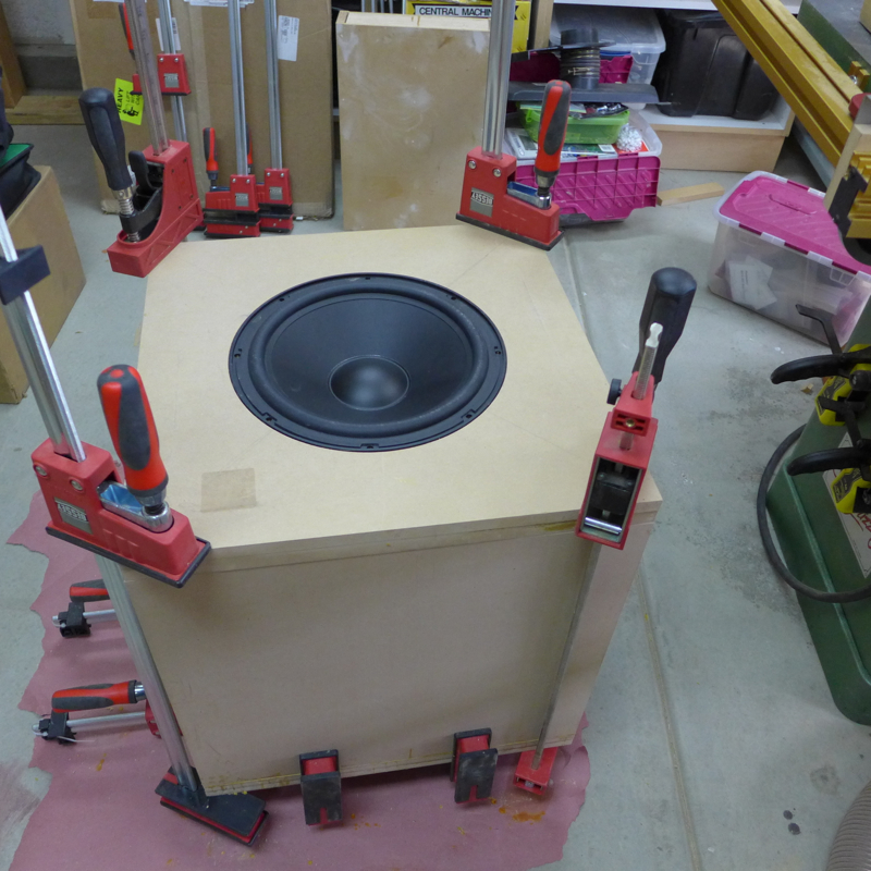

Pic shows dry fit of woofer and front baffle. Glueing interior braces and front tonight.

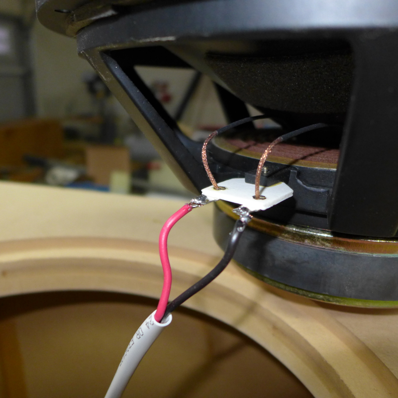

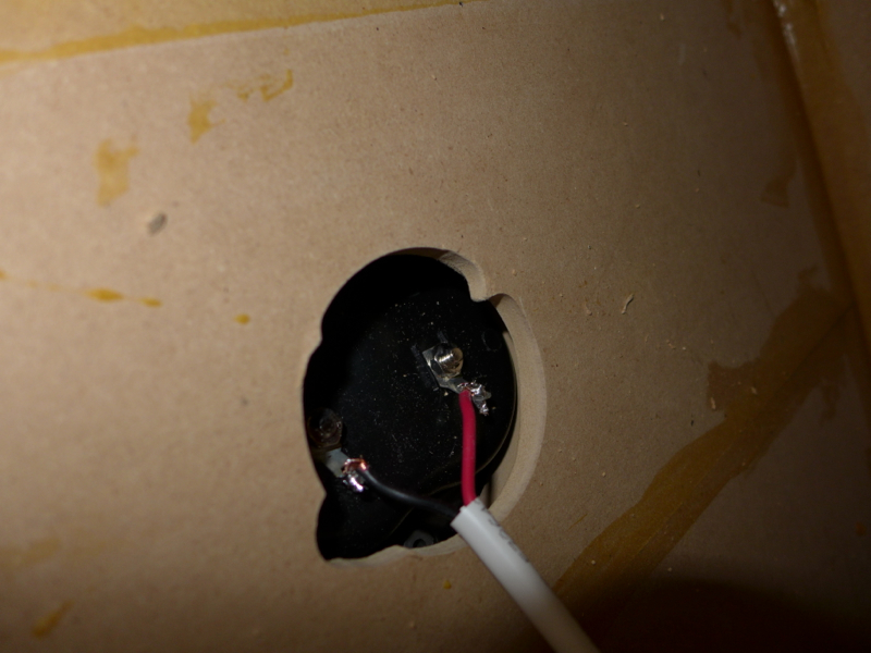

It's not pretty ... it's functional!
Got the sub inside and hooked up. I just got three new Carver PM1.5t amps and am using a sub out from my Denon AVR-3600 with a converter cable into one of the XLR inputs on the amp.
Oddly I couldn't get any sound from the first amp. There's a label on the back about 1.5 mV sensitivity, so maybe that's not what I'm used to with non-pro gear. Will have to see about that.
The pics show the internal bracing, my 1st ever attempt at soldering, and the very temporary setup in our formal dining/living room open area.
The Denon crosses are 80 Hz and I am using the VT-2s as "small" speakers driven by a Carver M4.0t.
Overall I like it. Maybe I'll try to figure out DATS or something tomorrow and see if I can measure test tones and response (REW maybe?).
Off to hopefully make some sawdust and sat enclosures.

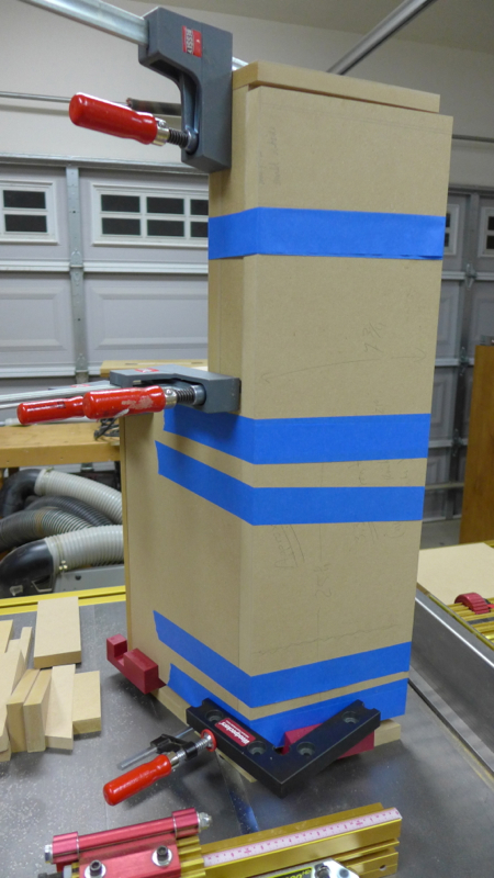

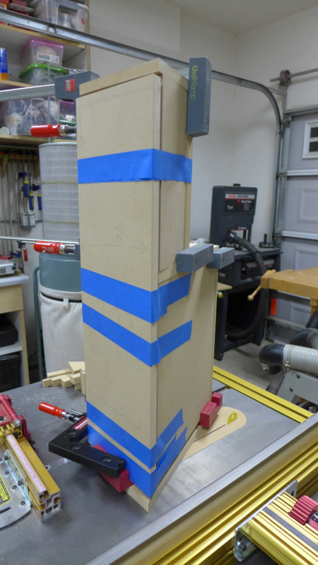

Dry Fit Mockup
After stewing over this for what seemed like way to long, drawing up schematics over and over again (adjusting for 3/4 MDF or whatever), I kind of just took the original NHT schematic and started making sawdust tonight. I had decided from the beginning to start with the face plate and make it full length. Looking at the pictures now though I am going to have to double check the measurements tomorrow when I make the fixes and hopefully glue it up.
For example mitering the fronts of the sides. I just could not figure out what went wrong when the front baffle (nicely mitered at 21 degrees) didn't want to rest comfortably on top of the lower section sides. Once I cut the top I figured it out though. I might have cut the top side panel a little too narrow on the shorter side of the speaker. Other than that I am pretty sure everything either already fits or was cut slightly large and just needs to be trimmed properly.
I think the design looks excellent, much better than trying to adjust the middle horizontal higher in order make both enclosures have the same depth (although that would be a lot easier to construct). Looking way too far ahead, it might be worth having a cool looking design like this and a square box design where the user twists the speakers 21 degrees towards center on his own. That would open up construction to a lot more people.
