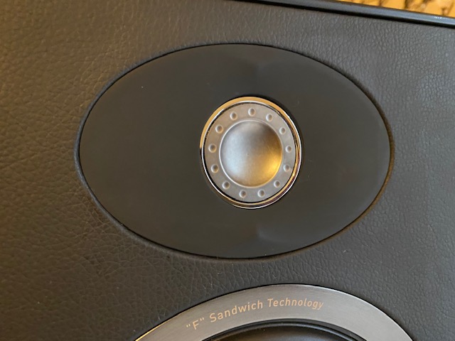

Hello, I just did a 12hr round trip drive yesterday and bought these Aria 936. I had no reason not to believe the guy when he said they sounded great, but unfortunately I just now hooked them up and both tweeters are gone. He is working with me to find out what can be done and offered to fix them. He purchased them in July 2015.
Anyone know how to get to the tweeters? Do the rings around the woofer drivers pry out to get to the screws then access it that way? I’ll be using plastic tools to pry anything on these if that is what is needed. These are 10 out 10 cosmetically.

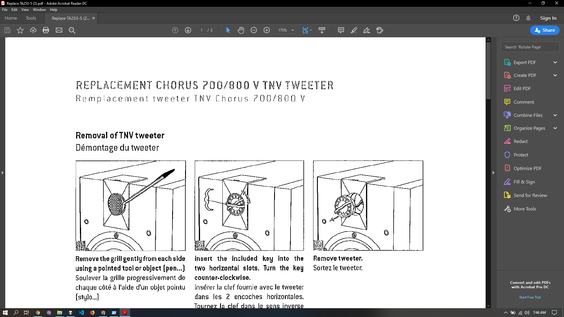

If they're similar to other focal tweeters, these instructions should work.
Look for two small slots on either side of the tweeter.
A special unlocking tool (supplied with the replacement tweeters) can be used as shown in the attached instructions.
In the absence of the special tool, two small screwdrivers which fit in the slots can be used to turn the tweeter 1/4 of a turn anti-clockwise in order to release the bayonet fitting.
The info' comes with the replacement tweeters.

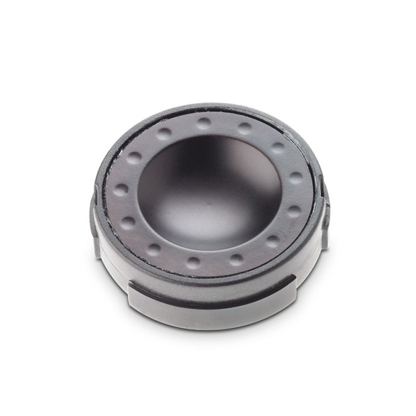

Look at the TNF tweeter in the attachment. The two small slots I mentioned are visible at 9 o'clock and 3 o'clock.
It looks like they are hidden by the circular chrome trim surrounding your TNF tweeters,
Good luck! The tweeters cost around $70 each. I wonder if the seller of your Arias will be willing to contribute towards their cost! The ones pictured in the attachment are probably the ones you want, as it appears that the same tweeter module is used in different Focal models.

Did you investigate the circular chrome trim surrounding the TNF modules? It must be removable to allow the modules to be twisted out.
I have looked at them closely just now, and it looks like the previous owner tried getting into them in the past. I see the gaps in your pic you mentioned before, however on mine, I don't see any gaps due to that chrome ring. I'm just a little cautious about doing any more prying than what has already been done. Looks like Crutchfield is out,,, they don't order replacements.... off to the next.

Yeah, the previous owner has been doing the wrong thing.
It looks like the circular chrome trim ring surrounding the tweeter module must first be prized out to allow access to those little gaps. I understand that you do not wish to damage the ring unnecessarily.
Focal intend their TNF tweeter modules to be easily replaceable - you may draw your own conclusions from that! 😉
