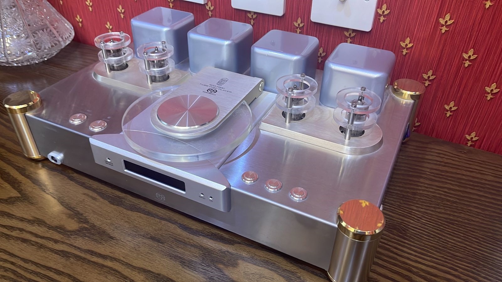

I have a Shanling SCD-T200 SACD player bought maybe 15-18 years ago. 5 years ago it developed the dreaded NO DISC problem and my investigation found that the servo board to fix this was not available, even though the laser is still around. It's the same laser/servo as the flagship Sony SCD1, which has the same fault.
My investigations are summarised here: https://www.diyaudio.com/community/threads/shanling-scd-t200-tube-sacd-player.362298/#post-7153259
Specifications here: https://www.usatubeaudio.com/product/digital/cd-disc-players/shanling-scd-t200/
This player was expensive, heavy and an absolute work of art. Up to now I haven't been able to bring myself to throw it out, but if it is truly unfixable then I'm just about ready to do that.
So this is a last gasp message to wonder whether there are any alternative options.

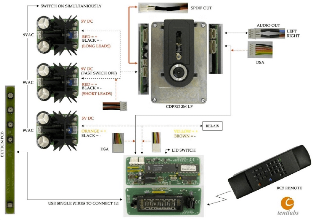

https://www.tentlabs.com/Products/diycd/index.html
There is a transport called b-Drive, but at EUR1073 plus VAT I have a lot of serious alternative options

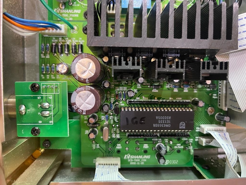

I'm not an electronics expert - not even sure where the servo is... There's aboard marked "CON" which I'm not sure about.

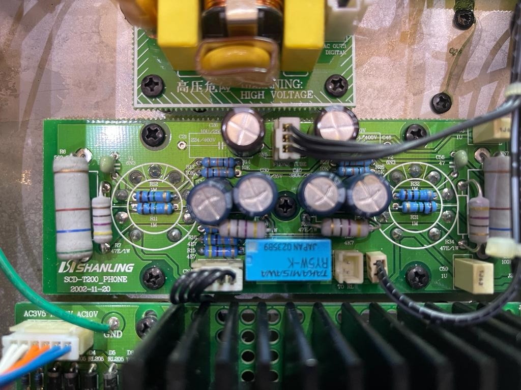

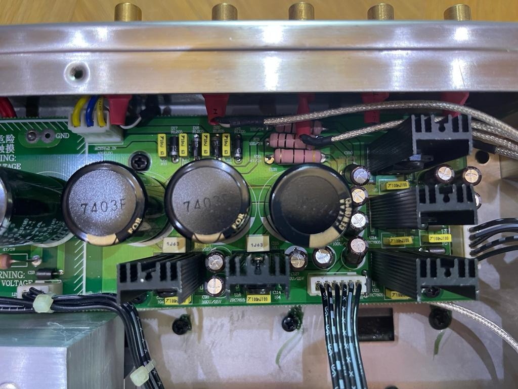

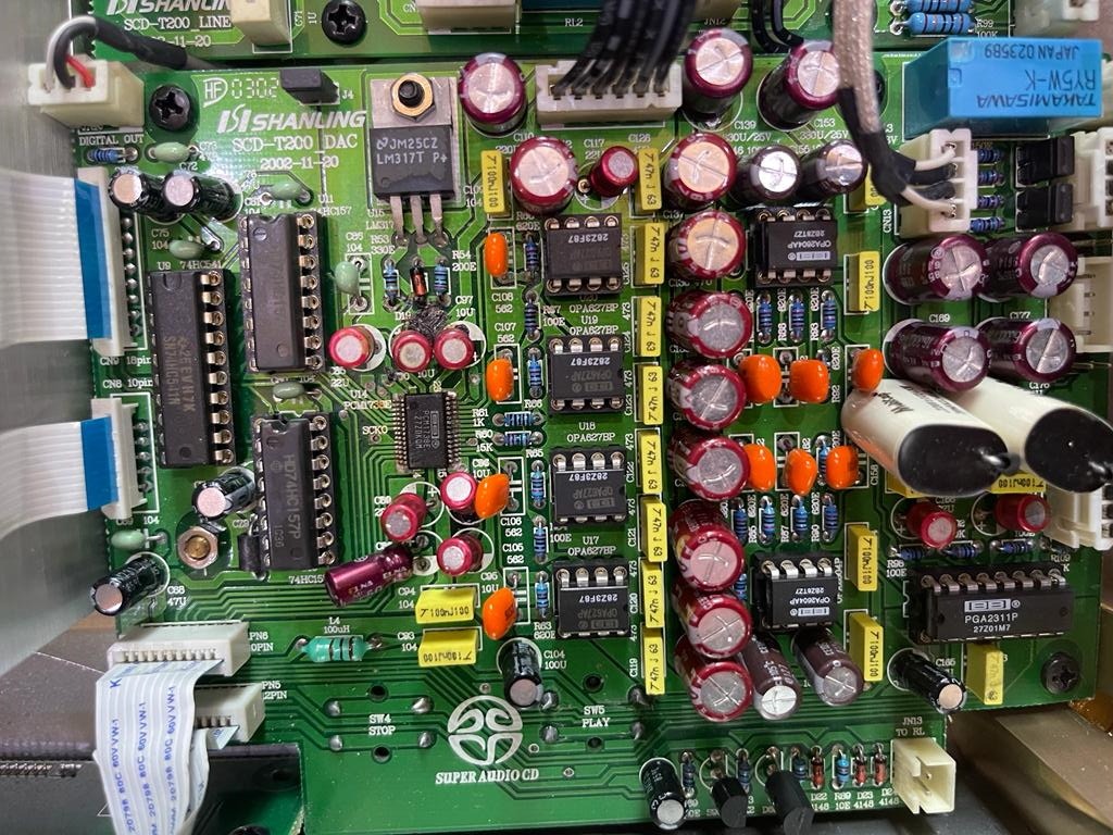

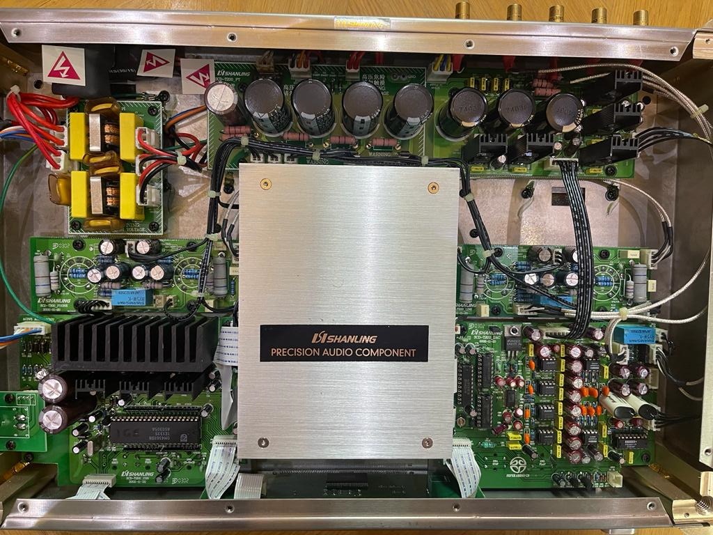

I suppose servo pcb is under mechanism. I've searched images in google of servo pcb, and I've found this link:
https://www.ebay.com/itm/125500175710?hash=item1d3864b55e:g:2tYAAOSwDnhjF4wx
There is a pcb with a lot of big ICs. If you look, there is a tiny Sony IC. But, without spare parts and technical information, we must be realistic, this is a very hard challenge. Maybe in the future will appear information, who knows. It's a shame for this massive CD player well builted.

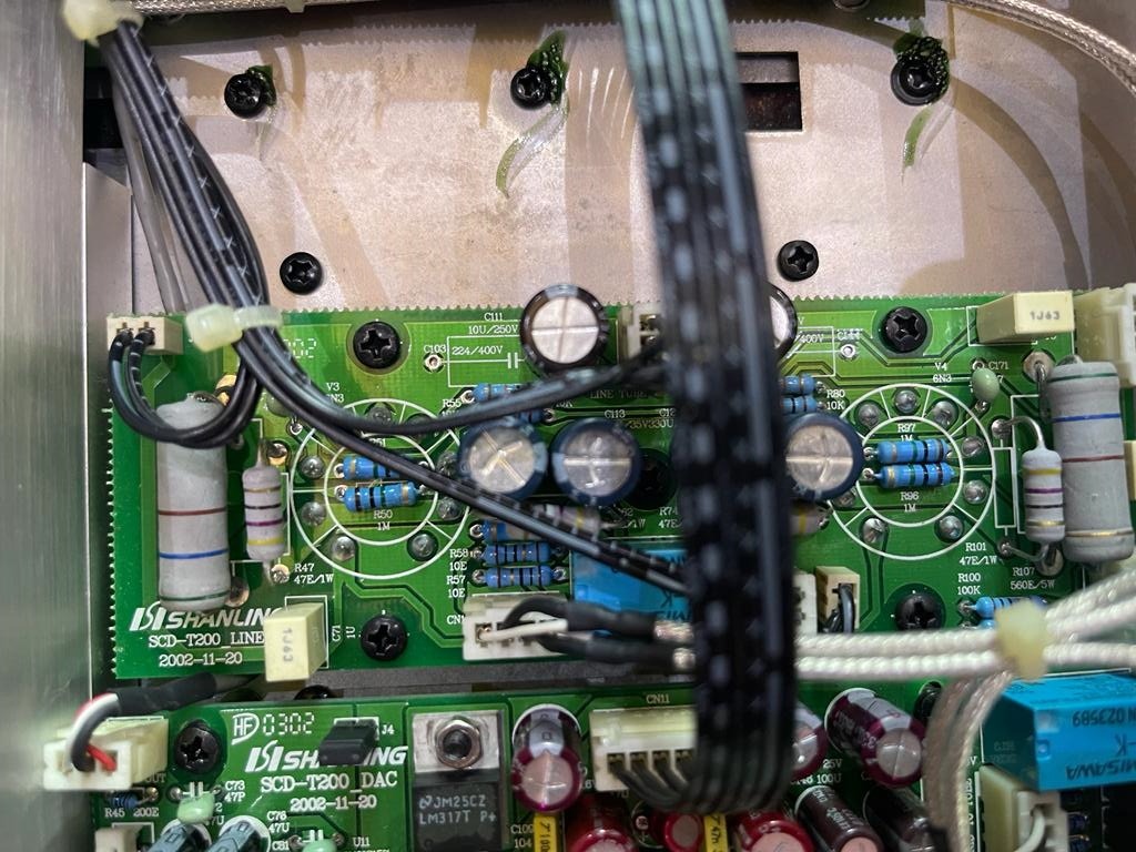

1 In the picture titled DAC.jpg, below the LM317T, between the two red capacitors and a diode and a resistor, there is a black stain. Is it a capacitor leakage, a something burned?
2 In this link, there is a fault in four diodes of analog tube zone. It shouldn't affect cd reader servo zone, but who knows.
http://www.audiotecnico.it/riparazioni/riparazioni_S/shanling/scd200/t200.htm
3 In the servo zone I see the typical BA???? IC by Rohm for to drive the laser coils. Another candidate for a typical failure.
