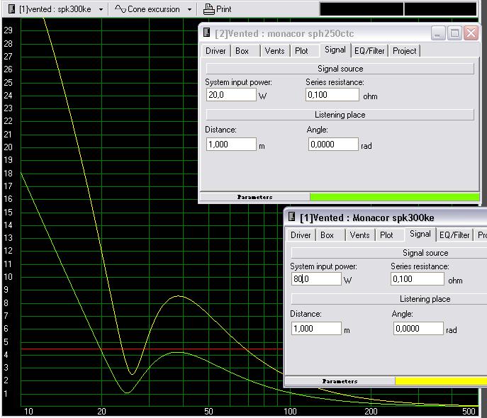

But what I did notice Monacor claims 200W nom. and 300 muzik power.
But the truht is the chassis reaches its X-max at 20 Watt. 😱
It did work down to 18Hz do very nice performance.
So i did check up the sph300ke and I thought it was 80 watt when it reaches x-max.
This is what I mean the X-maxes off sph250 and 300.
