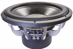

Any experience with DB Drive subs ?
I need 4- 12" subs for a pair of dipole cabinets that I have built.
These DB Drive units look interesting and have about the right Qts
I only hesitate cause they are advertised as car subs and I have not seen much in this or other HT forums about this brand.

DB DRIVE DBDPL12D4
Fs is 25 and Qts is .63 and xmax is .79 inches accordring to manufacturer site.

here's a picture

Have you considered the Atlas 12, it offers qts to .52, 23hz fs, xbl2, and bottomless motor. Is also well proven and not alot more expensive. The Atlas is more efficient, you can use series resistance to bring qts up still further.
That DB drive woofer looks to be designed for pounding out spl, 1500w power handing isnt needed in a dipole. Inductance on the DB Drive motor is 8 times that of the Atlas.
