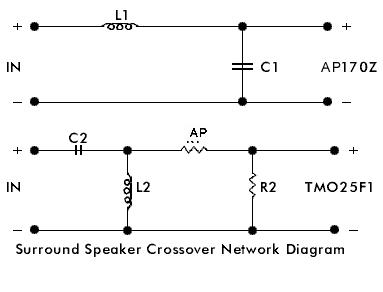

dooper said:These are the XO diagrams for the Audax surround cabs. Anyone know what the AP component is?
dooper

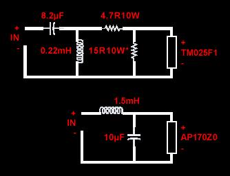

AP should be some kind of resistor as its symbol indicates, just like R2. Or am I wrong? (I don't know about the three wee little dots above the symbol.)
BTW does anyone know the values of the caps, resistors, etc. used in this X-over design?
coolkhoa said:AP should be some kind of resistor as its symbol indicates, just like R2. Or am I wrong? (I don't know about the three wee little dots above the symbol.)
It's all on the site that I linked above, but here you go:
L1 = 1.5mH, 0.4 ohms, #16AWG air core
L2 = 0.22mH, 0.2 ohms, #18AWG
C1 = 11mfd (10mfd & 1 mfd in parallel)
C2 = 8mfd
R1 = 5 ohms, 10 watts
R2 = 15 ohms, 10 watts
Anybody (Matt I bet you do!) know what that AP thing is about?
dooper

No, as I said, I'm looking for more complete info than this. One problem with a ubiquitous kit like this is various vendors' variations. If you look at Madisound's stuff, it doesn't match DESIGN3D's stuff, etc.
The AP... is indeed a resistor. As for complete info, the original J.D'A. crossover can be found at the www.e44.com site, and the original J.D'A. cabinet dwg at the DESIGN3D link you gave.
