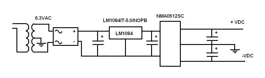

I believe this is the solution you are looking for.
The LM1084 is a suggestion...use a low dropout regulator because you do not have too much headroom from a 6.3V supply.
I have used this for automotive where the supply is not within 10.8-13.2V so an NMA1212SC was not an option. A LM7805 type was used in that case...had the headroom.
Some DC-DC converters require a minimum load. I believe this one does.
Put in a resistor/LED as a minimum load. This also tells you the supply is on.
If you want +/-15V use a NMA0515SC. NMA0515SC Murata Power Solutions Inc. | Power Supplies - Board Mount | DigiKey
Have fun.

DUG, thanks for contributing. In your schematic you are providing the 5vDC input with what would actually be +/-2.5vDC because of the grounded center-tap. Is that actually an option? I hadn't considered that. I guess because the converter is isolated it doesn't care if the input is 0V/5V, -2.5V/2.4V, or 5V/10V - essentially just the potential between the pins matters, within reason?
Thanks!
Thanks!
yes
