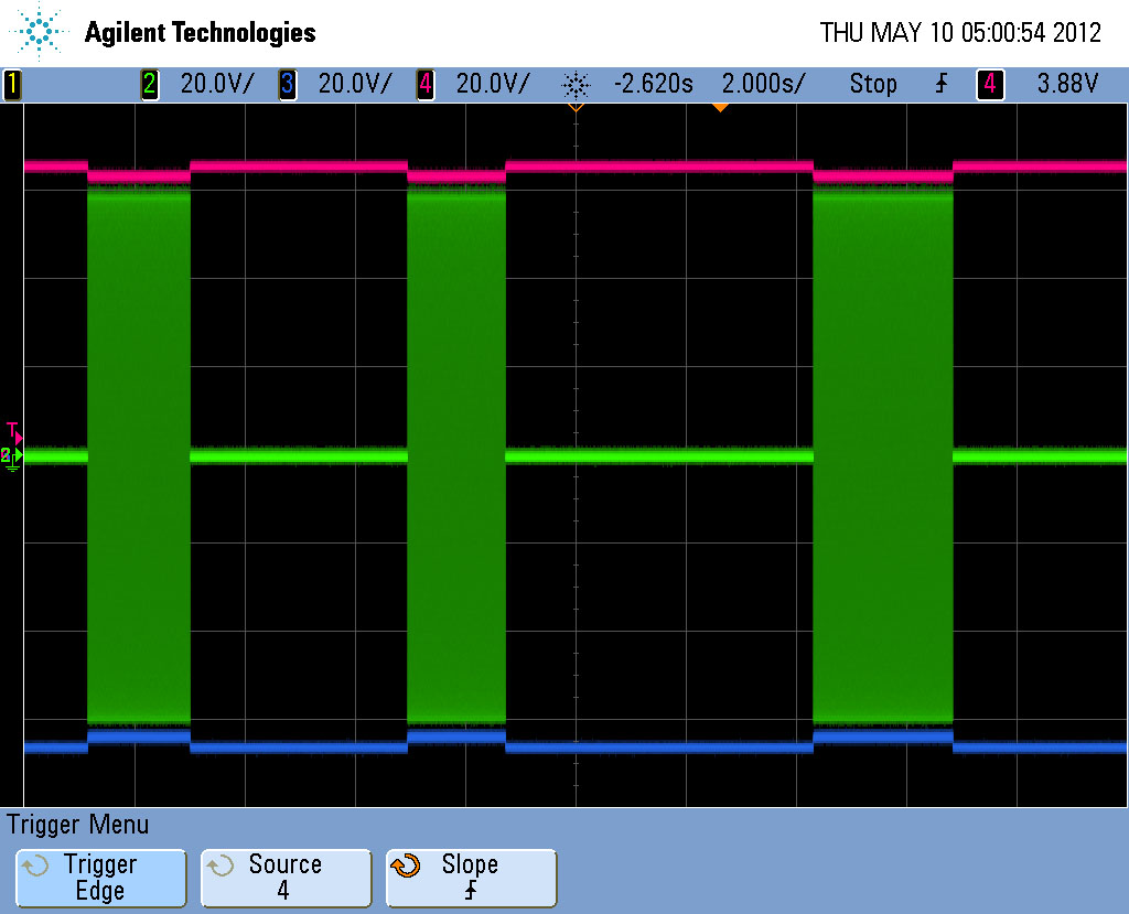

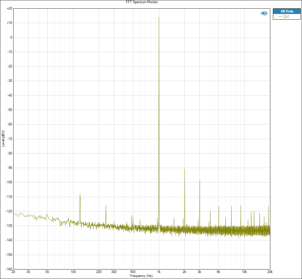

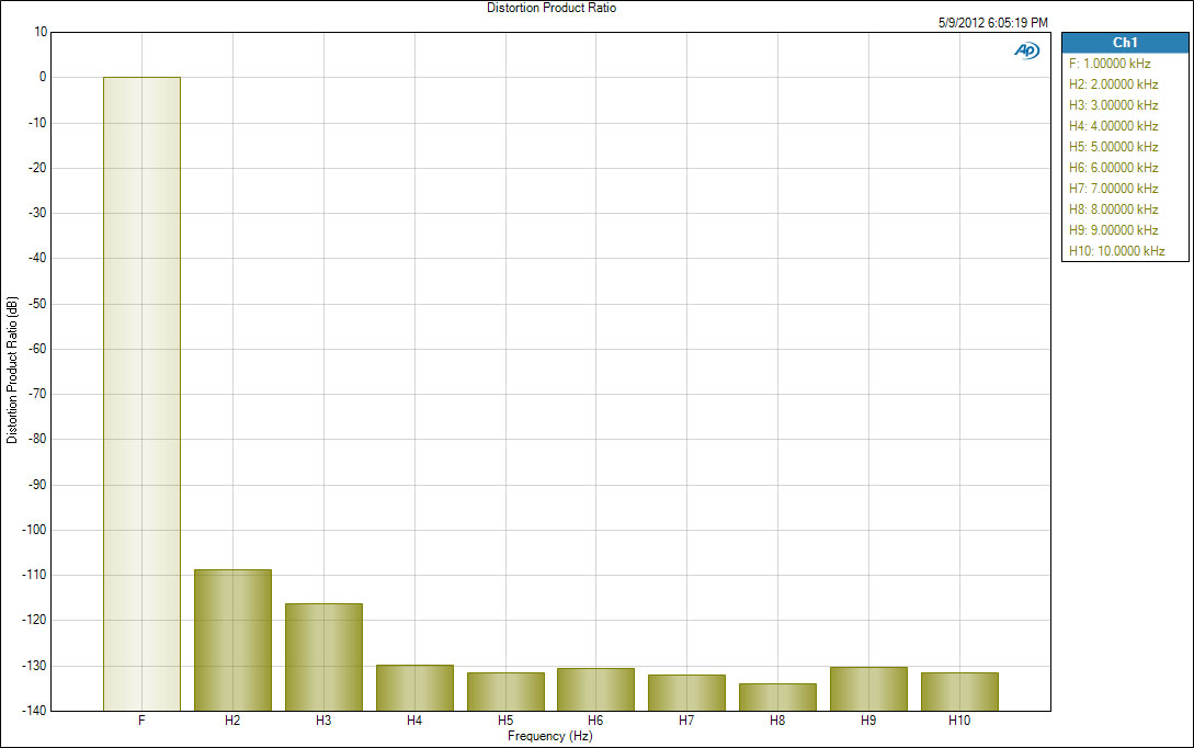

A few notes on spread spectrum SMPS's, done some funky systems usings these also involing multiphase. Instead of say one 50A SMPS use 5x10A multipahse SMPS with spread spectrum. Instead of noise at one set of frequenies at a high level, you get a broad spectrum of low level noise. The other advantage is power management, SMPS supplies work best in a sweet spot, near there full power output, when you have low current requirements they go into burst mode, noise increases and also drops in frequency content often to levels that will be audible. With multiphase and power management you can switch of banks or seperate supplies to match the capacity to the required output. Again filtering careful layout and good design, SMPS's can be amazingly quiet.
On linear supplies, for main power they are not as good as some may think, I have seen problems with functional and EMC testing where a linear supply let through audible noise during conducted susceptability test, where a SMPS would have filtered it out. Now I know you are going to say filtering should have stopped it, but these wrer high level tests and the thing had some crazy filtering. The problem was actually the linear supply in conjuction with trying a single point 0V to shielding topography! a more intelligent shielding and 0V scheme solved most of the problems, adding an SMPS put all the noise way above both the audio range and the bandwith of the audio circuitry, plus ground and power planes for low level signals and a proper decoupling scheme and power distribution and seperation limited the rest of the noise.
