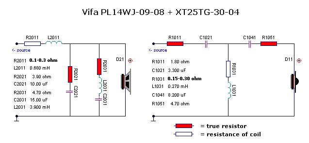

I do think the 11L Troels Gravesen Paper PL14WJ design is a good modern contender:
Vifa PL14WJ-
It's quite easy to build in the UK, since Wilmslow Audio have a cabinet and crossover PCB that is just PERFECT for 149mm bass and 104mm treble:

Troels' selection is probably better since the Vifa PL14WJ is a vented bass, which is a good feature IMO. But Vifa and Scanspeak drivers both available at Falcon Acoustics.

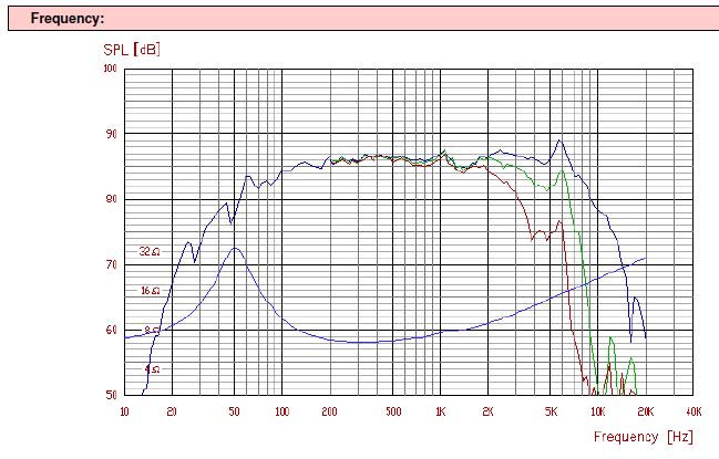

IMO, the sliced paper Scanspeak 15W-8530-K00 is a bit overpriced. Why slice a cone, then repair it with glue? A 6kHz peak on the cheaper units is not hard to fix with a notch filter if you want to get fussy. Try 10uF, 0.1mH and 1.5R, and give the treble filter 4uF at the input. 🙂
