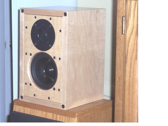

Hello, brand new here so please bare with me.
I have searched for this information on the The Unofficial LS3/5a Support Site.
Are there any new drivers being produced that have close specs to the currently out of production KEF B110 and T27?
If I was to buy a kit would I be able to use drop in replacements? Hard to believe some other manufacturer has not cloned these.

Jeff Bagby of PCD fame, designed the Continuum. The kit is available from Meniscus.
Continuum, Pr
Continuum, Pr
The BBC LS3/5A was carefully equalised in the crossover for what is, by modern standards, a quirky heavy 5" KEF bextrene unit and a mylar domed T27 tweeter. I'd say the art has moved on a lot. 🙂
Tweeters like the Vifa XT19TD00-04 soft dome are just SO much better. You have a huge choice of 5" units these days too. Kevlar or paper might be nice. Naturally cabinet size is dictated by woofer characteristics, but if you then apply baffle step correction and tweeter impedance equalisation, you should get something very BBC, as discussed here:

Very nice. Exactly what I'm looking for. Do you know of any other pictures of that one. I could not find any specific threads.

I've not seen that Continuum kit before, TBH it looks quite good.
The fat bass is replicated, the rest of it looks good to me.

If you liked the sound of the LS3/5A my guess would be that the Zaph Audio design would be more of a modern take on that than the MFonken (Which is based on a full range light weight driver). Zaph's designs are very well researched and it is well worth looking through his website to see his thought on speaker design.
But if you really liked the very controlled sound of the LS3/5A the kit from Sterling is probably the closest you will get with easily available parts.
