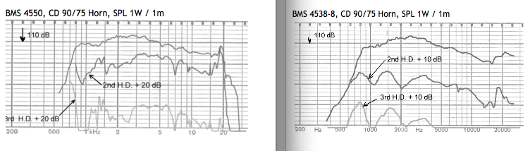

Looking at the published distortion of the BMS4538, it has more distortion around 900 Hz, but less above than the 4550.So, I'm looking through the local retailers lists and the BMS4538 looks affordable and sweet but I'm aiming for a low crossover and all the sweeteness in the world won't make a difference if the driver isn't up to the task.
900Hz with a Seos-15 waveguide.
I did extensive testing of the BMS 4550 and 4552, and you can listen to the results, and perhaps interpolate the difference you see in the graphs between them and the 4538.
Those two BMS drivers sounded quite similar, I would not expect the 4538 to sound much different.
If you like to listen loud, but are sensitive to distortion, I'd suggest no less than a 12 dB electrical crossover for these drivers at 900 Hz.

Whatever horn the B&C DE250 uses, the LF response looks to be similar to the BMS4550 on a CD90/75 horn, they both fall off at around 30 dB per octave below 800 Hz.

The basic differences between BMS and B&C are that B&C will have a flatter frequency response, and BMS will have much better transient response.
Regarding transients. Art says that the 4550 and 4552 sound very similar to him. Indeed they have very similar frequency and distortion response. (Down to 1K, the 4552 throat opens up much faster and has higher distortion below 1K.) But to me the 4552 has better transient response, (see its higher flux density), and with the neo magnet has a more stable flux density. To me is sounds more precise.
In the 4550 vs. 4538, the 4550 has a higher flux density. I think that will translate into better sound quality in the mids. Again, better transient response. The 4538 has a smaller Voice Coil, VC, and will have better resolution on the high end, and go higher.

Depending on the horn, 1200 Hz would be no problem, assuming 118 dB at 1 meter with 10 watts is adequate for your desires.Old thread this but:
That driver looks to need about 9 db of midrange padding to get a semi-flat response so maybe 109 db/w/m at 10 watts - look at that HF distortion though and the top octave response

Midrange reduction won't change the low output potential which is limited by excursion, not power. The level in the 1200 Hz range is 117 dB,(read the 2 dB graph increments wrong) the level above is more. I don't get what your 109 dB reference is.That driver looks to need about 9 db of midrange padding to get a semi-flat response so maybe 109 db/w/m at 10 watts - look at that HF distortion though and the top octave response![]()
