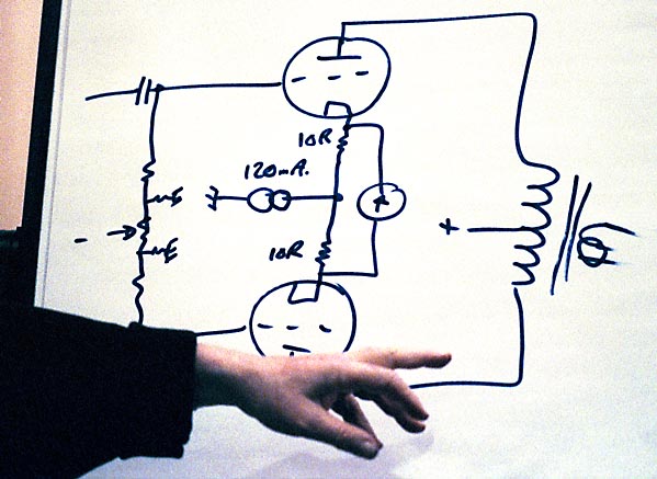

Comments from people are very favourable about this design, maybe I am missing something.
DPA uses combination of CSS and fixed bias to get the symmetry right.
Then, in the picture, Allen was drawing his powerstage after all.
Fixed bias combined with CCS.
Correct.

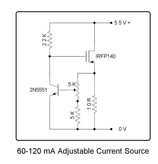

This is the CCS circuit that I implemented in my PP amp which provides 120mA for two EL34 tubes. The IRFP140 can stand very high voltage and current. I had it mounted to the chassis as heat sink. The PP amp was with Williamson's design. I had the common cathode resistor replaced with this CCS circuit. The sonic improvement is amazing and I like it so much.
Thanks for that. The only issue I can see is that a pair of 300Bs would likely draw more than 120mA (my 300B push-pull amp has 80mA per output valve). What changes would you make to increase the current capacity?View attachment 1106426
Did you have to add an extra negative supply when you added this?

Kmtang, that looks like a good CCS circuit, but it will only work in Class A mode. If your PP amp is class AB, as are most, the 120mA limit will prevent the active tube from drawing any more current when the other tube reaches cut-off.View attachment 1106426
A big cap from the cathodes to ground (across this CCS) will allow the “on” tube to draw more than 120mA, allowing full power beyond the small class A region.
See my posts #16 and #19 in this thread.
