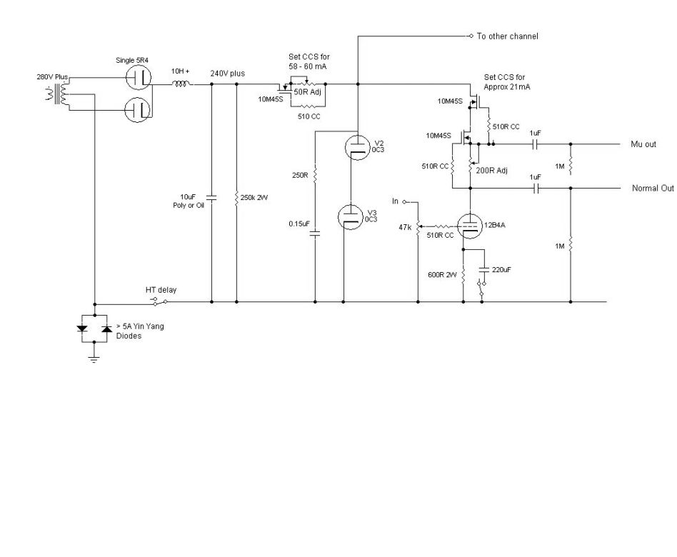

mach1 said:Snoopyma,
I have attached a schematic of my 12B4 linestage. I think it may answer some of your questions.
Hi Mach1,
THANKS! WOW! I like you circuit very much. I observed something particular as below which make a difference from others. This is more or less the topology that I am chasing for.
1. choke input p.s.
2. yin-yang diodes at the centre tap of the h.v. transformer to ground: what's the purpose? Will it better to use IXYS low noise Schotty diodes here?
3. ccs p.s. before the 2 vr tubes
4. the .15uf and 250R in series with the 2 vr tubes: used to correct the impedance? How to calculate their values? Need to put a resistor in parallel with the lower one to light it up first?
5. 510R cc at the gate of 10M45s: to prevent oscillation?
6. use of cc resistors: I like them too (no inductance) where precision is not needed
7. 2 cascoded 10M45s as the plate load of 12B4a: what's the approximate voltage drop here? How to calculate the value of the resistor need to set the cascoded ccs running at the desired current? Is the cascoded 10M45s much better than the single one technically and sonically?
8. optional output taken at the cathode of lower 10M45s: what's the advantage? Lower output impedance? How it is sounding compared with the normal output?
9. optional switch at the bypass of 12B4a cathode resistor
Sorry for the so many questions. Some may be stupid as I am not familar with the s.s. ones. Please feel free to correct me if I am wrong.
Thanks in advance!

Snoopyma,
1. Yes, a choke input definitely sounds better in this linestage, even though there are two stage of current regulation and one voltage regulation afterwards. You only need a small cap after the choke, so use good quality here.
2. the yin/yang diodes are to provide a degree of isolation between the circuit ground and the mains earth (an earth lift) to prevent AC garbage on the mains earth affecting the sound. They should be at least 600V, and high amperage. Just use regular diodes here - there are no advantages using anything exotic or expensive. Resistors (approx 10R) are commonly used for this purpose, but I prefer the diodes.
4. Yes the 0.15uF/250R are used to flatten the impedance curve of the VR tubes. The VR tubes light up fine without a parallel resistor.
5 &6. Yes the carbon comps are used to prevent oscillation. The values are what I had to hand - anything from 470R - 1.2k should work fine They also sound very nice as cathode resistors for the 12B4 (I use 2 x 1200R 1W in parallel). Varnish or epoxy coat them to provide long term stability in a humid environment like HK.
7. In my opinion the cascode sounds better, although you will find a post on the 10M45 thread that disagrees. The difference is not huge; I suggest you try both and decide for yourself. You have to adjust the trimpots shown on the schematic to set the required currents - all 10M45 are slightly different, so I can't give you precise figures. From memory, a good starting point is 8 - 10 R for the first ccs, and 100R for the second ones. To set the first one solder in a 100R resistor before the ccs and measure the voltage drop while adjusting until it reaches 5.8 - 6V. When setting the second measure the voltage drop across the cathode resistor until it reaches 12 - 12.5 V. You must use a single 10M45 for the first ccs as a cascode arrangement will not pass enough current.
8. Yes the output taken from the 10M45 cathode provides a lower output impedance at the expense of reduced power supply isolation. It can provide a punchier sound, but may sound too agressive in some setups. Try both.
9. I put the switch on the bypass cap to determine its effect. On balance I prefer the sound without, but haven't bothered to disconnect it as I may experiment with better caps (BG perhaps) later on. Use high quality here - cerafine/ silmic at minimum.
Generally, I prefer the sound of good 5R4 and 5Y3 and GE 12B4s in this circuit.
have fun !

Hi mach1,
Thanks really for your informative reply. I will definitely try the cascoded 10M45s. But what's the maximum current that they can supply?
One more question: how to calculate the values of capacitor/resistor which is used to flatten the impedance of the series vr tubes?
