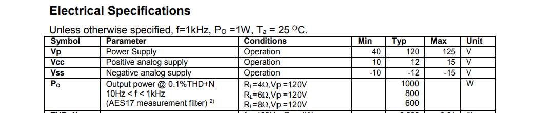

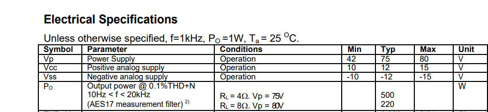

The other option I was considering is the IcePower 500A, but it needs an additional supply of +/-15Vdc. I could probably toss that together from parts I have around. For the added complexity its about the same price as the Hypex UCD400HG but I can get the IcePower 500A locally.
I beleive the ICEPower 500A unit needs 0-75vdc, single rail, not dual rail... in addition to the +/-12vdc.
You can probably get away with just the single 0-65vdc connection (min is 0-42vdc) to the 500A on your linear power supply, but wont get anywhere near the output power...
You could maybe get away with the ICEPower 1000A tho (it only goes to 3khz anyway - perfect for subwoofer duty)... max is 0-125vdc, and you would be at 0-126vdc with your 63-0-63.... but you only have 300VA....
@Nisbeth Agree, but with his 300va 45-0-45 tranny, the 500A could only be run at 0-65vdc, while the 1000A could be run at 0-126vdc, correct?
Whoops, hold on, I see your point, but are the following statement both correct as the OPs tranny only has 300VA (and limiting factor)?
there is no difference in output power between the ICE500A and ICE1000A if you run them on the same supply voltage.
there is no difference in output power between the ICE500A and ICE1000A if you run them on the same supply.
@Nisbeth
Yes, IMO they are both correct.
A 300VA transformer should not be the limiting factor with a 500W amp that is only used for music, especially if it is a linear supply without a hard current limit. 126VDC would be very high for a 1000A because there is no additional margin for line voltage fluctuations etc. so that sounds unsafe for me.
The old eval-kits for the ICEpower A-series used a 400VA transfomer for the 500A kit. However, that rating included the low-voltage supply (app. 20-30VA) and the same transformer was used for both the mono and stereo kits.
The 1000A eval. kit used a 550VA transformer for the mono board, again low-voltage supply included.
