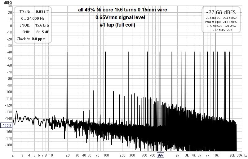

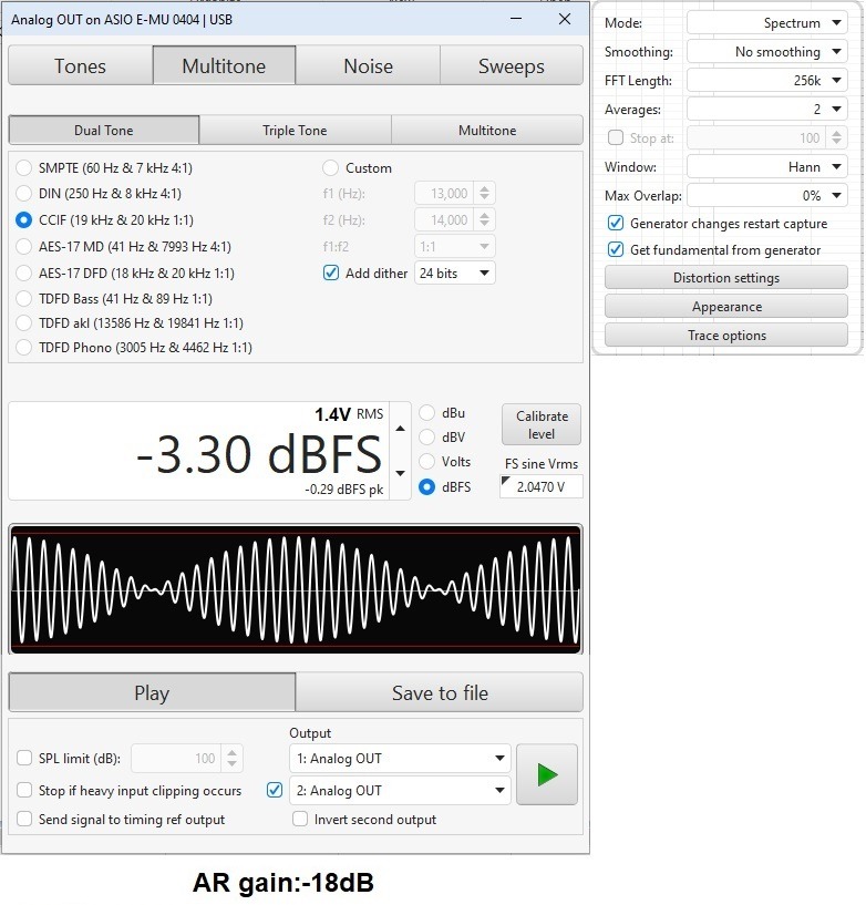

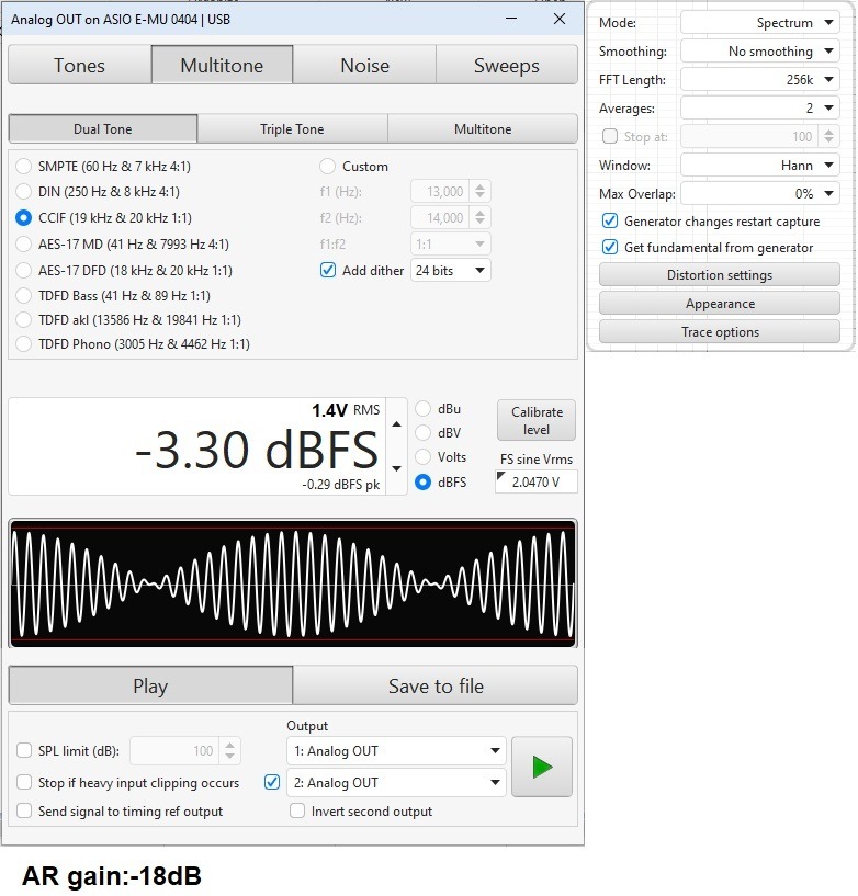

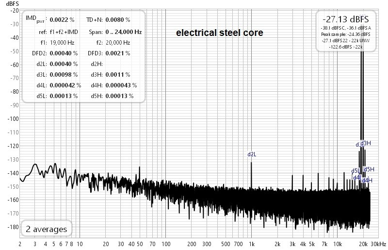

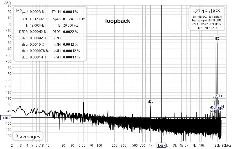

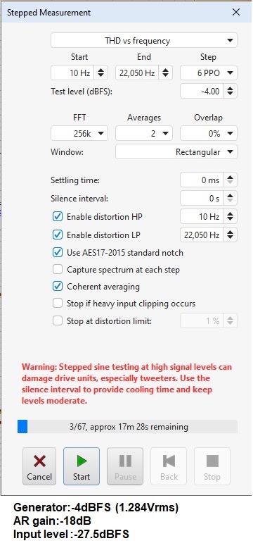

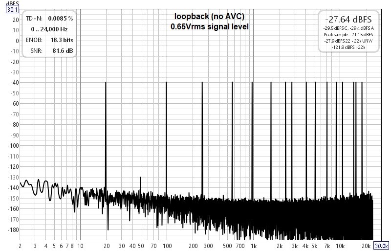

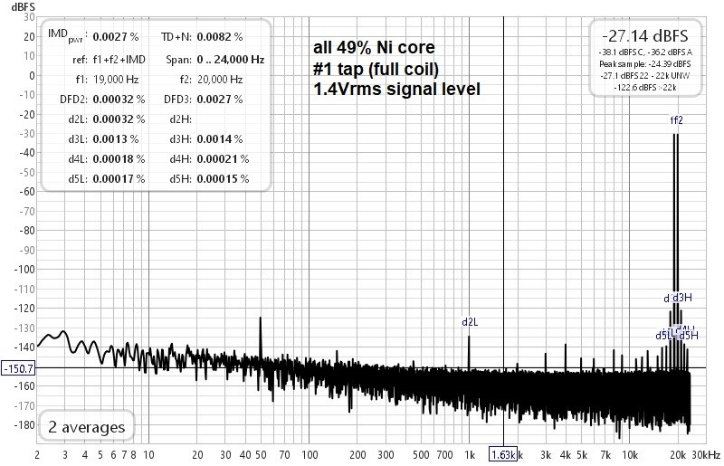

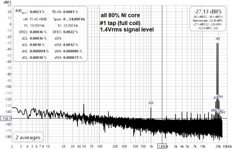

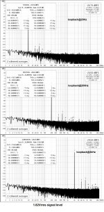

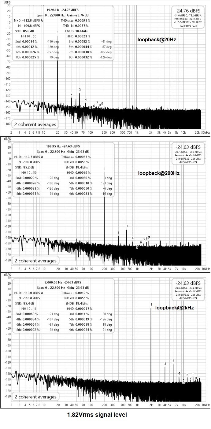

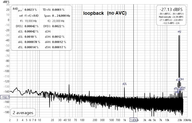

Dual tone (19kHz&20kHz) distortion tests

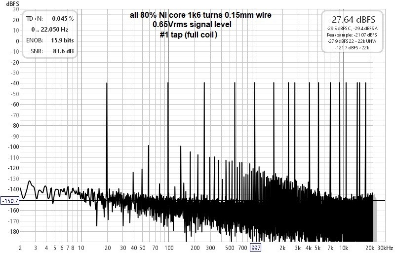

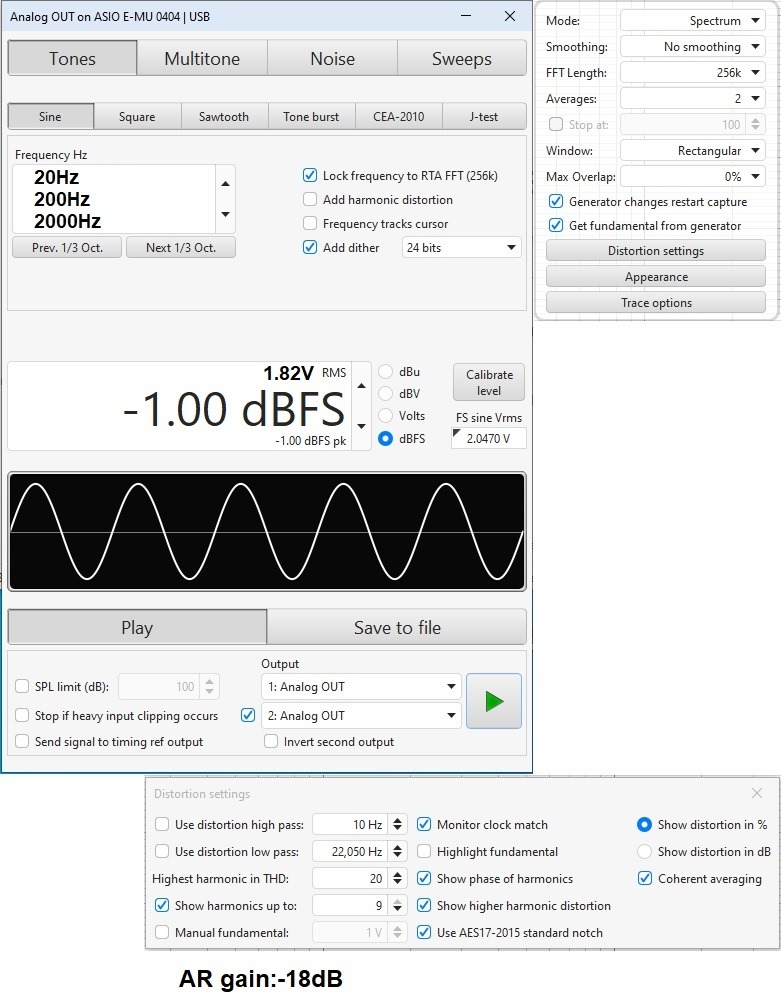

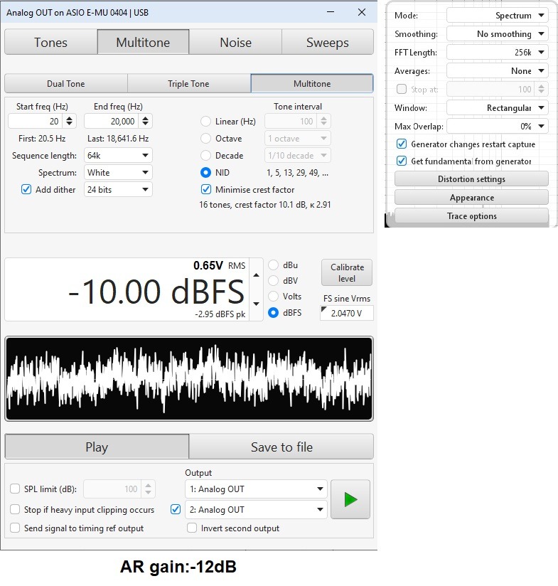

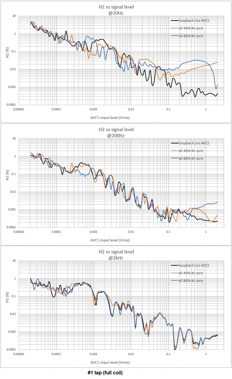

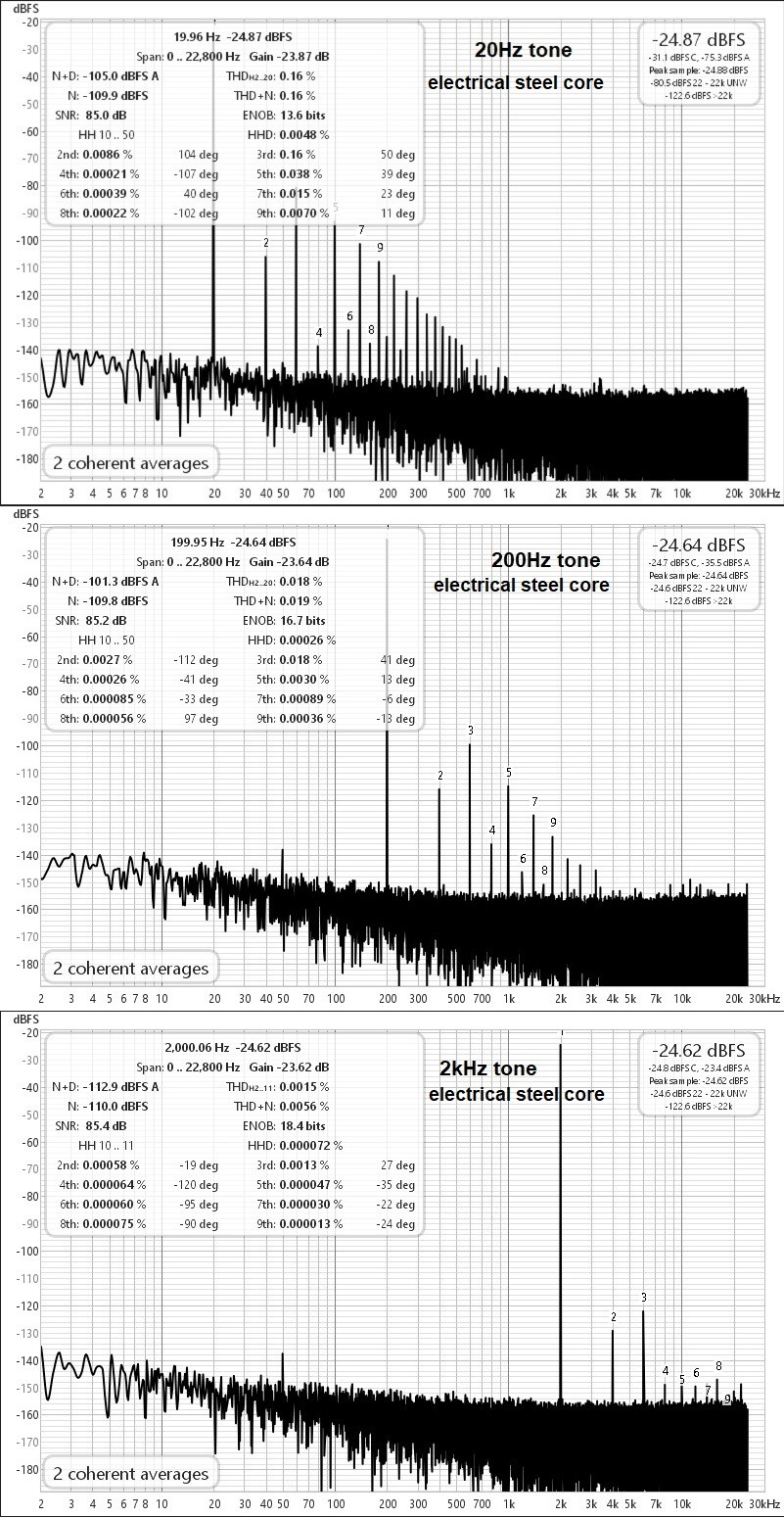

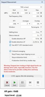

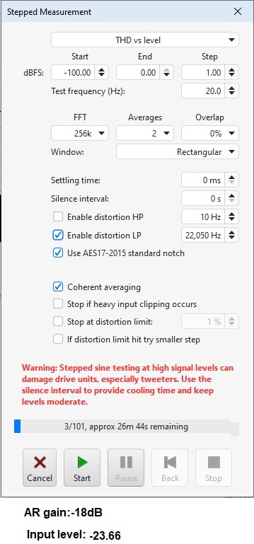

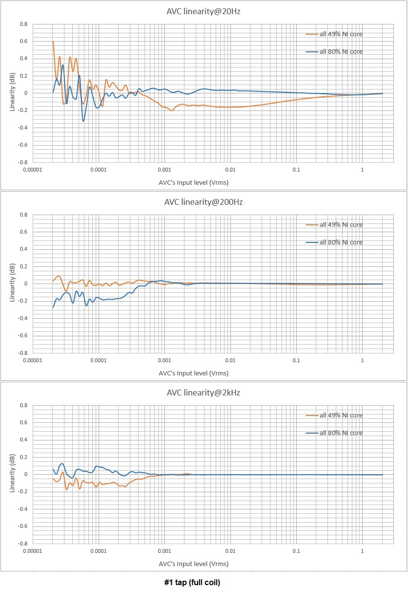

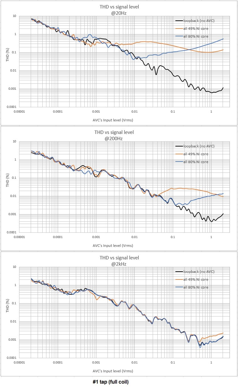

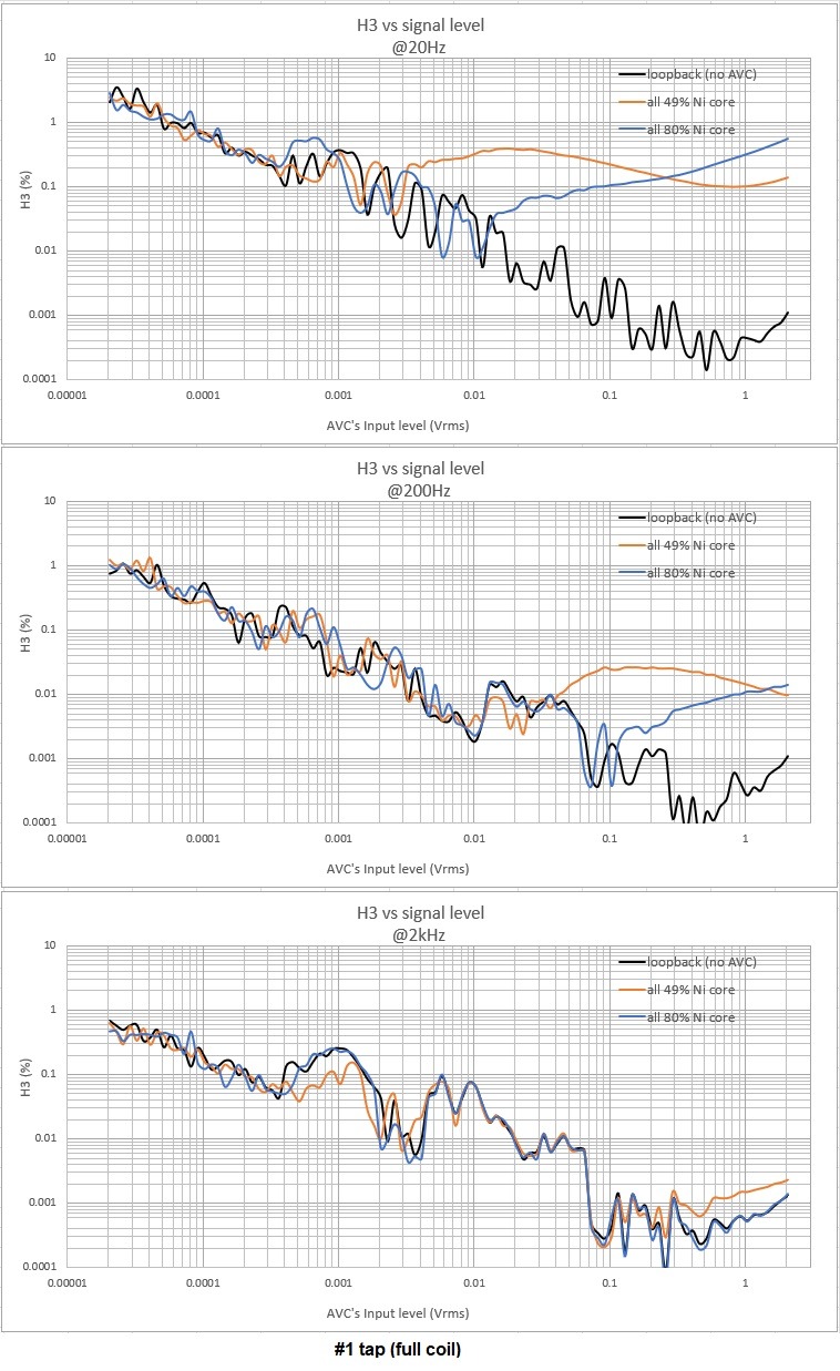

Step measurements 2.
Distortion (and linearity) vs signal level

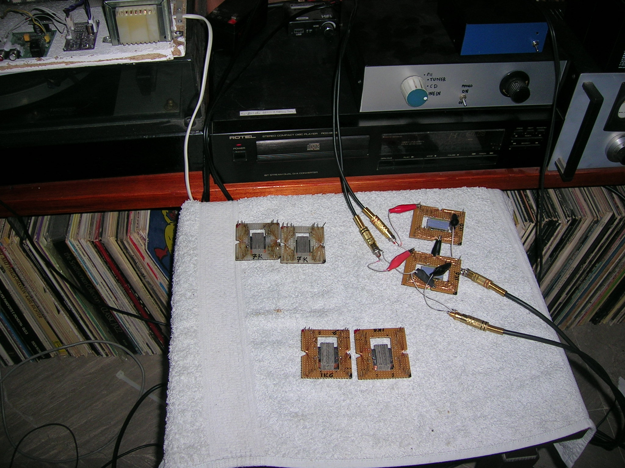

Some days ago, a long time friend came here and we had a comparative listening session.
One AVC pair 7k turns/0.07mm wire over 49% Ni core.
One AVC pair 1k6 turns/0.15mm wire over 49% Ni core.
One AVC pair 1k6 turns/0.15mm wire over 80% Ni core.
An Alps blue 10kOhm potentiometer.
Any of them btn a CD player and a power amplifier to speakers.
Three levels of attenuation. 0dB, 12dB, 29dB.
We were keeping notes and at the end of each section we were discussing our opinion.
One test musical piece. 1st track (Chan Chan) from RY Cooder/ Buena Vista Social Club CD
The consensus was that the 1k6 turns/0.15mm wire over 80% Ni core was a bit ahead of the rest.
Better analysis and instrument definition.
Better control on bass.
His ranking was
1st_1k6 turns/0.15mm wire over 80% Ni core
2nd_7k turns/0.07mm wire over 49% Ni core
3rd_1k6 turns/0.15mm wire over 49% Ni core
4th_Alps blue 10kOhm potentiometer
My ranking was
2nd_1k6 turns/0.15mm wire over 49% Ni core
3rd_7k turns/0.07mm wire over 49% Ni core

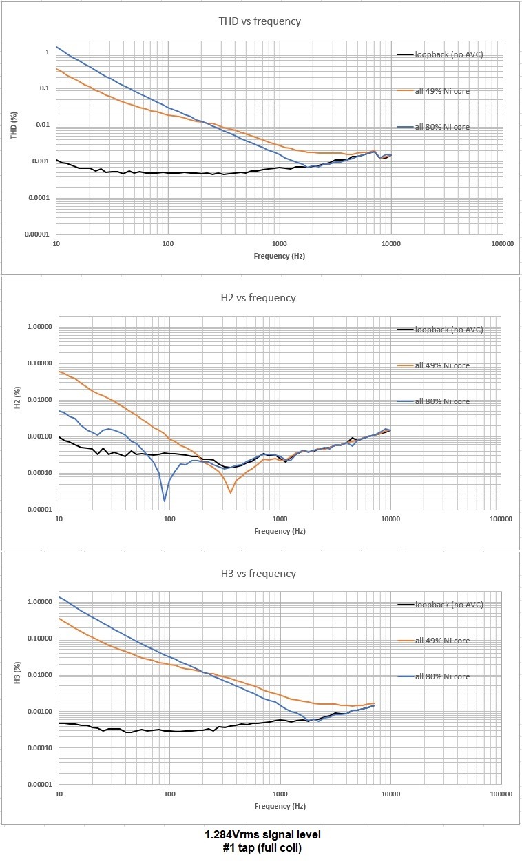

After ending the listening through the speakers and having the discussion, I told him about the measurements I had done.
He said OK and he started to test them, this time CD player-DUT (at 12db attenuation)-headphone amplifier- headphones . He said his opinion hasn't changed.
I did the through headphone testing after he left.

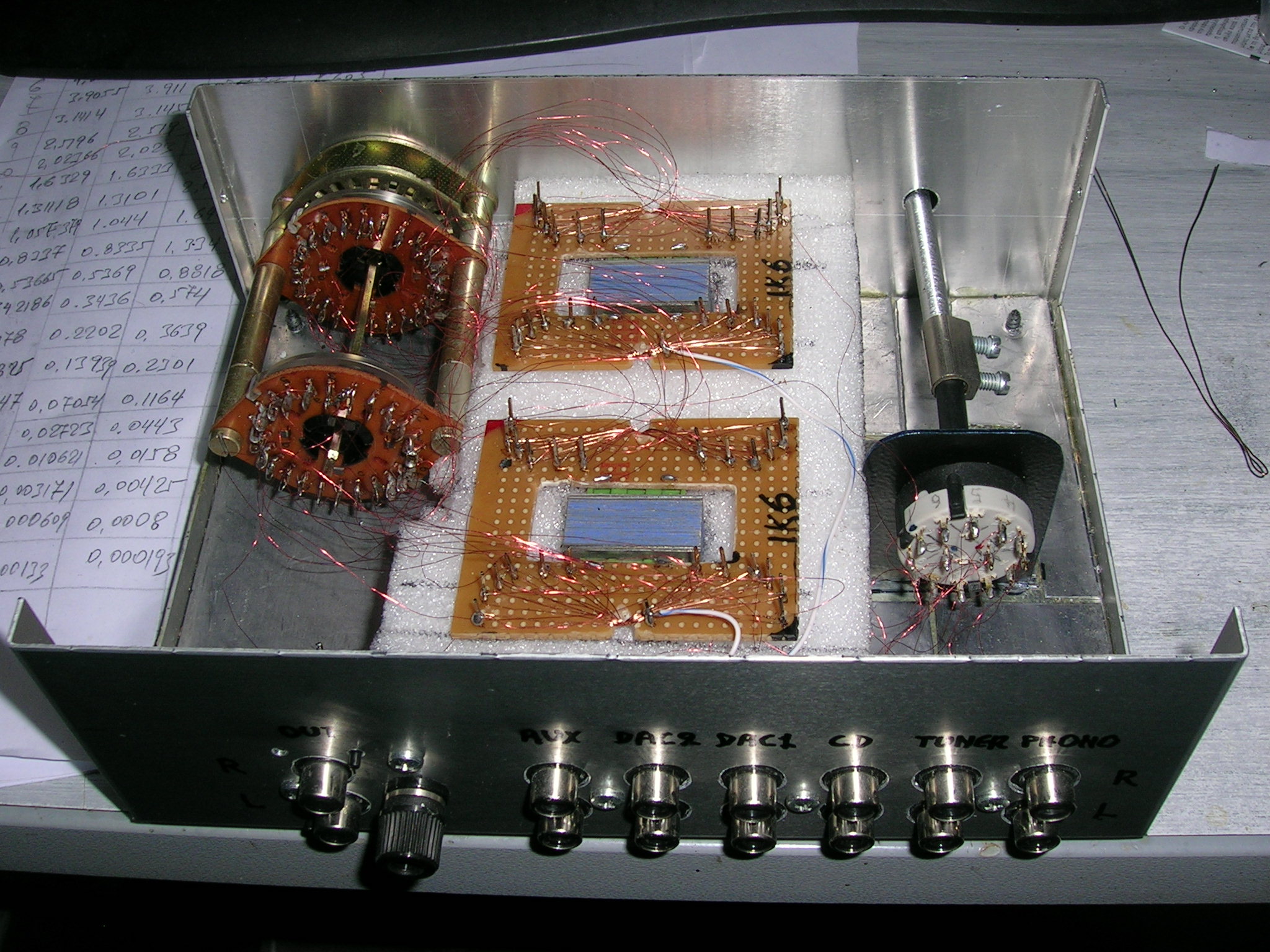

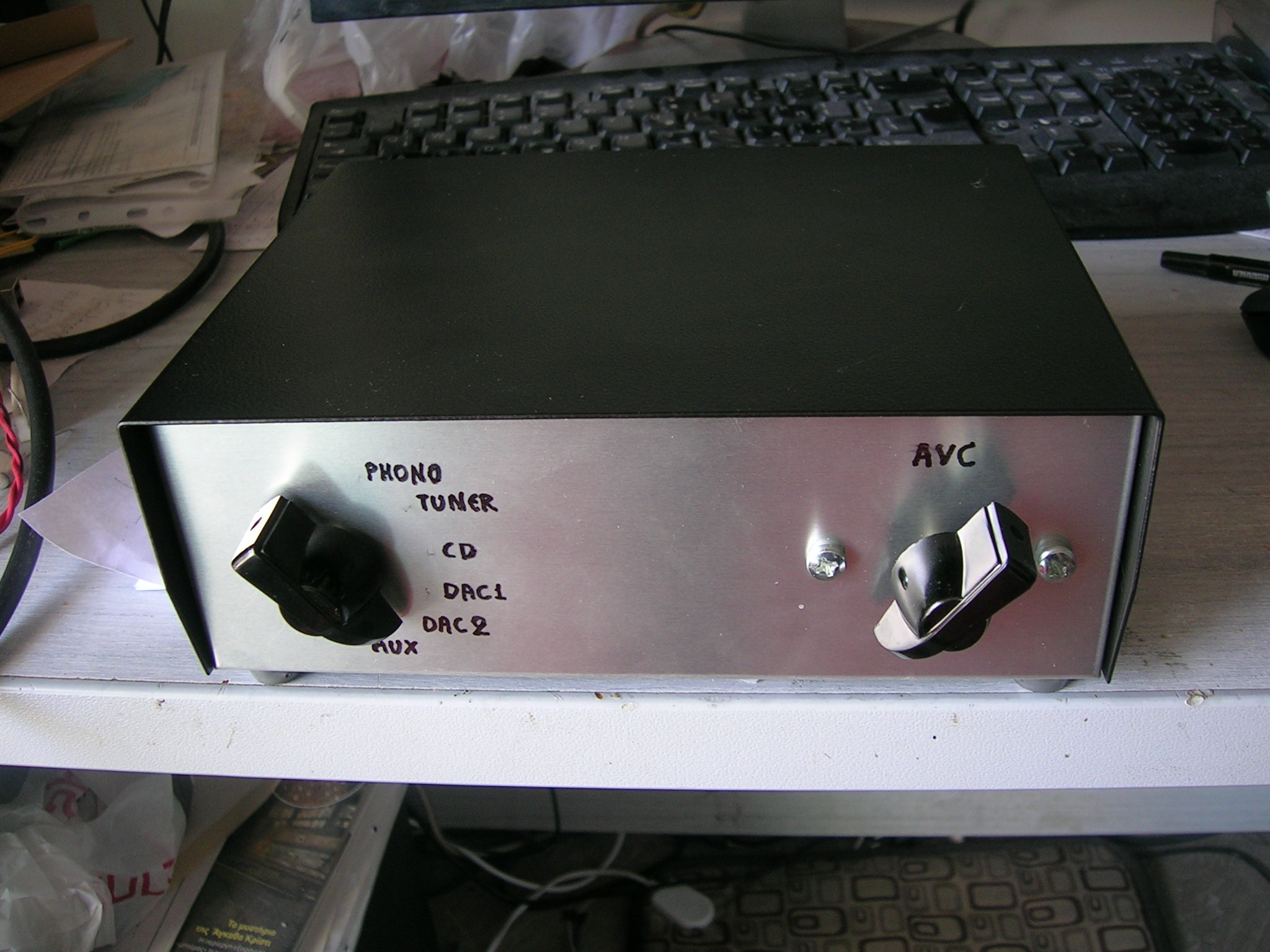

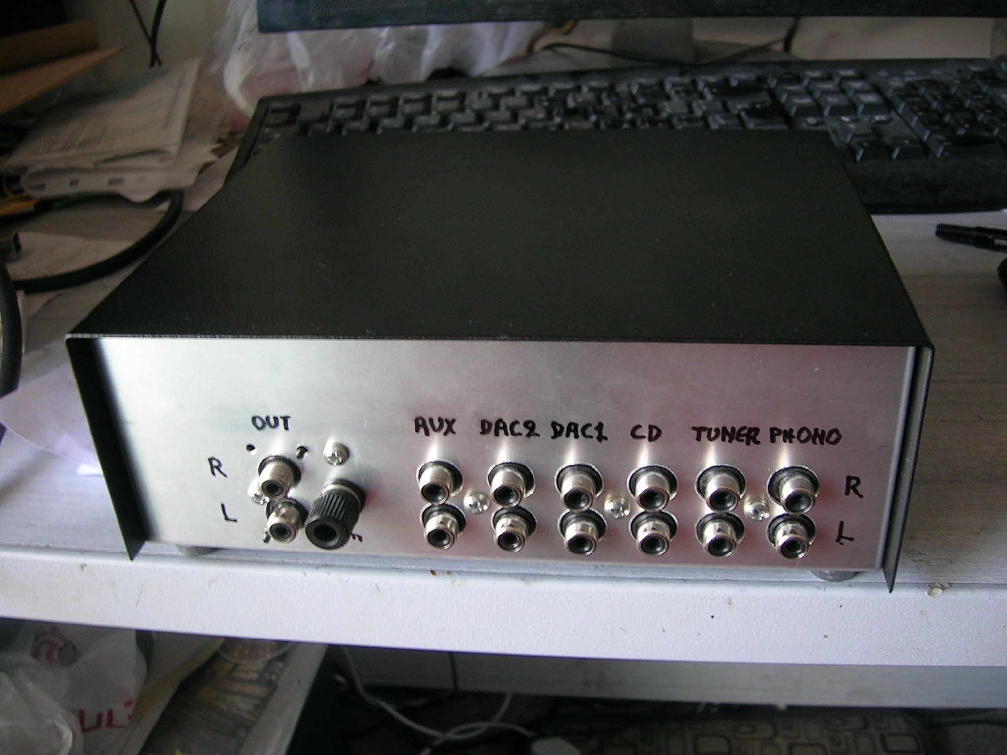

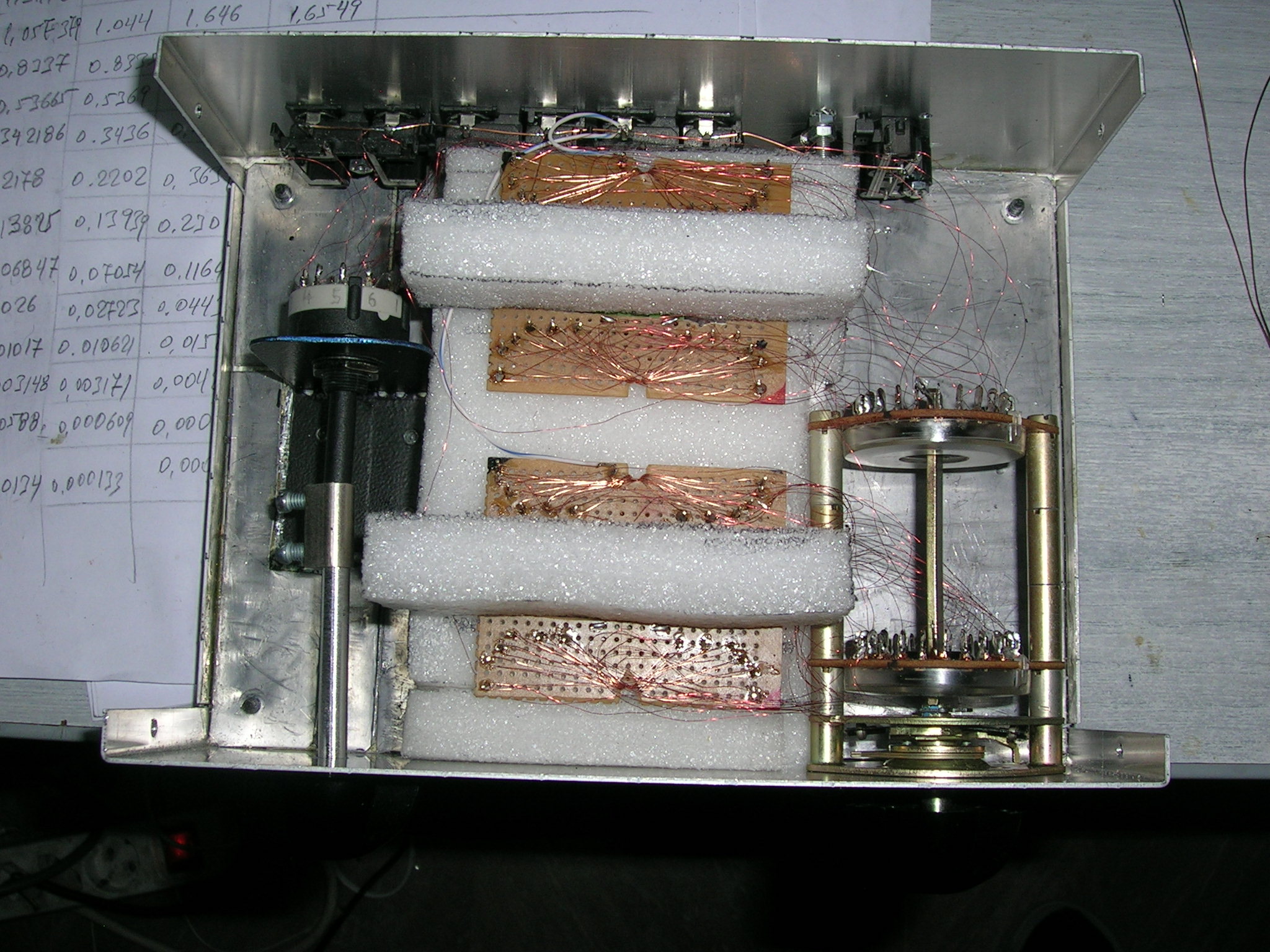

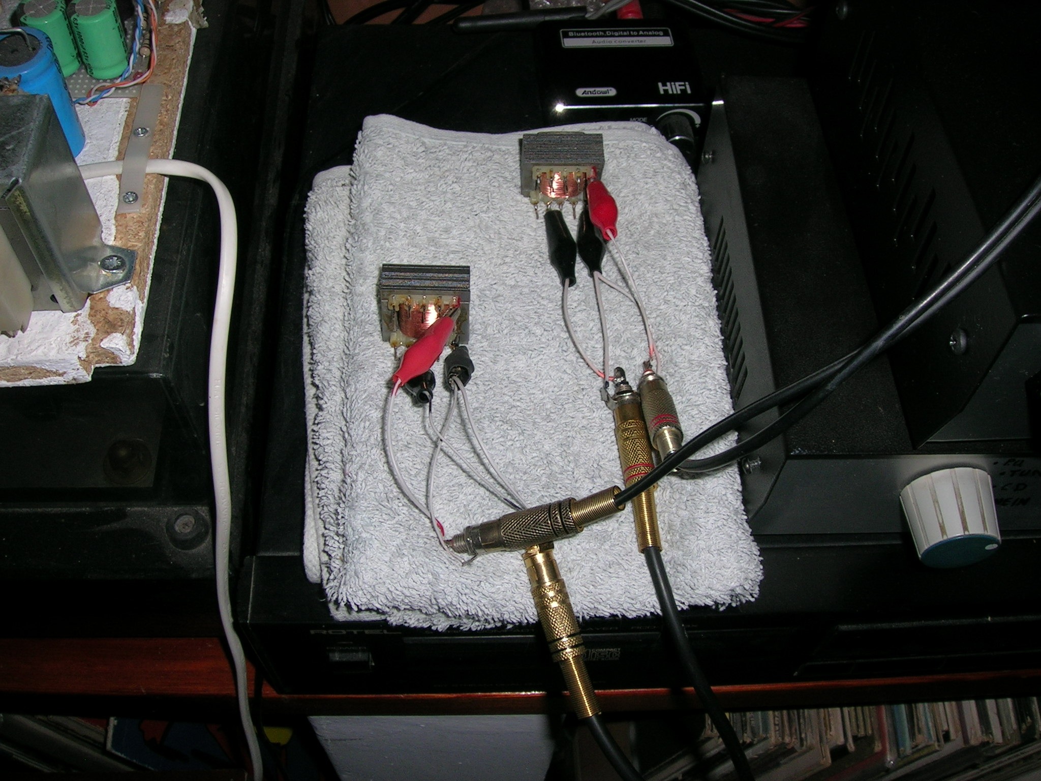

Two days after the above listening session, I assembled the 1k6 turns/0.15mm wire over 80% Ni core winning pair into an enclosure.
Yesterday I met Magic Bus and gave it to him for beta testing 🙂
George

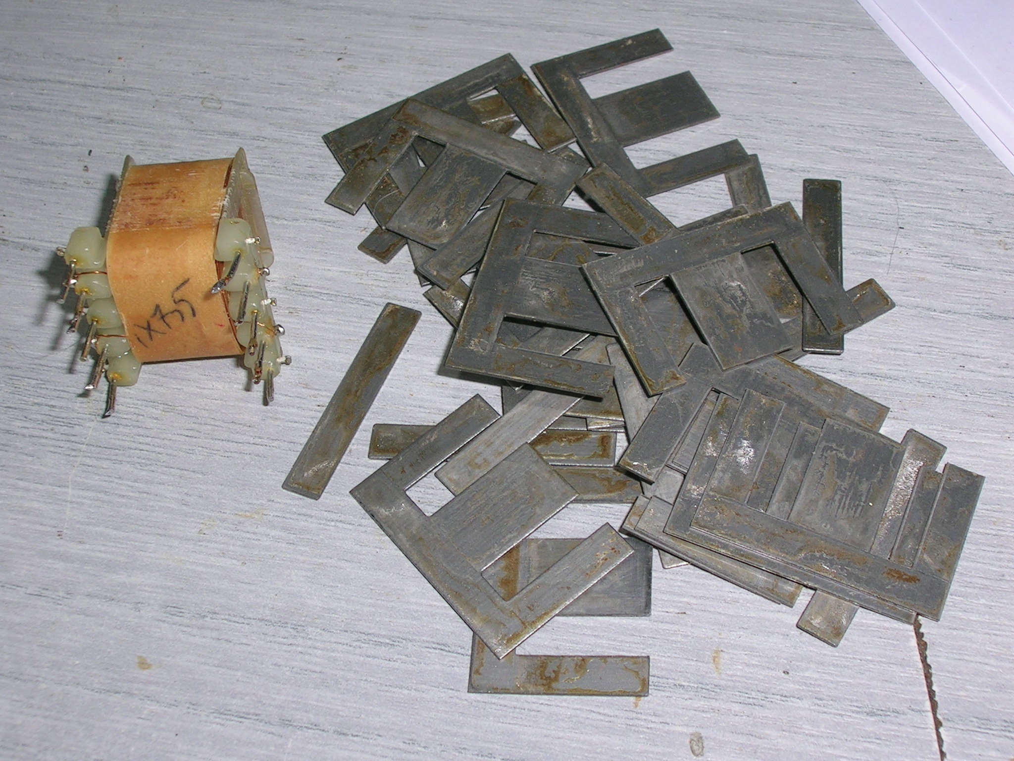

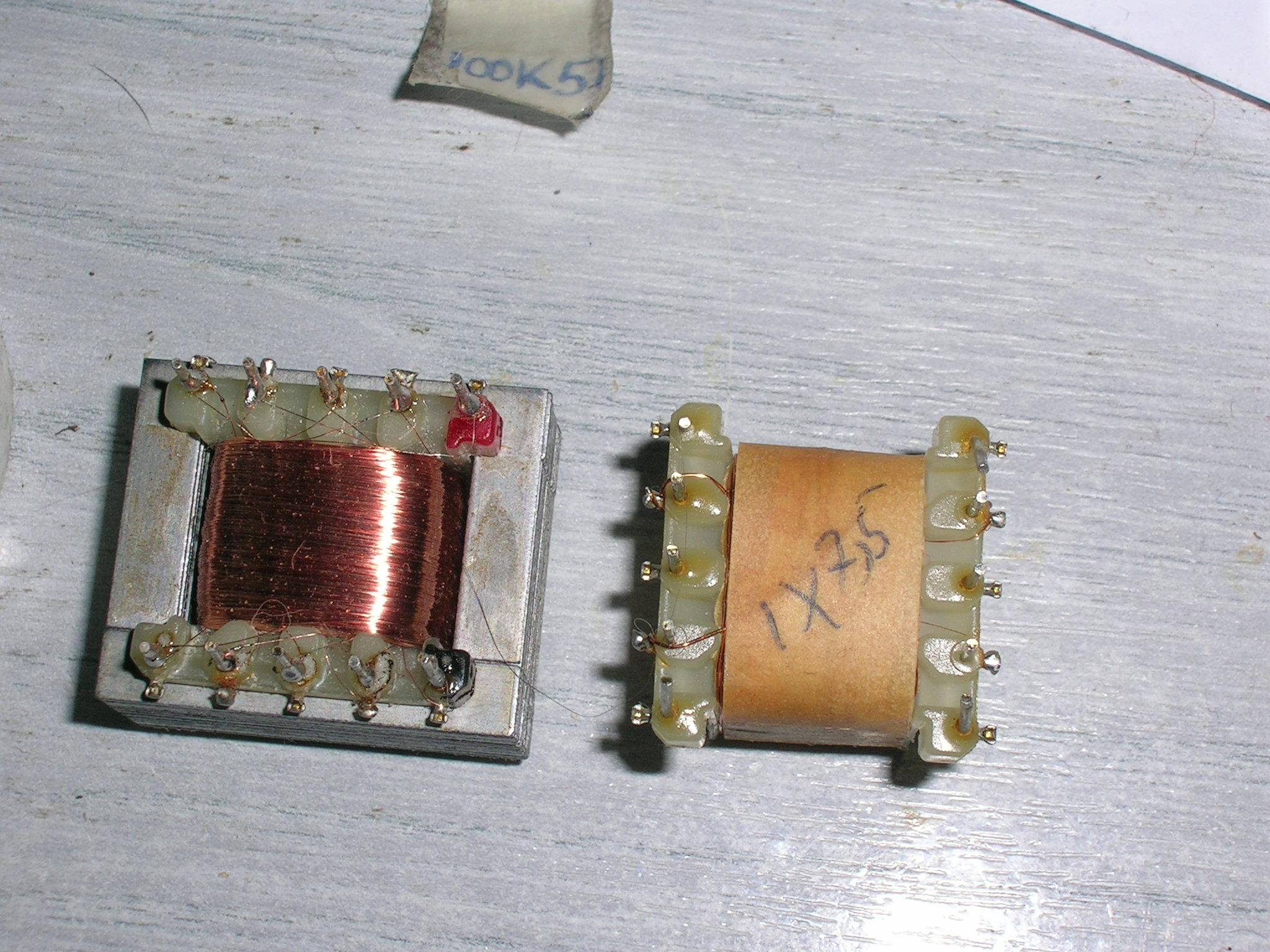

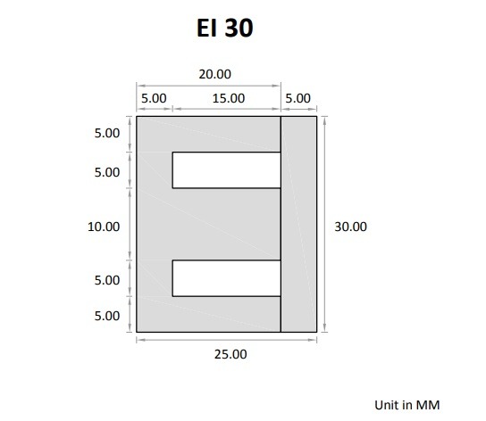

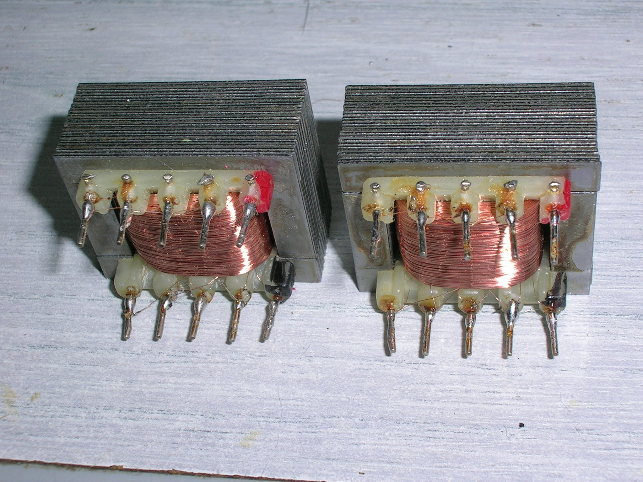

In the mean time I thought to do something useful. To build a poor man’s AVC
At the junk area of my shop I found two very small EI-30 power transformers.
0.5mm thick electric steel laminates (ASTM M-27?) Core dimensions: 10mmX12.5mm (~1W power)
I dismantled them, removed the existing windings and wound 6k turns of 0.07mm wire.
Nine coil sections through existing 10 bobbin taps.
George

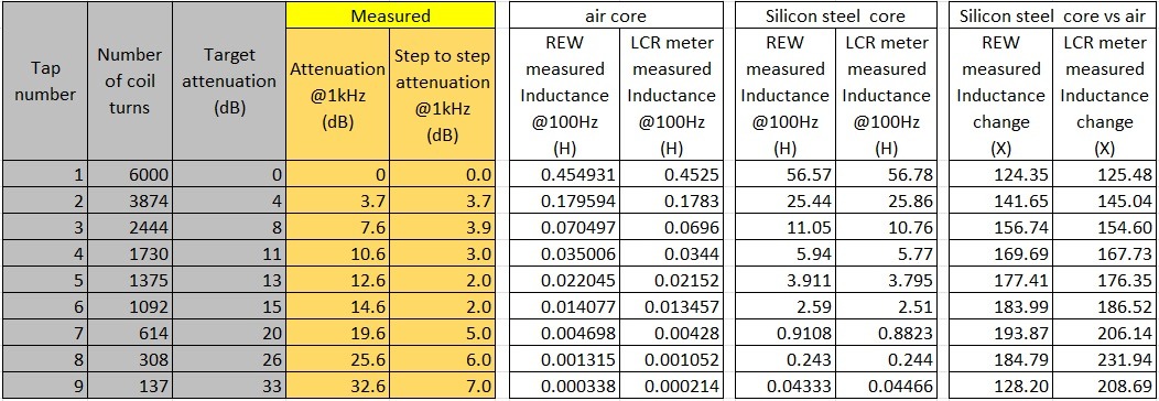

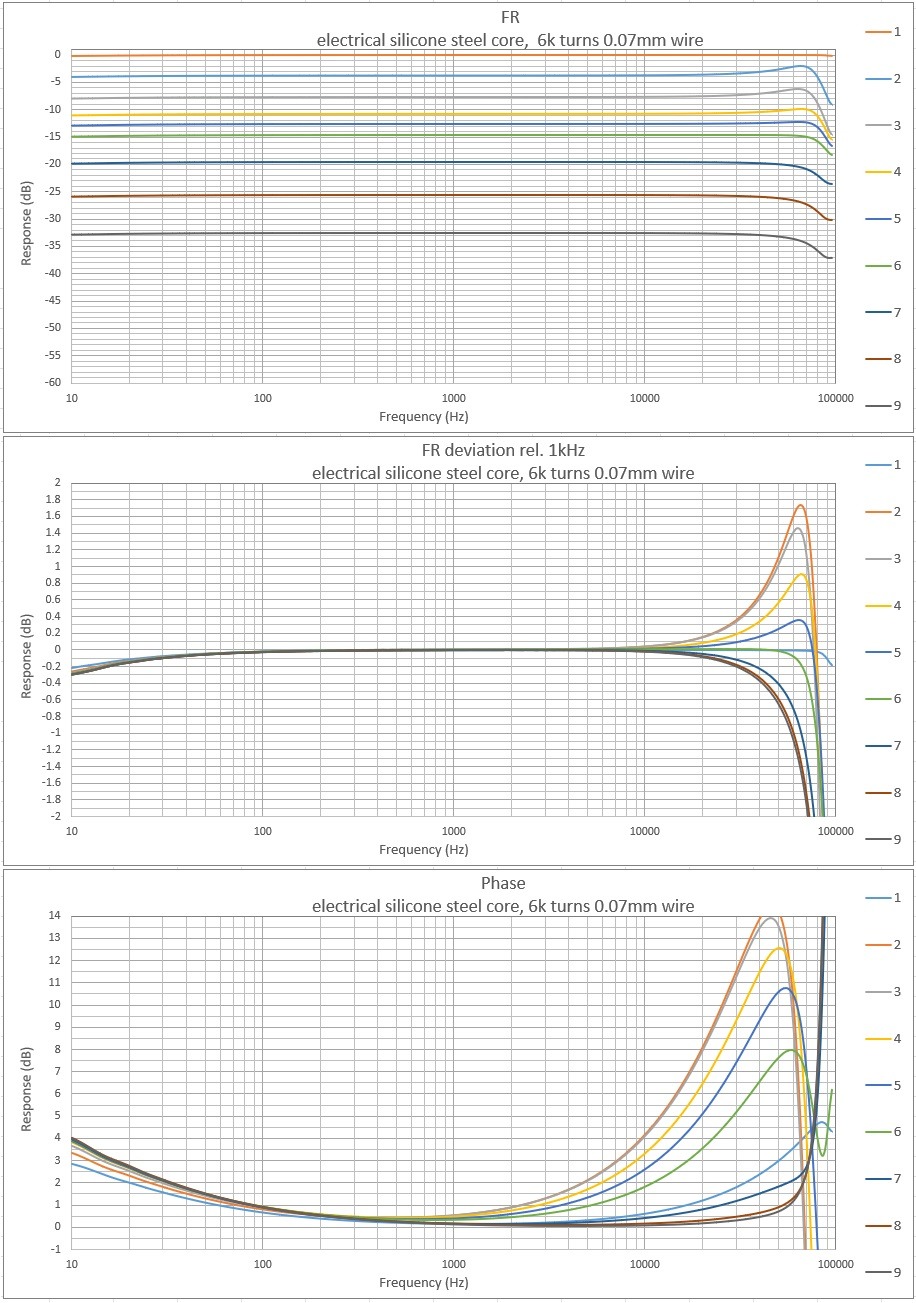

I did the essential electrical parameters measurements.
Then, off to the listening tests 🙂
Haven't done a comparison test, here is just the first impression.
Not bad at all.
Not so airy and detailed as the 80% nickel core but clean mids and a tad reduced treble.
Very good bass and body.
Listening will continue and some electrical test results will be shown later on.
George
