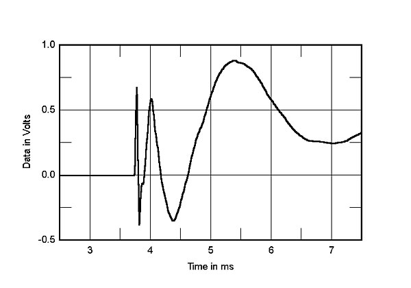

Sure, test report: "However, the output of the tweeter is very slightly too forward in time, which suggests that the B&W's optimal listening axis will be a little below the tweeter axis."I didn't mention it because B&W didn't do it:
https://www.stereophile.com/content/bowers-wilkins-802-d3-diamond-loudspeaker-measurements

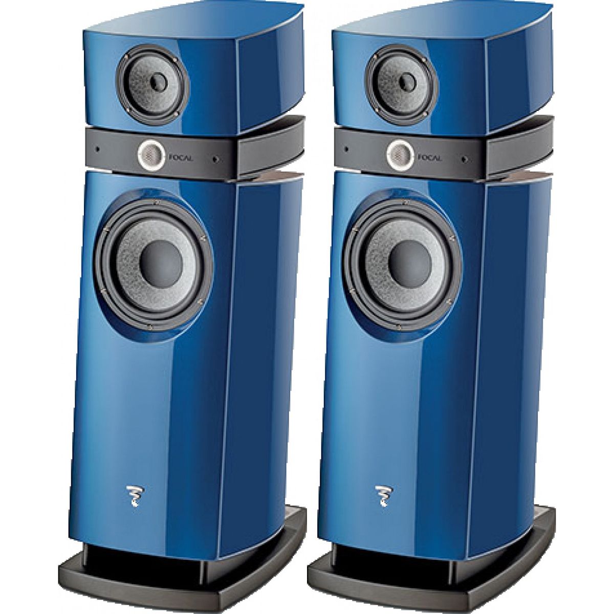

So, tweeter effectively offset; also Focal from #7, separate offset tweeter via different tilt angles etc.

(Stereophile) "In my admittedly anecdotal experience, a speaker that is time-coherent (on the listening axis) does have a small edge when it comes to presenting a stereo soundstage, in terms of image focus and image depth....
"In 1990, Rodney Greenfield and Malcolm Omar Hawksford [34] used DSP-based digital filters to try to separate the akudible effects of a loudspeaker's phase error from its amplitude response error. The point was made that a semi-reverberant environment will tend to mask phase effects. In addition, when typical recordings are played, which may have undergone many phase-altering stages during production, the audibility of phase differences becomes moot.... Nevertheless, the authors "very tentatively" concluded that equalizing a loudspeaker's excess phase error modified listeners' perception of the apparent soundstage." (end excerpt)
Given that research was done 35 years ago, hasn't any diyaudio members tried to repeat/improve upon it? If measured IR pre/post phase corruption of a 1-way fullrange driver were posted I (we) can (single-blind) interpret the differences if any.
