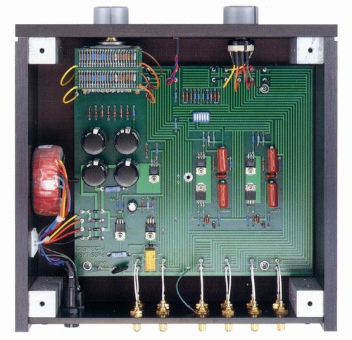

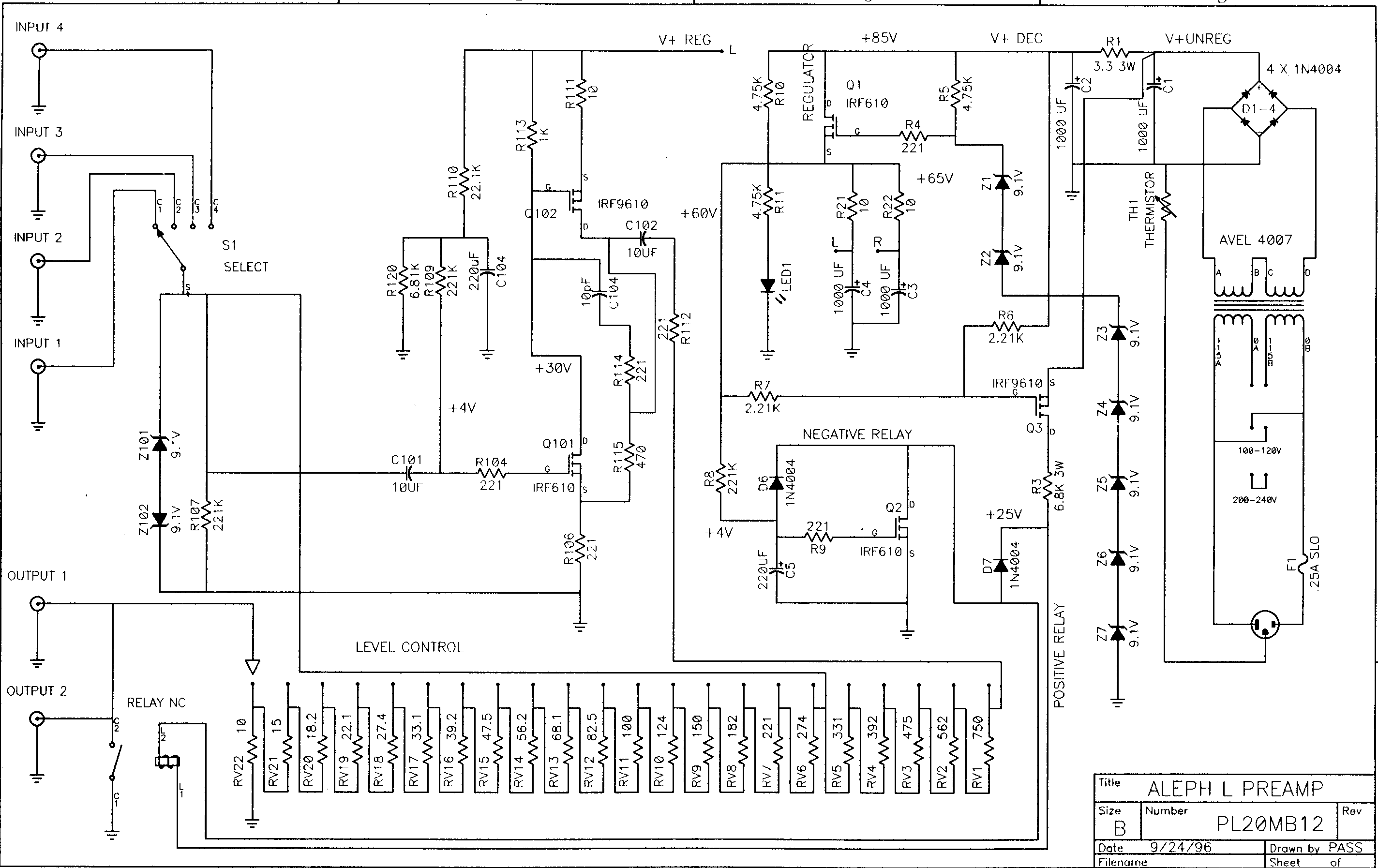

Years ago the Aleph L had a volume control which was passive up to the point
where actual gain was needed, and then active at settings above that. At that
point, the input source was directly connected to the output.
It was a feature that did not seem to be appreciated at the time.
If I had an Aleph L, think I’d want to put an acrylic cover on it 🙂
