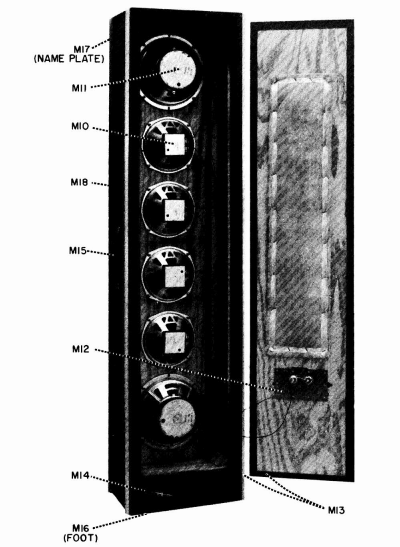

Shure vocal master VA300-S? Saw a set on Reverb for $150, but you had to live in WI..
