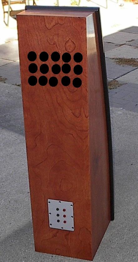

I'm considering chopping a big hole in the back of mine! How to do it and make it look like that's the way I planned it? Do you think a bunch of 1" holes will do the trick?
I have the inside lined with the styrofoam wedges and found that this was not effective, so I was adding some polyfil stuffing with the speaker playing. Taking the mid out and just holding it in my hand while I put the stuffing in showed an improvement in the sound. I thought :too bad I didn't make these open back".
So I may try it.
I'll need a couple of stiff drinks to get my nerve up enough to drill holes into my finished cabs 🙂
Andy Graddon said:
got pics of speaker's behind?
Here. I've pasted on a few "holes" for effect. Maybe better to carefully route out a rectangular hole with a recess around it to accept a cloth grill.
