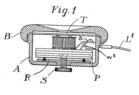

This specific model of headphones actually has a mechanism to change the seperation between the pole-pieces and the diaphram (the screw in the diagram below), so it might be more flexible in adapting to a different diaphram.
(from the attached patent doc)

While "sensitivity" is quoted as the reason for the adjusting screw (S) it also provided a means of altering --slightly-- the FR-frequency response , reducing slightly the higher frequency transmission some people actually liked a "smooth " sound in those days , just look at an old tube radio.s "tone control " .
