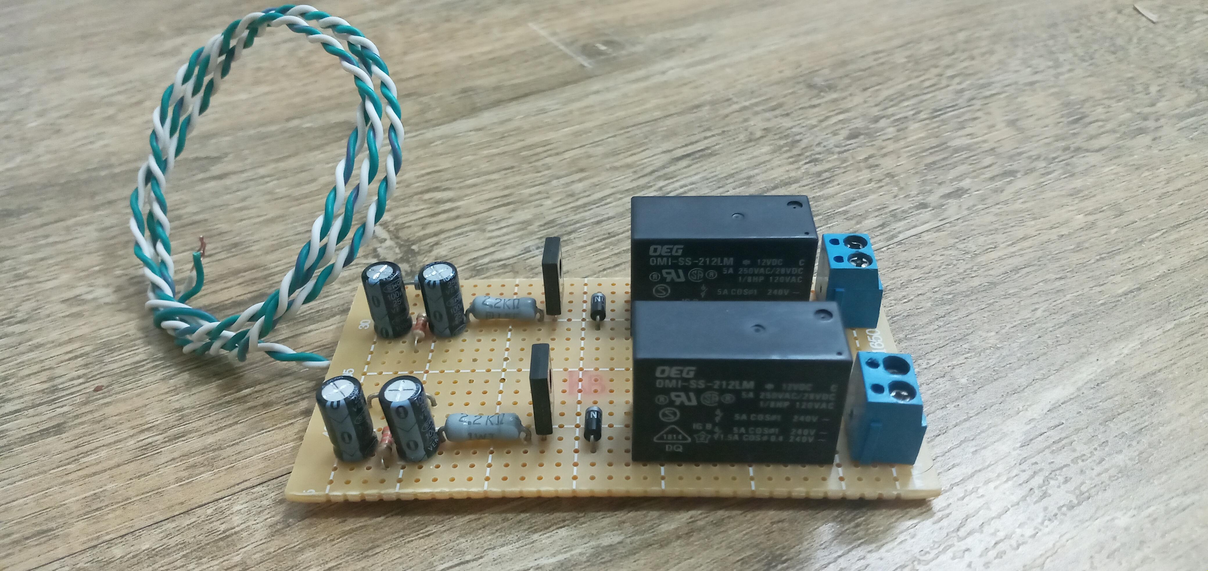

Anti-pop sound when tube amp turned off!
Actually i made this circuit
But it's not fast enough
To diconnect the output speaker from amp,while the main power switch want to turn off !!
You are making a big mistake and petertub already pointed at it. Muting relays and speaker protection are not novelties elsewhere in audio and they do prevent nasties like the ones you describe. In your case shorting the outputs is a way better solution than taking the risks of defects in the output transformers (which may occur when disconnecting the speakers!)
