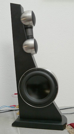

Anthony Gallo reference system copy
Mine will be similarily different.
One reason being I might use full range coax to simplify design.
In principle it shouldn't perform too indifferent than some 3 way designs having two separate cabinets, one containing the HF, and one large one for SW. file:///C:/Users/sourk/Downloads/bw_pursuit_perfection_m.webp
They just look wildly different visually =) I happen to like them, initally hated them. Never forgot how they sounded when a friend put them on the largest McIntosh integrated.
https://galloacoustics.com/wp-content/uploads/2019/08/reference-sa-manual.pdf
I'm still in the idea throwing around stage. I might also use a typical midbass and tweeter of some sort up top. Powered by a 4ch Nad Bee with mini dsp combination. The SW will also have there own separate active crossovers and power source.
The subs I'm going with unless it changes are Dayton Titanic version 3.0.
They work good in tight quarters, question is how good.

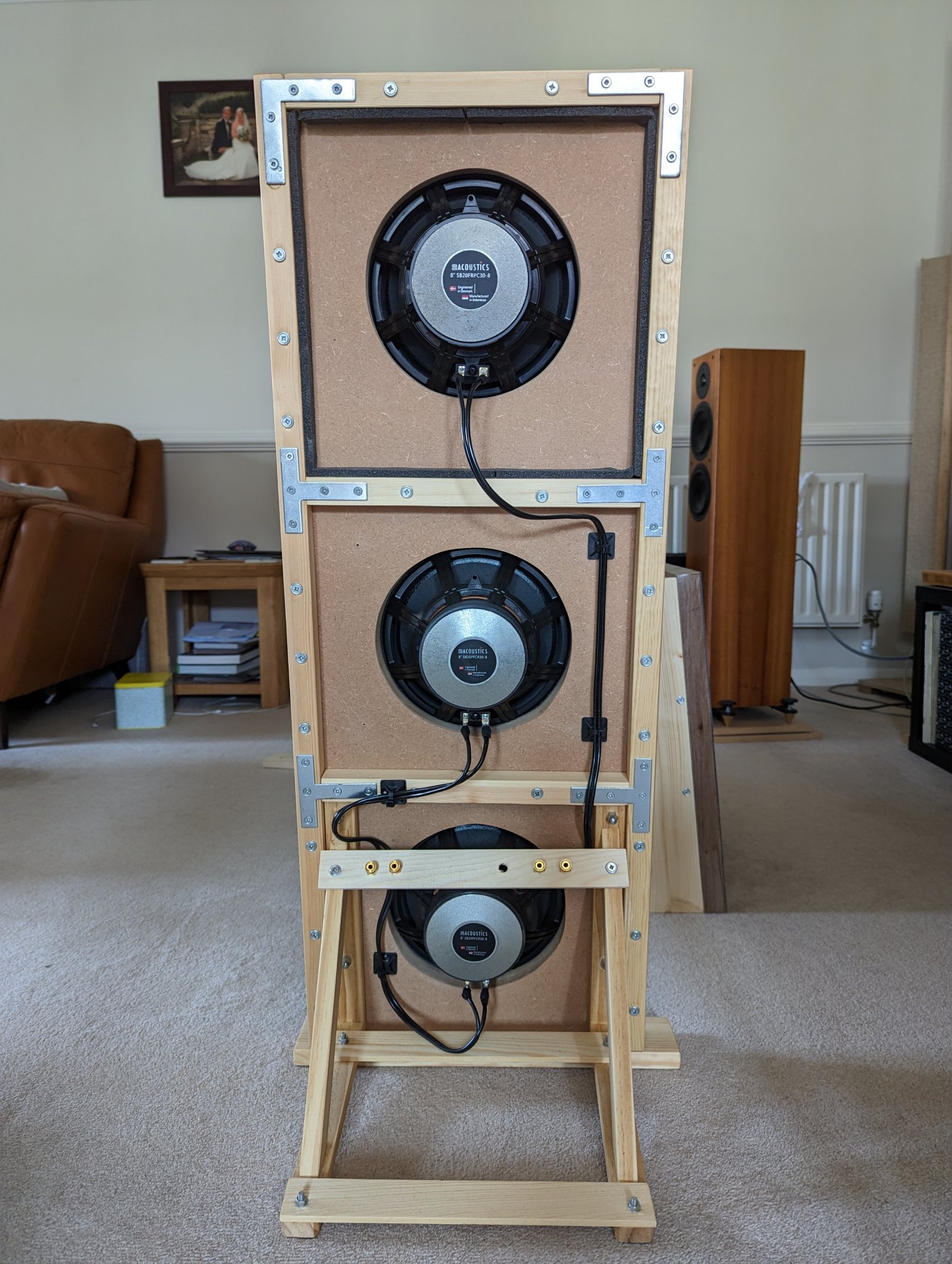

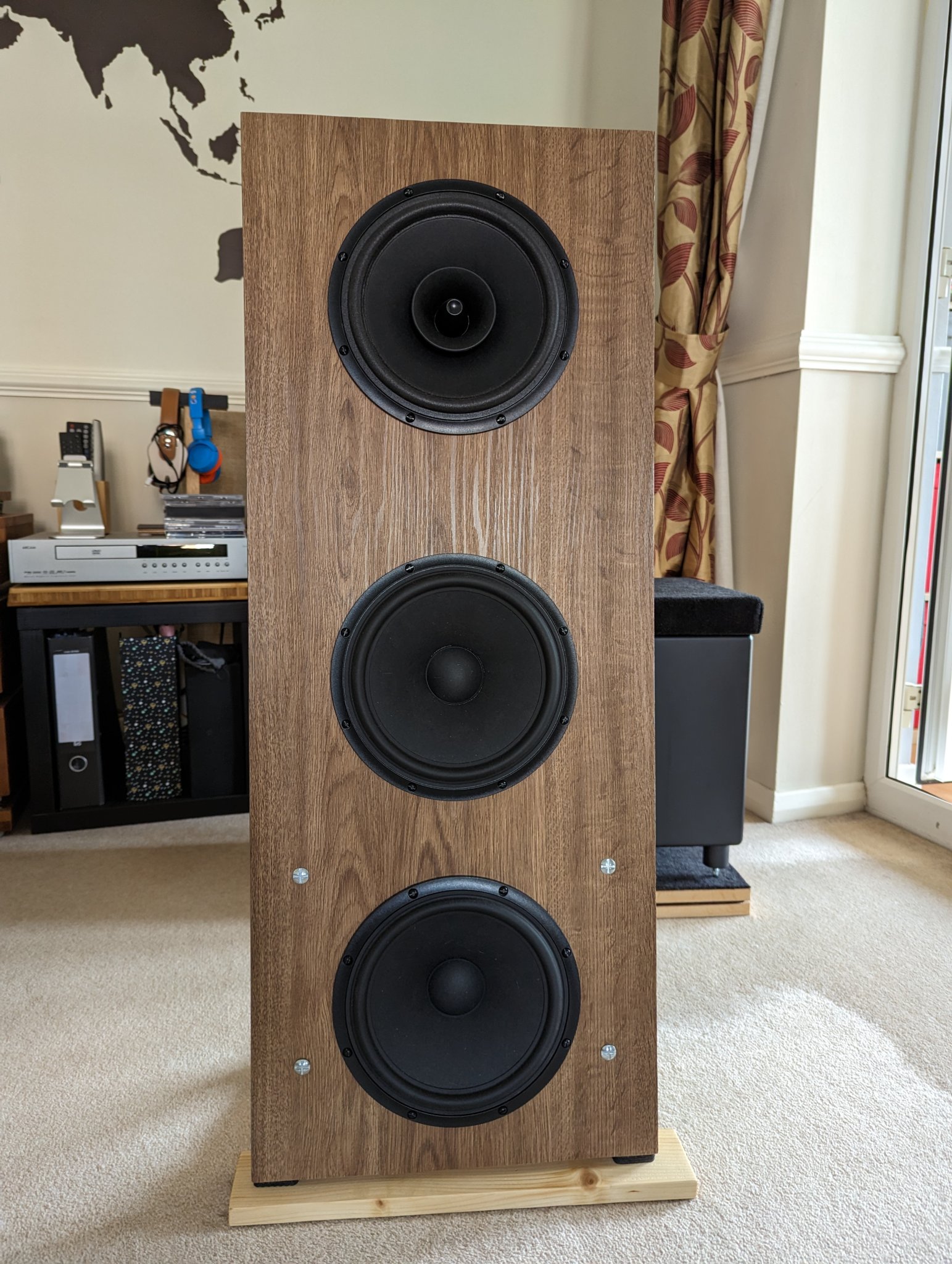

Having done a bit more research is see the original speakers used the Peerless XLS-10. I've also noticed that the driver section of the Gallo MPS 150 uses the same driver and superficially at least looks like the same unit. These do come up for sale used from time to time and at least the driver can be replaced with a new part if it has failed. Just a thought.
I might be over simplifying but to me the Reference speakers seem to be a combination of the MPS 150 driver section below with the Strada top section all mounted in one floorstanding enclosure. The simplest (semi DIY) option would be to acquire these sections and then build the stand to support them.

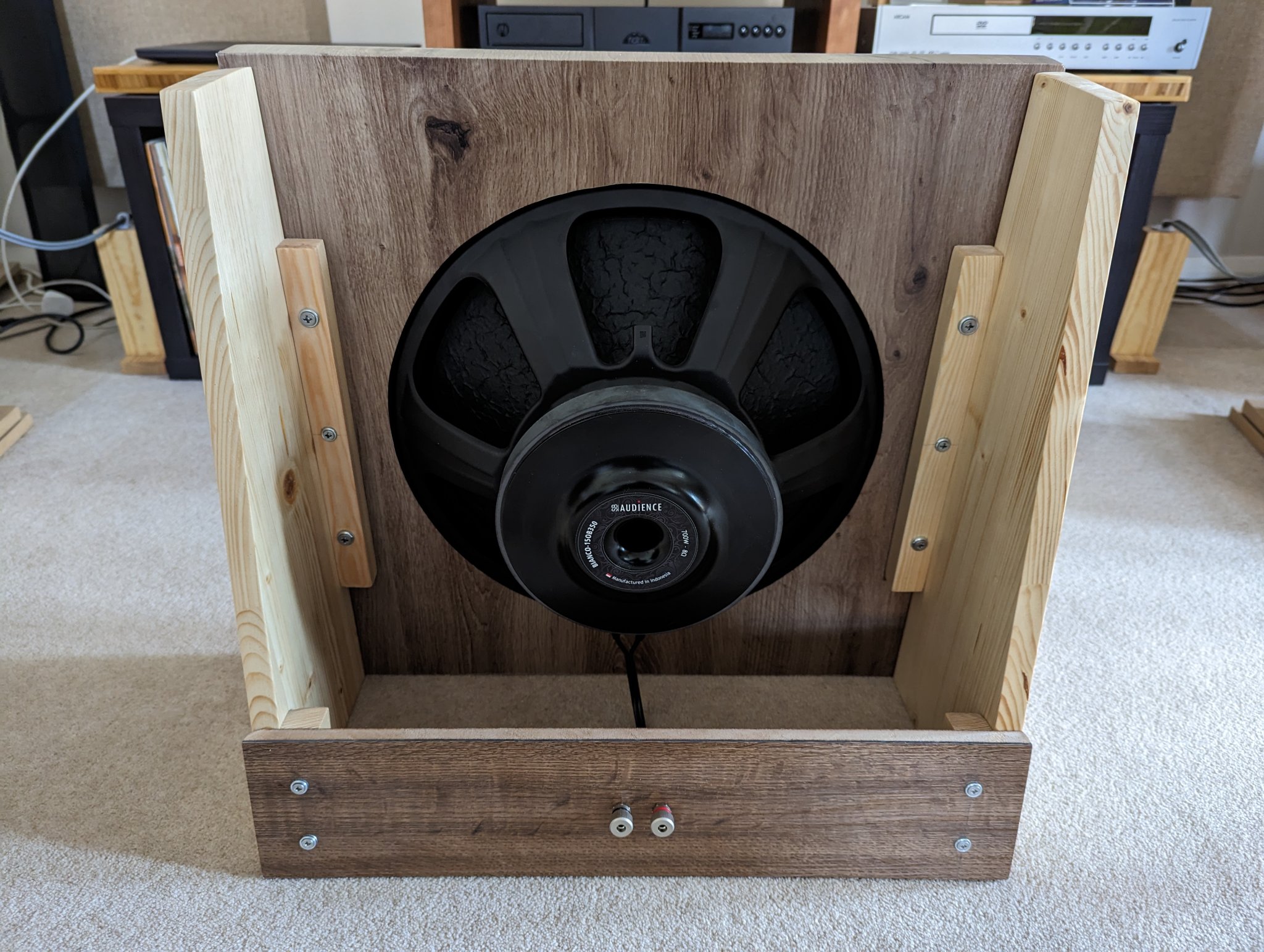

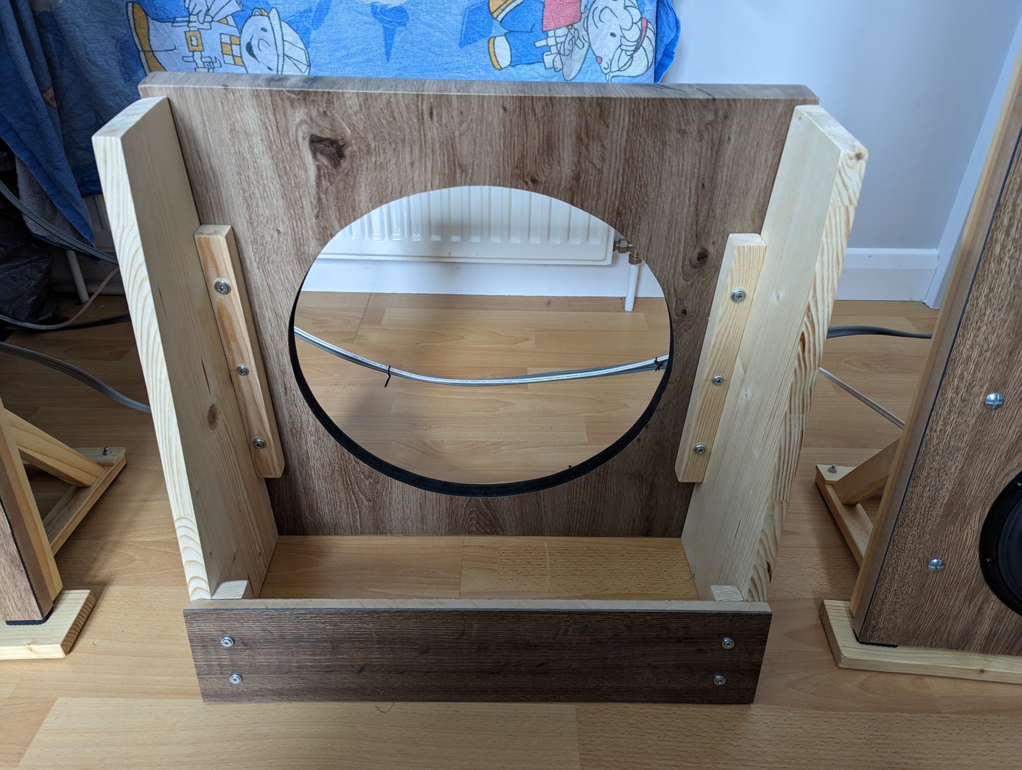

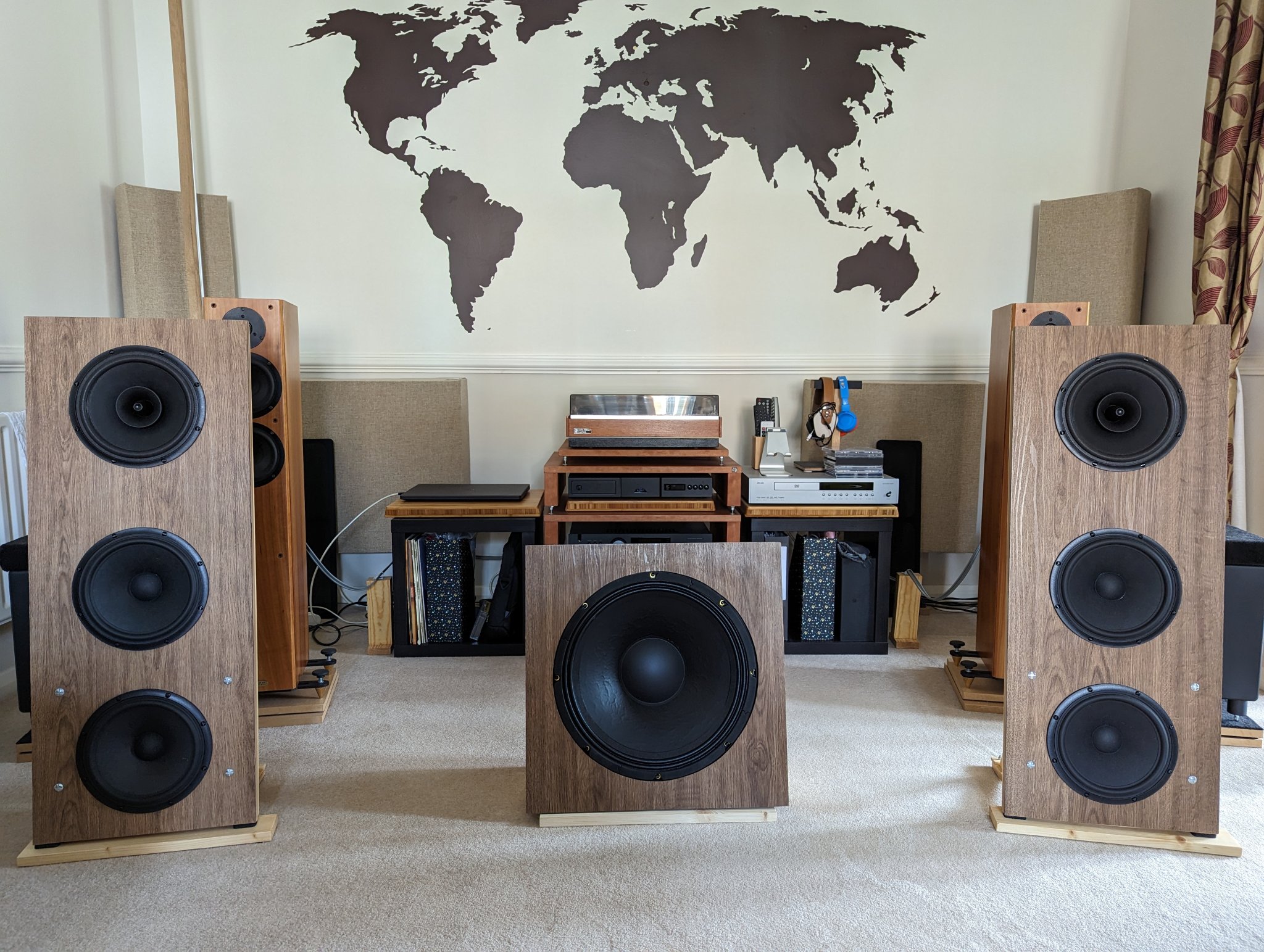

I'm seriously tempted but I've just finished my open baffle build so I might have to wait a bit😉

Compliments on several points for your OB system Alex.
Reactions: Alex P79

Thanks for the complements ref the OB system. A lot of research went into it. The SB full range provided a solid foundation but each additional woofer ‘section’ moved the game on and helped address OB issues in the bass. It was important to use woofers with relatively low FS and pretty good sensitivity but all the elements seemed to have combined to give pleasing results, at least to my ears!

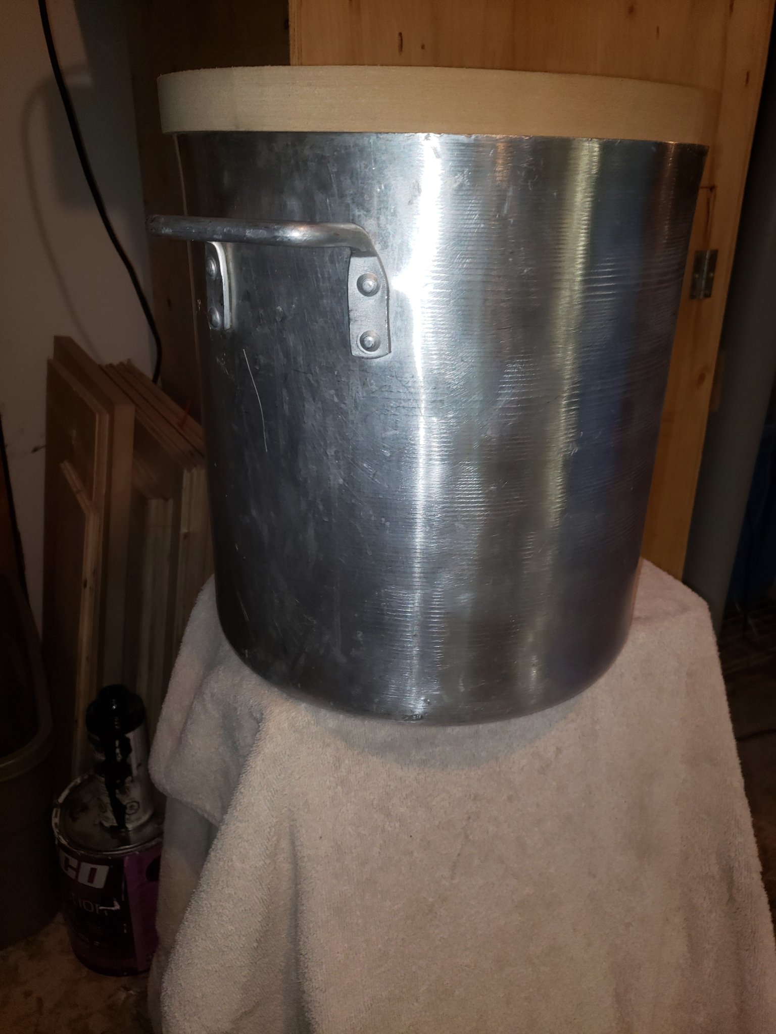

As you can imagine its almost non existant. I'm not sure if its even big enough to be called a baffle but its true.
You'll see exactly what I mean with the woofer mounted. But with new metal and veneer, if anything it will look nice. BTW thanks for the k.
The used pot seen better days, its badly checked around the edge from the chefs spoon. Along with some other bad battle scars. Its too gone so its simply unacceptable for such a time consuming project.

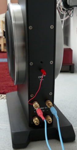

I almost forgot. Behind the to be speaker terminal plates, somewhere back there resides the crossover. I could either build in a void with pre determined dimensions, or leave the material solid and cut it out sometime after the lamination step? Both should work just as well. I'm a little unsure how to alter mine. Since those are metal and my main will be constructed of plywood there's bound to be discrepancies here.
I kind of like the idea of a countersunk SS plate to hide the crossover parts, the pos / neg posts will simply bolt to that.
