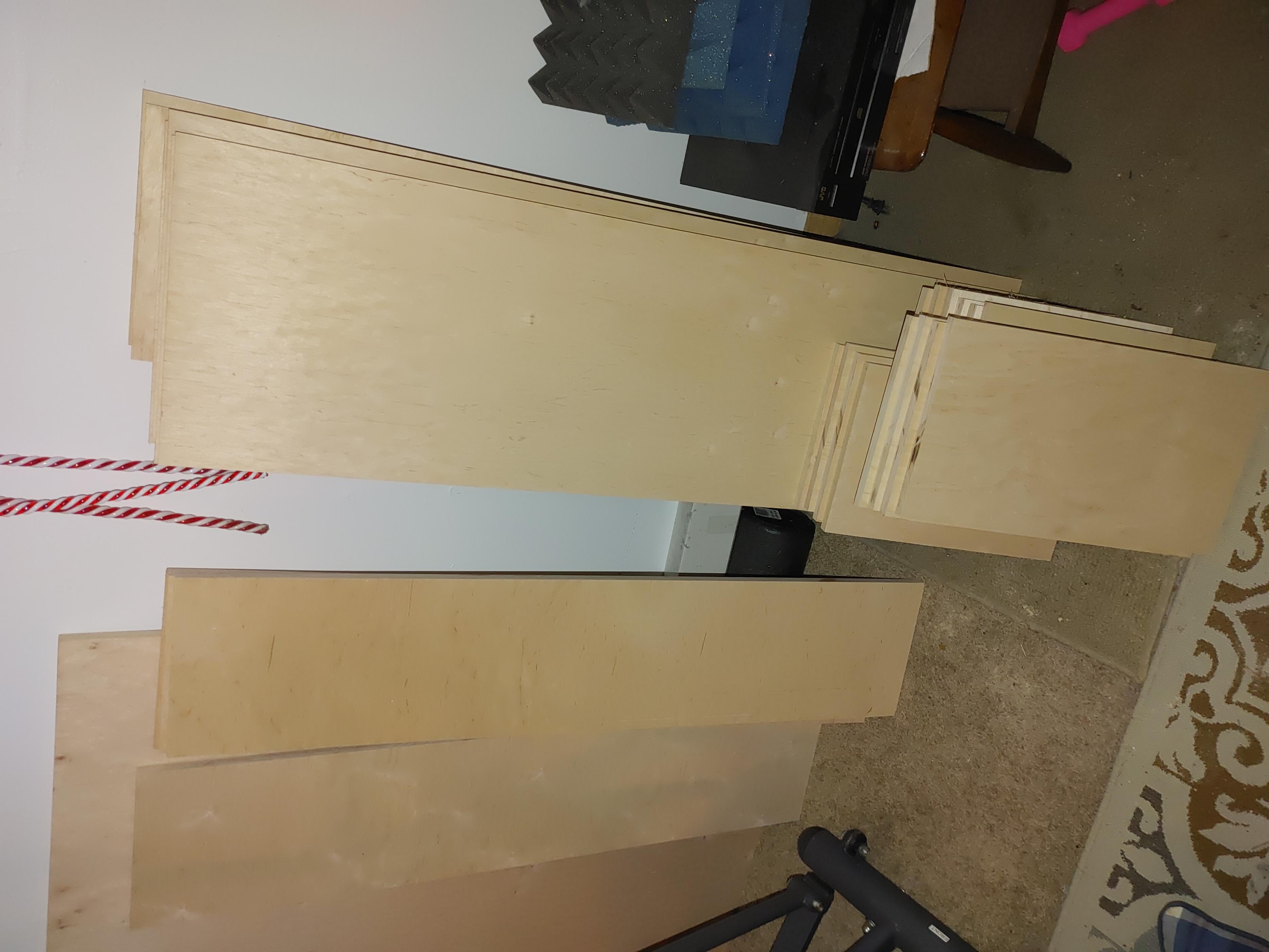

I have my kit and I'm in the process of sourcing some Baltic birch. I've been looking at the plans and it looks like there is a inner and outer front baffle. Can I shorten and round off the bottom of the outer front baffle without affecting the sound.
In the same way this build did except without the bottom porting:

Many pro speakers are built with 1/2" BB as it's light and strong enough. When internally braced (which often doesn't happen in pro speakers) 1/2" is certainly up to the task for anything but huge cabinets. That said, I think 3/4" is easier to work with - particularly if you use pocket screw construction like I do. Plus you'll probably want 3/4" for the front baffle anyways if you'll be flush mounting the drivers. Finally I don't really care that 1/2" is a wee bit cheaper or lighter as I don't move my speakers around all that much (pro speakers OTOH...).
Just a few thoughts. I designed the cabinets using a 3/4" inner front baffle with a 1/2" outer front baffle. I also did a 3/4" roundover on the inside of the 3/4" baffle for each driver cutout to allow a smooth transition of the rear soundwave. BB or MDF makes no difference other than weight. Yes, all the drivers are flush mounted. The cabinet plans show extensive bracing inside for a very strong and silent cabinet.
I hope you enjoy them as much as I do!
HTH
