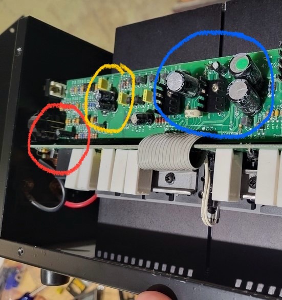

I’ve had and repaired a few of these Anthems and usually easy to repair and usually it’s been the caps I highlighted or a small voltage TO-92. Not seen any film capacitors go bad, and any resistors were identifiable from high heat marks.
Replace the capacitors indicated in this order, Red (1st), then Yellow and then Blue.
No reason to change PSU caps, they are within 20% spec and working fine (not had any outside the 20% when pulled out of circuit)
BE VERY CAREFUL if you take the boards off, the ribbon cable linking input board to output board is easily damaged and is 11/12 wires, and if you don’t get one of the power wires right, it can cause serious damage and throw it into protection or worse.
IMO if you are pulling the board and taking the risk, replace all the electrolytic capacitors, and take the time to unsolder the ribbon cable or you will break a wire or 4, ask me how I know.

Hard to say with certainty, but if it’s lacking I would guess it has an issue somewhere and I’d start with caps and checking bias and dc offset.
The one I got most recently was not working and since it was coming apart for repair replaced all the electrolytic caps and the input pair actives with set of matched ones and repaired the amp.
Personally I think it sounds really good now, compared to 4-5 other mid level amps I have, but I wouldn’t lie and say I’m an audiophile, more that fix amps I couldn’t otherwise afford and then sell when I have an itch to try something new. I rotate between Legacy, B&K, Golden Theater, Anthem and Wolverine (diy) and a M2x and SIT class-A clones by Nelson Pass. The Anthem holds its own IMO.
