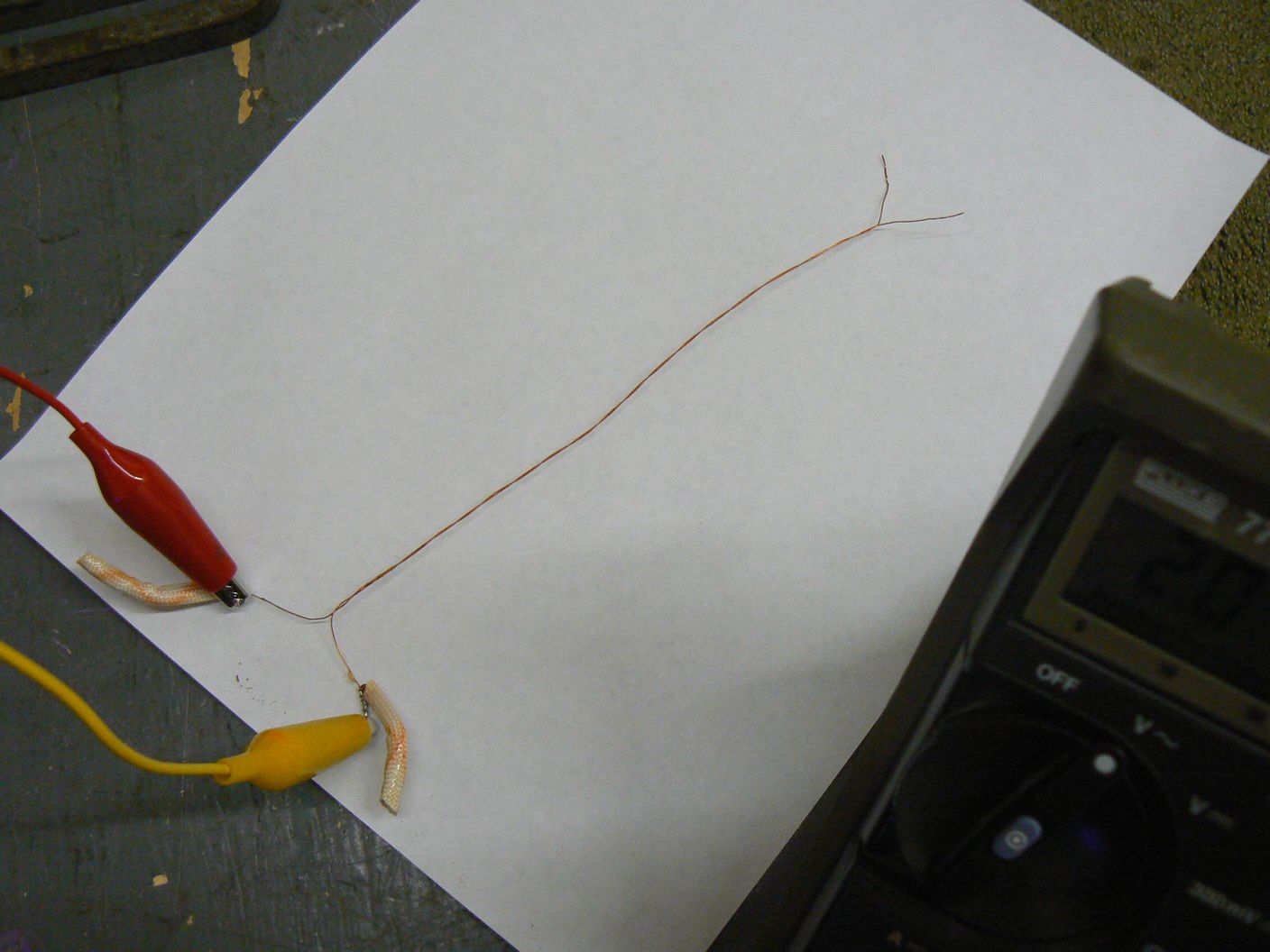

Attachment 1
Shows the preliminary arcing test setup with voltage applied between a twisted pair of the bifilar wound secondary wires.
The insulation withstood 1,000Vrms @ 1kHz for 5 minutes. But, I started noticing the distinct aroma of ozone.

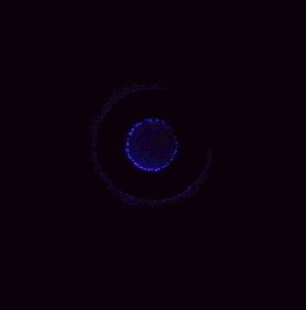

Attachment 2
Turning out the lights, you could see corona forming around the wire pair at any voltage above about 600Vrms.
Pic shows corona for 750Vrms @ 800Hz. Corona only forms in air.
High voltage transformers use oil or resin impregnation to avoid this problem.

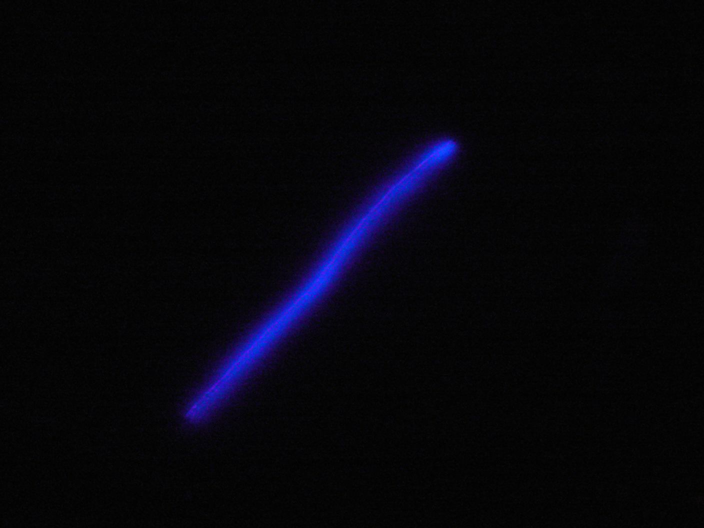

Attachment 3
Testing the whole secondary at 750Vrms, and the toroid gave a very pretty corona display. There is some resin or varnish applied to the secondary winding, but not enough to keep corona from forming. Sometime last night(after 2 days of constant 750Vrms) the insulation failed and arcing occured.
Over time, corona attacks the wire insulation and causes it to fail. It is a cumulative process. With this in mind, if I were to use these transformers for a hybrid ESL and planned to drive them with a 250W amplifier capable of 45-50Vrms output, I would use 4 of them instead of 2.
That being said, with the low peak/rms ratio of music it is highly possible that failure would not occur if only 2 transformers were used. But the possibility is there, and they are cheap enough that going from 2 to 4 isn't that painful to the pocket book. Also, with primaries in series-parallel, the core saturation capability is doubled allowing for lower crossover points if desired.
Alternatively, if your amplifier has good short circuit protection you could stick with the 2 transformer setup and just replace the set if you ever experience arcing.

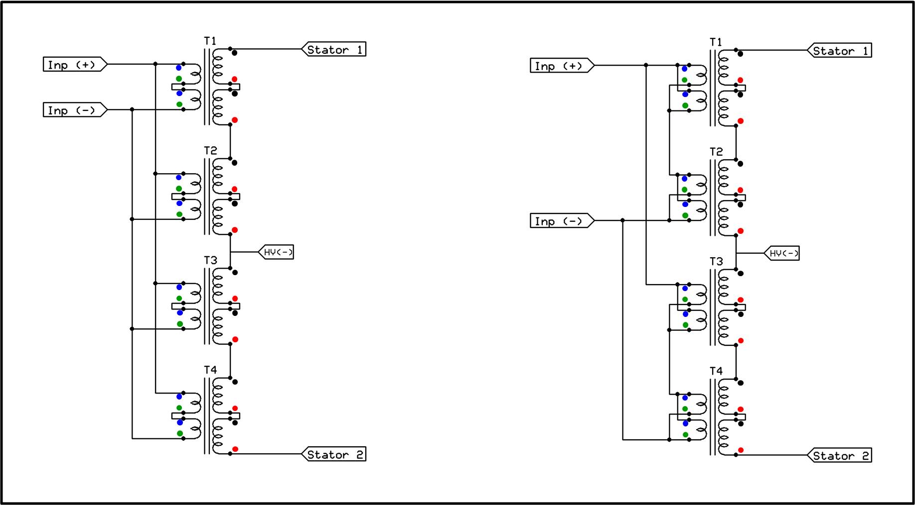

Attachment 4
Here are two possible methods for wiring the primaries of 4 transformers in series-parallel.
I can't think of an advantage of one over the other...perhaps somebody else can.

Attachment4.
What is supposed to be different?
The impedance seen by the input voltage is identical for each arrangement.
Question:
If the corona is suppressed by potting, or whatever, does that change the reliability (no arcing) at high voltage operation?
Attachment4.
There is no difference as far as input impedance or output voltage.
Only the arrangement of series-parallel connections of the 8 primaries.
One may be physically more convenient or simpler to wire up than the other, but electrically they will perform the same.

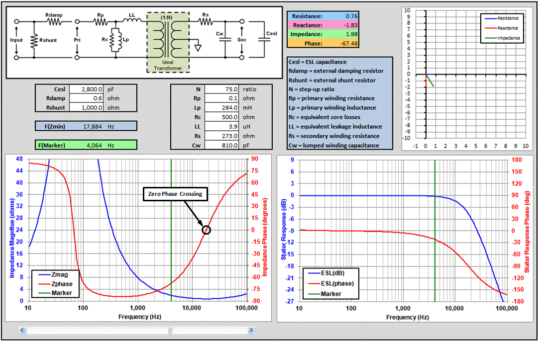

Regarding the different series/parallel arrangements, perhaps a non-idealized circuit diagram (including all parasitic capacitance, inductances and wire resistance etc) will give more insight?
You are right of course...I really should put together a SPICE model of the 4 transformer arrangement with all parasitics modeled to see if one arrangement has any advantages as far as HF bandwidth. I had been thinking that since all 8 of the primaries are pretty much at the same voltage potential when compared to the HV on the secondary windings, the connection arrangement of the primaries would have little if any affect on the HF bandwidth.

Then you can calculate the resonance frequency:
F=1/(2*pi*sqrt(L*C)) = 17.7kHz
You can also play around with the transformer-ESL modeler spreadsheets I posted which had some examples with the Plitron transformer.
http://www.diyaudio.com/forums/plan...101-electronics-challenged-2.html#post2555863
Correct. With 70 primary turns on 10.5cm^2 area core, saturation onset point would be about 20Vrms for 50Hz.
The statement basically means that rather than winding all of the secondary in one section, it is best to wind the transformer with 1/2 of the secondary one either side of the primary. Then the ends of the two secondary halves closest to the primary should be connected together as the center tap. This arrangement minimized primary-to-secondary capacitance. If this winding arrangment is used, adding electrostatic shielding would be of little benefit since the potential difference between the primary and adjacent secondary layers is relatively low.
That is pretty high panel capacitance. I would say you probably would want to keep the effective primary leakage inductance below 4uH - 6uH depending on the level of winding capacitance. When calculating upper bandwidth limit, don't forget you need to reflect the leakage inductance and panel capacitance to the same side of the transformer before doing the resonance calculation. For example, 4uH on the primary becomes 22mH when reflected to the secondary thru a 75:1 step-up transformer. Don't forget to include the transformer winding capacitance (810pF for the Plitron) which brings total secondary capacitive load to 3.6nF.
Hi bolserst, thanks for the reply. Plitron's data might not be accurate as it does not resonate at audioband with my stats, Verwaal also stated that Plitron's measured resonance was ~10kHz upper than simulated based on the data.
But if i were to connect the 6 Anteks like we discussed via email, what happens to the resonant frequency, does it get up or down?
I read between the lines, that the electrostatic shield in beneficial, or at least it is not harmful in any case? I get if for the same price so it might be better to just get it.
-Legis
How did you determine the resonance point of your stats? In most cases you will not see a pronounced peak in the frequency response unless you use no damping resistor, your panels are flat, and you are measuring on-axis. The easiest way to determine it is to measure the impedance and look for the zero phase crossing point at the top of the audio band where the impedance reaches a minimum. Note that even with voltage drive to the stators rolling off before 20Khz, the measured SPL may still be relatively flat because directivity gain of large panels boosts high frequencies.
Adding more transformers in parallel/series will result in resonance frequency going down.
Even if the added transformers were perfect, the increased step-up ratio would increase the reflected leakage inductance or load capacitance.
Shielding is not harmful, but it may increase the distance separating the primary and secondary which would increase leakage inductance. For power transformers this is not a big concern, but if used for ESL step-up transformers driving a large capacitive load it might be.
