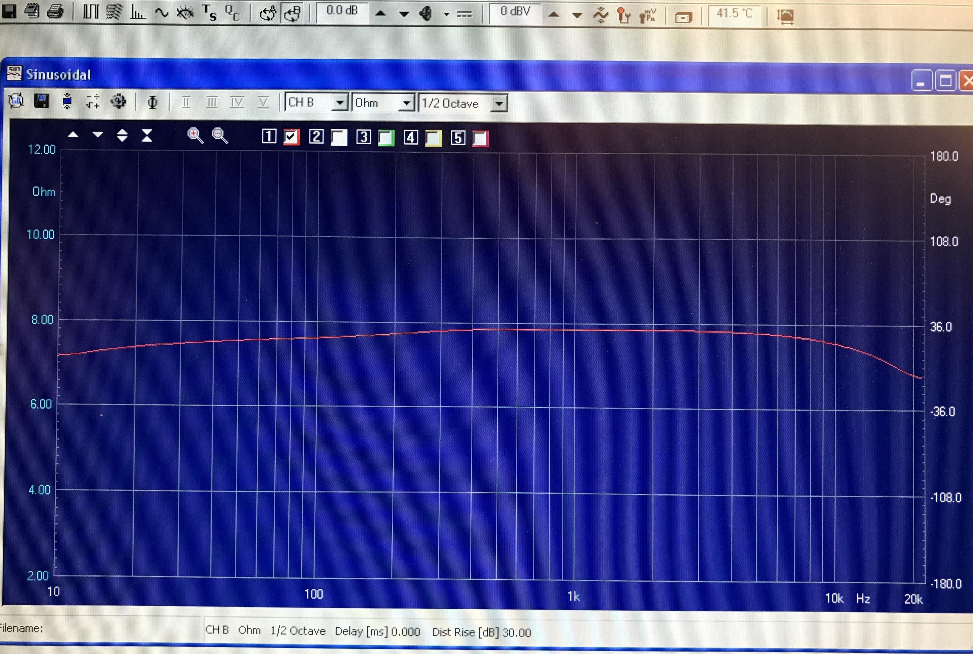

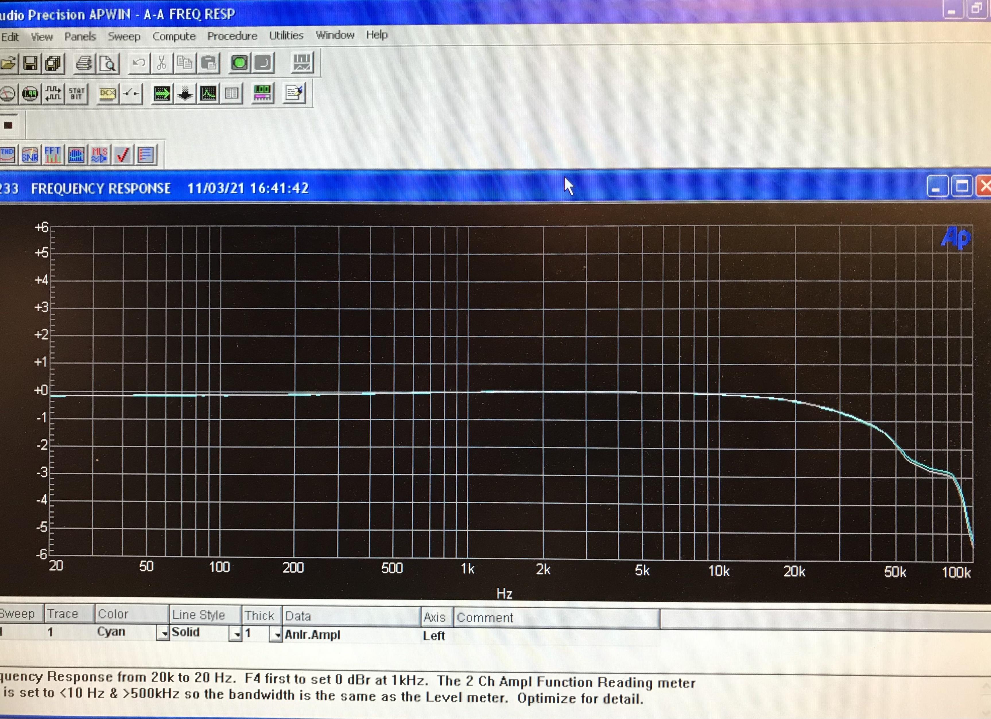

I bought a pair of the Antek MP-40W66 Output transformers.. I was a little skeptical but figured it's worth a try.. First measurement was using an Audio Precision with a 5.6k ohm resistor between the source and the primary (Plus the internal 50ohms).. The second measurement was using Clio system to check the impedance of the secondary with the Primary shorted by the same 5.6k resistor.. The secondary was a pretty even 7-8 ohms between 20-20kHz.. indicating that the primary is not too far off the 6.6kohm claim. This first look has me thinking these aren't too bad.. Certainly better than an old Sherwood S8000 Output transformer I have lying around (Which is also ~35w/ 6.6kohm) next, I'll be looking at balance in the primary, see what some DC in the primary does etc.. Then I'll hook them up to my test rig. 2x KT120 with plate feedback (So I can get a good even drive and a good look at what the transformer does without loop feedback)

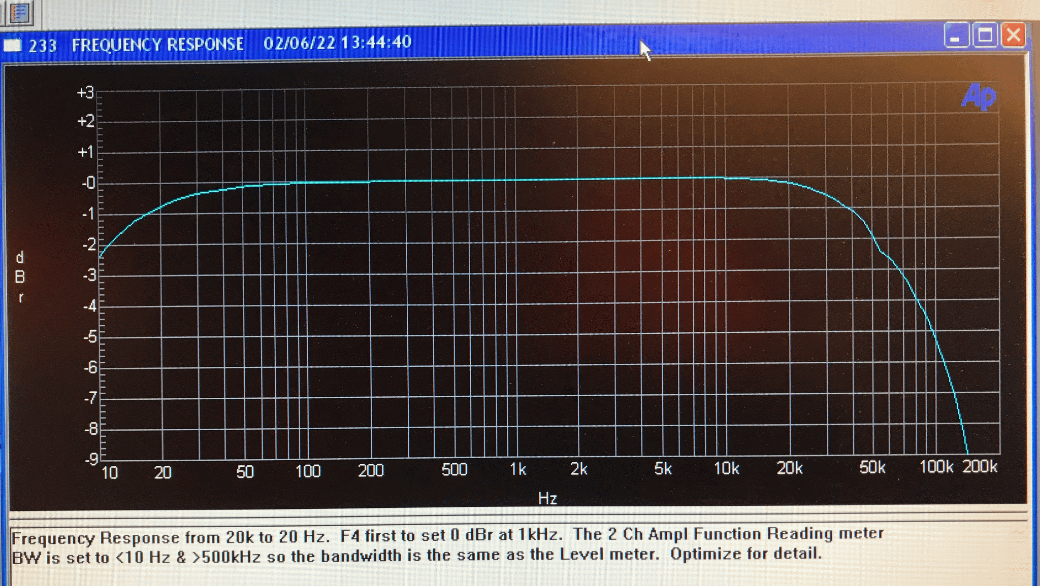

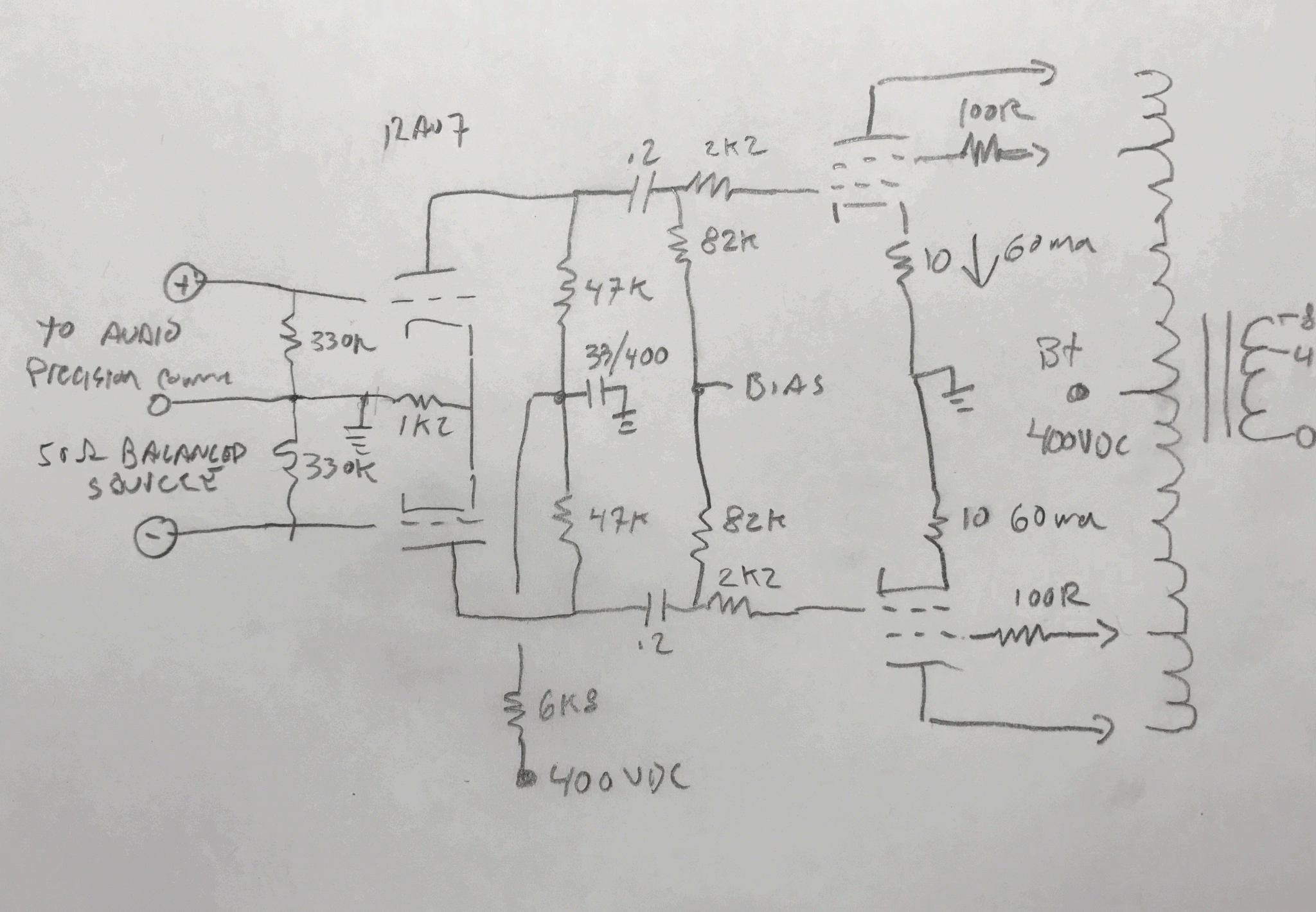

Ok.. What I did was to create a little test rig to see what these transformers could do. (MP-40W66) I used 2X 5881's driven by a 12AU7. Power (400VDC) and bias was provided by a Heathkit IP32 regulated power supply. The circuit could only drive to about 8.8 watts with the 5881's configured as Triodes. Here's the test circuit and 8.8 watt frequency response into 8ohms. This is open loop. No feedback. Some of the rolloff at the bottom is due to my coupling cap and bias circuit which is a hi-pass at about 9.7Hz. -3dB At about 67kHz. Not bad. There's a little resonant glitch visible at about 55kHz.

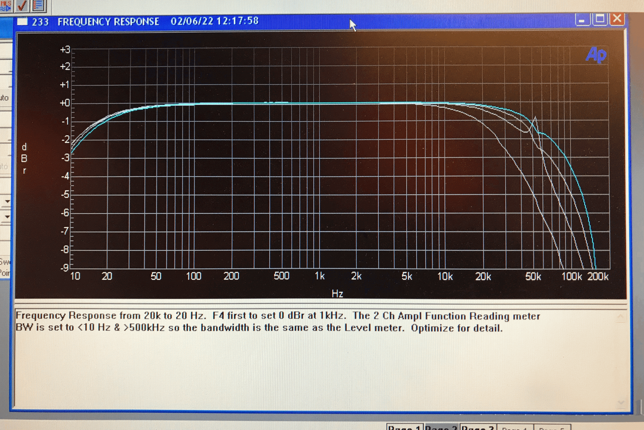

Here's a comparison of Triode vs UL vs Pentode operation. The Blue Trace is triode operation at about 300mw and is with the 5881 grids being driven directly by the audio precision. This shows the true bandwidth of this transformer in a real situation with perfect AC balance. The other three sweeps show Triode operation at 1 watt, UL operation at 1 watt (Note glitch at 55Khz) and Pentode operation at 1 watt. (FYI. The tubes were biased at 60ma each.) The overall bandwidth suffered as my driver was losing balance above 30kHz.

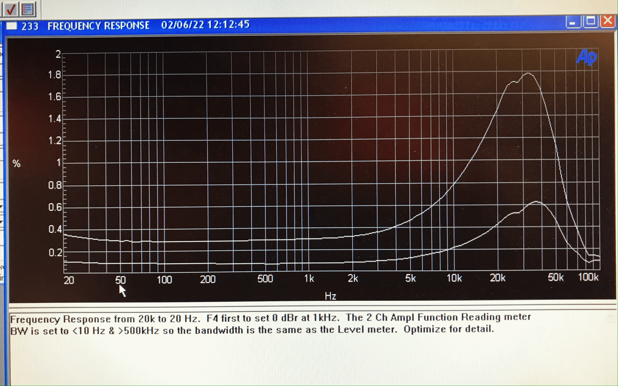

Distortion. Here's triode, open loop operation at 5watts and 300mw respectively. Again, the loss of balance at high frequencies causing issues with distortion at higher frequencies. The 300mw distortion is quite good. One take away is that there's a fair amount of interwinding capacitance. This is evident by the decreasing bandwidth with different driving conditions. Triode being low Z, UL and then Pentode..

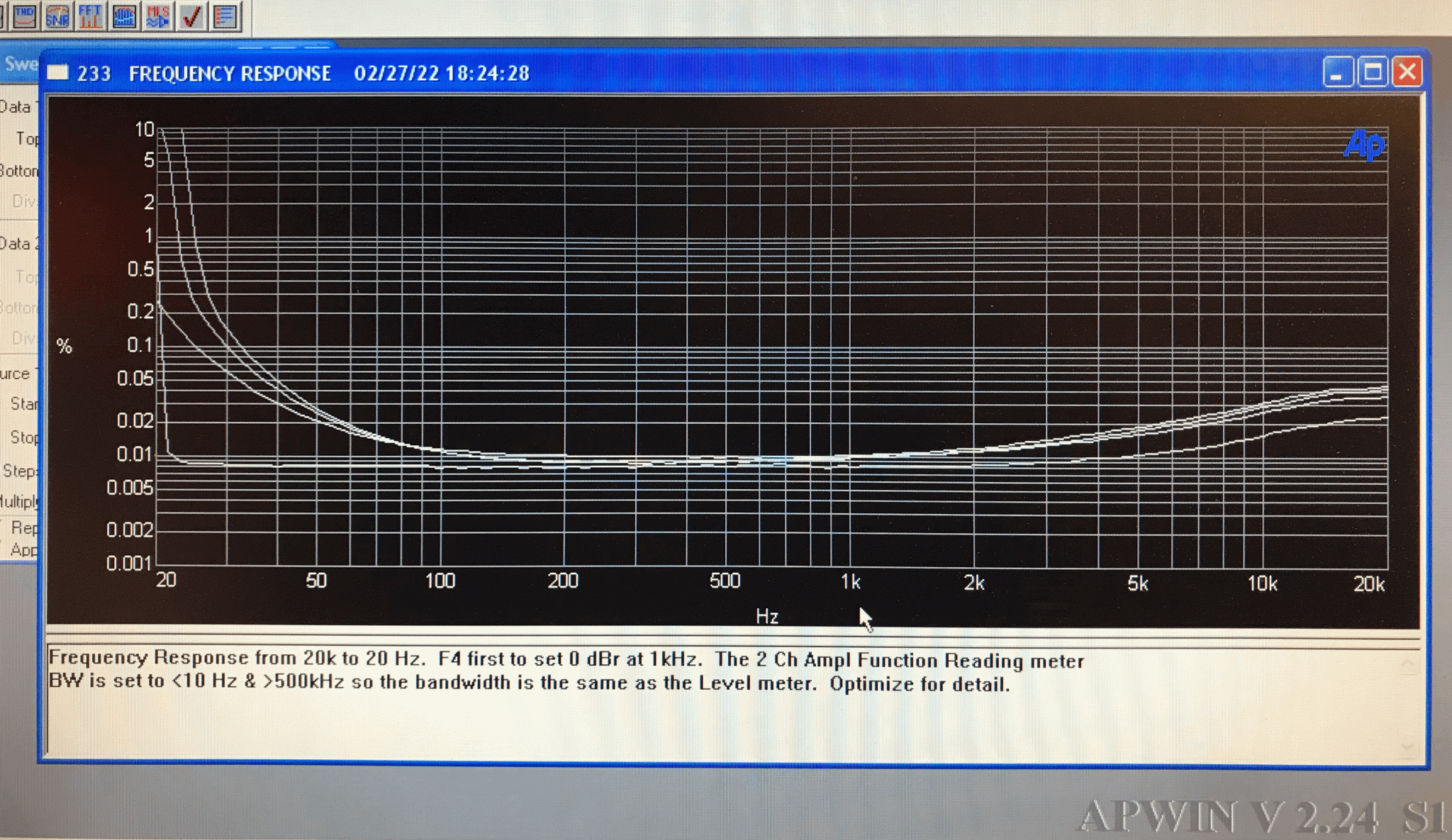

I decided to try and figure out how good these 40 watt transformers were on the low end. To check distortion, I wired two transformers back to back.. Fed the 8 ohm winding of one from a Crown Macro-Tech 600. I checked the THD at 50Watts, 40Watts and 25Watts on the output of the second transformer loaded with 8 ohms. The bottom trace is baseline distortion of the crown at 50 watts output. Keep in mind. The Distortion is a consequence of going through TWO transformers..
