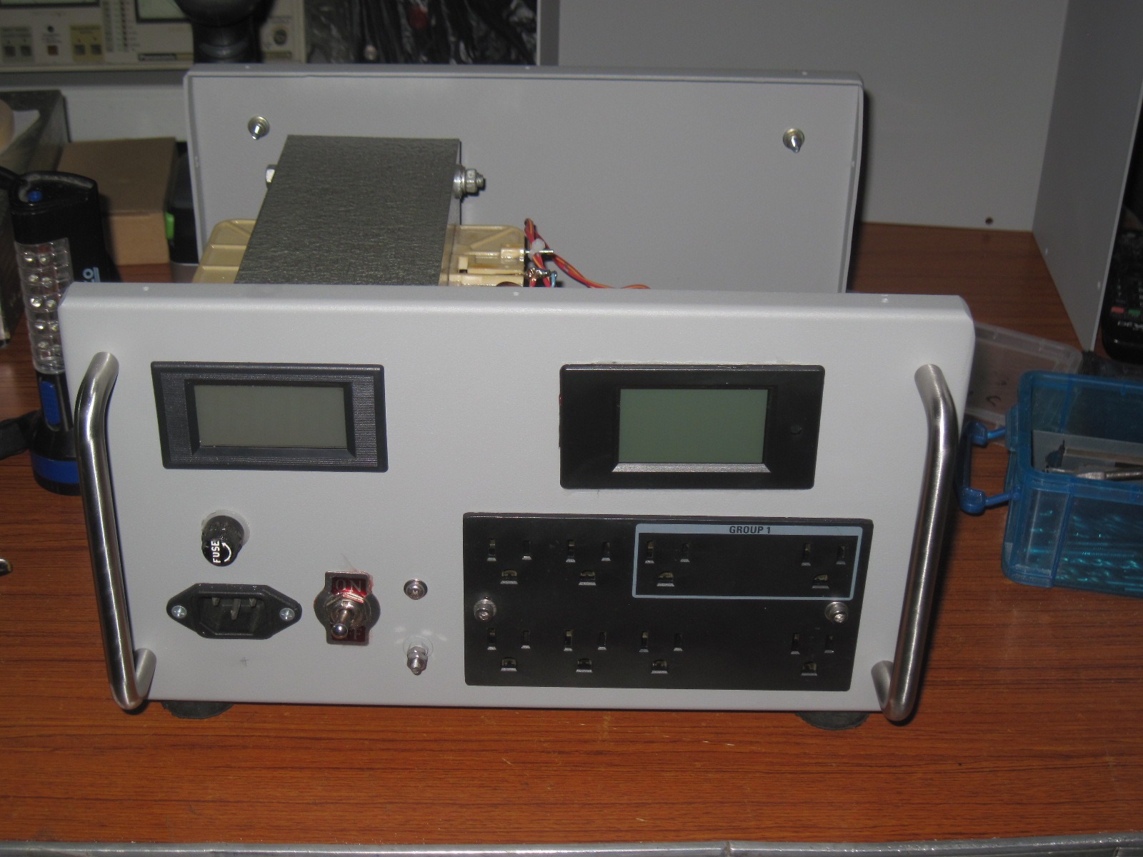

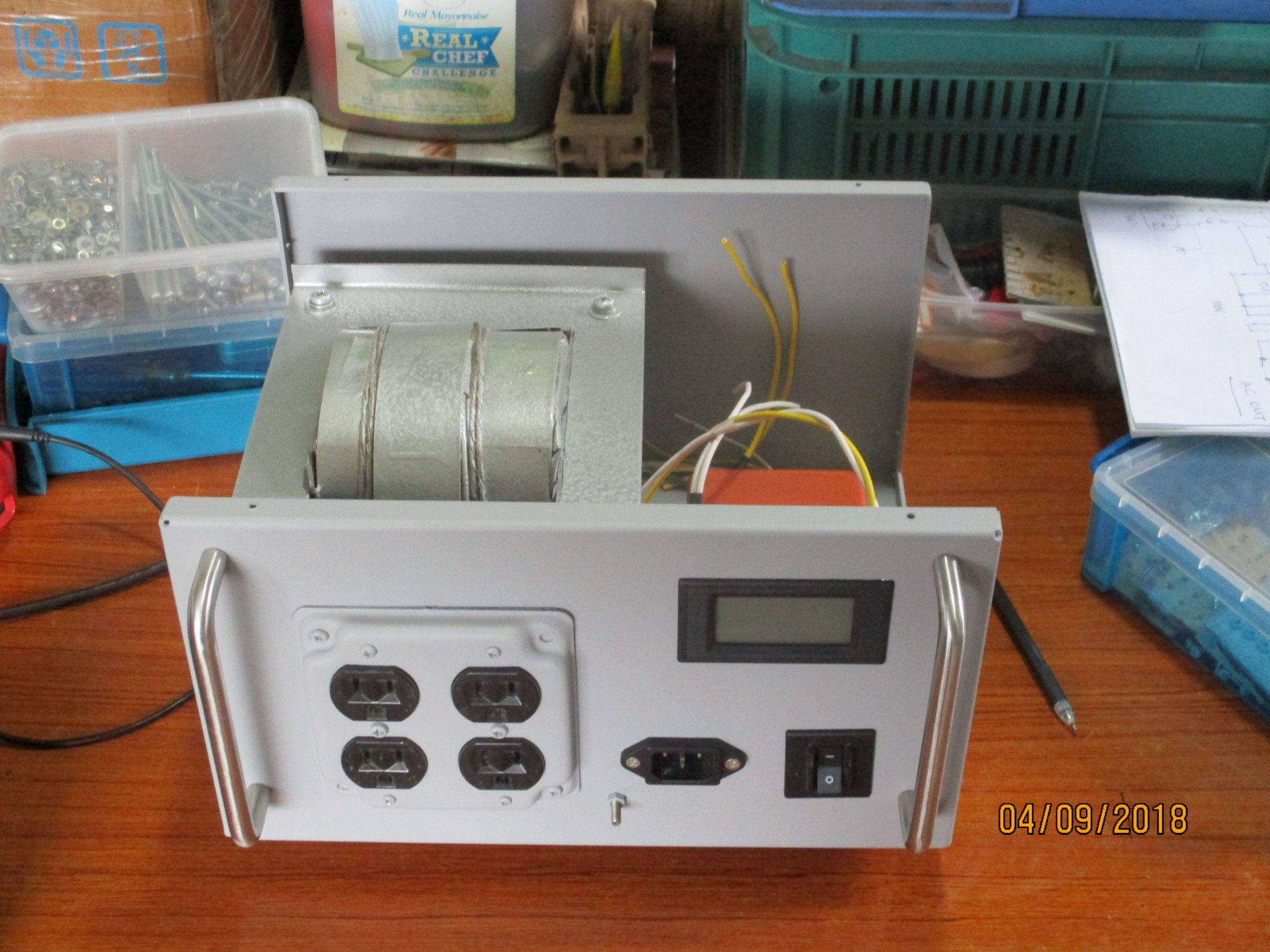

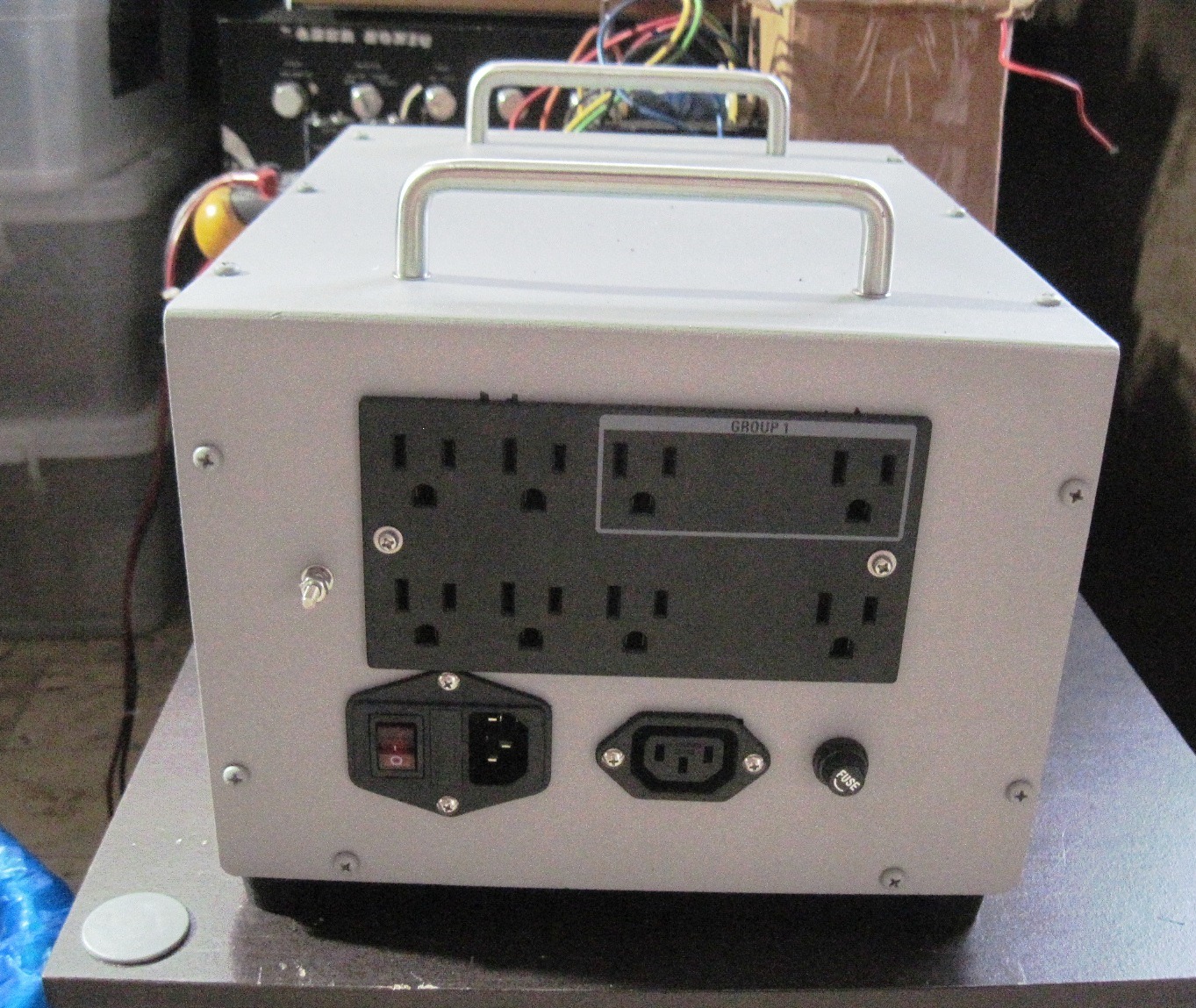

safety is the biggest reason for me to use isolation transformers......i made 3 of them for clients..
