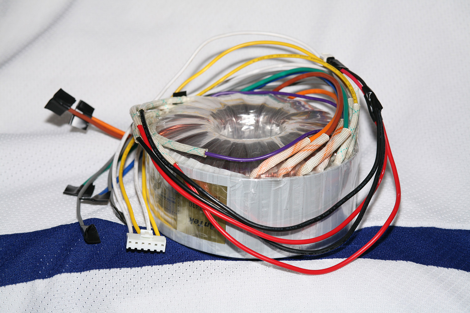

Folks,
As the Antek AS-xxx models aren't spec'ed on Antek's site, I figure I'd share some measurements performed on the AS-4T430 transformer. The AS-xxx models are the shielded versions of the AT-xxx and according to John Ango of Antek Inc, they should be identical except for an electrostatic shield between primary and secondary and a 'belly band' around the outside of the core.
I have to say that the Antek transformers were never pieces of industrial art and the 'belly band' certainly doesn't improve the looks. But conveniently, Antek sells some bells that mount over the transformers which make them aesthetically acceptable to mount topside on an amp chassis.
PRIMARY:
2 x 115 V
DCR: 2.64 ohm each winding
SECONDARY:
2 x 430 V with a tap at 70 V
DCR: 32 ohm each 430 V winding
2 x 6.3 V, 4 A
Measurements @ 300 W load:
110 V AC IN; 391 V AC OUT; 743 mA sec. load current
114 V AC IN; 402 V AC OUT; 760 mA sec. load current
115 V AC IN; 408 V AC OUT; 760 mA sec. load current
120 V AC IN; 426 V AC OUT; 778 mA sec. load current
126 V AC IN; 447 V AC OUT; 799 mA sec. load current
Measurements @ 80 W load:
110 V AC IN; 406 V AC OUT; 191 mA sec. load current
114 V AC IN; 421 V AC OUT; 194 mA sec. load current
115 V AC IN; 426 V AC OUT; 196 mA sec. load current
120 V AC IN; 444 V AC OUT; 200 mA sec. load current
126 V AC IN; 467 V AC OUT; 205 mA sec. load current
The measurements for 300 W load were performed by using four 100 W, 120 V light bulbs in series for the secondary load. For the 80 W load condition, four 25 W bulbs were used. In both cases, the two secondary windings were in parallel. The two primary windings were in parallel as well. The primary voltage was adjusted by a variac and measured with a voltmeter. The secondary voltages and currents are measured values.

Russ - good catch.
It's two windings 0-70-430. The windings are identical and not symmetrical. So when wired in series, you'd get 430-360-0-70-430.
I suspect that if one keeps the load on the 70 V tap light relative to the total secondary load, it would probably be OK. I'll be using it with a voltage doubler to run the input stage of my amp (needs about 160 V).
