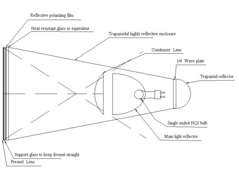

DIY light engine
Guys,
I believe this or a variation of this will be the most efficient light engine that we can design with a resonable cost. I feel that it will utilize about 80% or more of the total light of the bulb. The important things are that the light arc be at the bottom of the reflector and the bulb be as small as possible.
With this arraingment most of the light from the arc will be directed through the condenser to the fresnel. Any stray light is trapped in the light pipe and recycled for correct polarity. It is important the the main reflector be reflective on the inside and outside. And any brackets inside the pipe should be of reflective material. Also the longer the fresnel focal length the better this will work because it will reflect less off incident light.

nice design buddy its similar to what im going to design but my design would be with easier parts to get and a few filters in different places , but overal nice design bud.

Hezz, I have worked on something like your lightenginee now for two weeks, but I can say that I failed. It seems that it´s not possible to focus the light and then spreed it from a focus point, because you will get a projection of the reflector on the lcd and that projection will get anlarged though the fresnels and projected on the screen mixed with the lcd-picture. Maybe some kind of diffuser can solve the problem.
Mathias,
I understand what you are saying. I think that the way to do it is to design it so that it is close but then put the condenser focal point back an inch or two form the fresnel focal point so that the light is at nearly the correct angle but so that the light is out of focus. Some posts by Ace3000 have given me the impression that this is necessary or otherwise the light patterns from the reflector are focused too well throught the LCD.
Also the reflective polarizer should help a lot in this regard because it will bounce back into the light pipe out of polar light and it will take a lot of varied light paths before it comes back out thereby diffusing the light into a more even field.

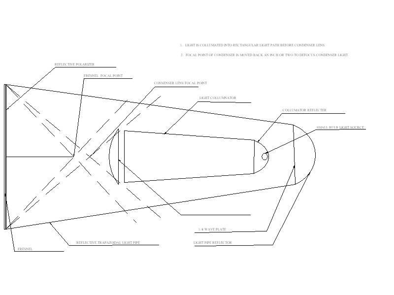

Guys'
Here is a refinement to the above design. It uses a pre retangular trapazoidal collumator to collumate the light from the bulb into retangular shape the same aspect ratio as the LCD before it goes through the condenser lens. Then the condenser lens focal point is set back a small amount from the fresnel focal point to defocus the light somewhat and make a more diffuse light image. Then the stray and non polarized light is recycled in the large trapazoidal collumator.

nice design hezz, that is getting a little large though lol well for my small stuff anyway, it would be great in your setup your making with the frame, that polariser stuff u are talking about is like a mirror, u cant shine light into it directly it has to go through on a very wide angle so i think in this case it wouldnt be too good in the above setup but somthing similar with a diferent angle aproch would work, all we need to do is to get the light through it and for the light reflected back from the frensel to get reflected back to the lcd, i think a simple filter could do this but its just a matter of wich one, u can bet your *** u would see a big difference in picture brightness especially on the bigger lcd's and ohp setups as they waste a tonne of light, i think the more we are looking into this, u get too see realy how much light we are actually wasting, (me anyway).

@ Hezz..
..could you, or someone else, explain something about that polarizing film? Is it the one fixed on external side of lcd (I'm referring myself to my fp 567s Benq) or is it one of the films between lcd and its enclosure seen when I stripped my monitor?
