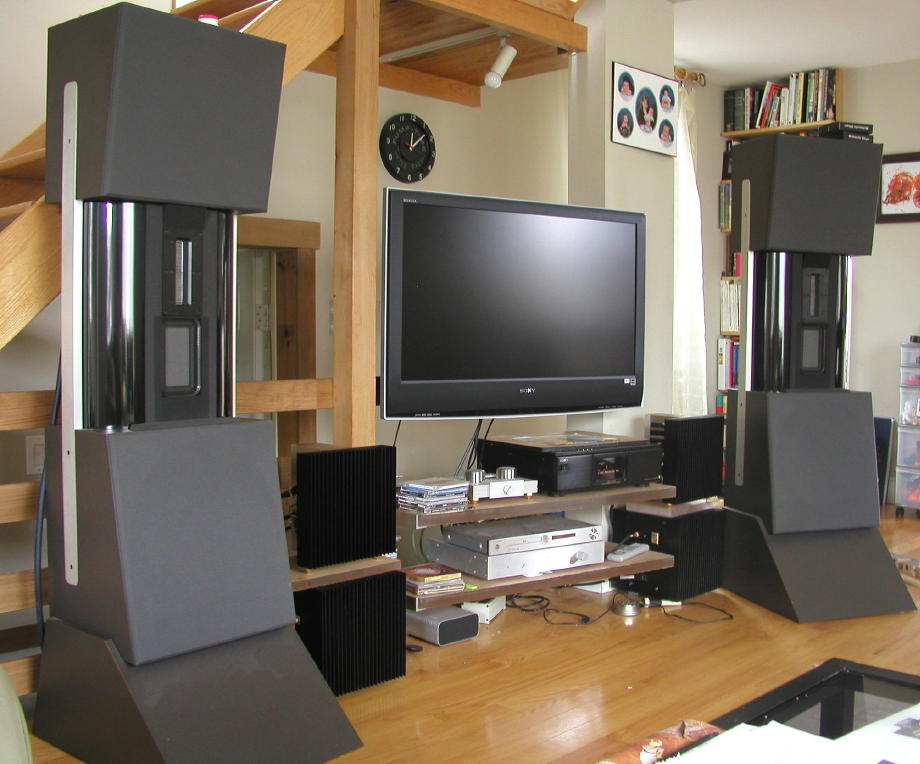

Now, after having the amp for almost a year, I may say something about the sonics. This is actually the first amp I built using Nelson Pass design that sounds similar to a GC. Maybe that's why I like it so much now.😉
Initially, it sounded fine, but lacked the specific "character" that I'm after. I was using it with full range Fertins and ML 380S preamp. Levinson preamp, although heavily modified, affected the amp performance substantially and I chose not to use the amp in my system. I couldn't use passive preamp, as my Bidat has rather low output (after I bypassed the output stage). After 6 months, I assembled the other system and I decided to try Zv9 again. But this time, the amp would run only mids and highs in bi-amp system. Initially, when Jensen caps were used in output coupling, the highs where not as refined as I like, but I thought why not try connecting tweeters through low value caps directly, removing 10,000uf Jensens from a signal path altogether. And that brought substantial improvement. I'm running Aurum Cantus ES G1 tweeters only through 6.8uF Siemens MKV caps and this takes the highs into completely different level comparing to Jensens. The FAL midrange is connected through 330uF BG N (both caps are connected separately to amp's output). For some reason BG N didn't work well in tweeter coupling, the highs were sort of diffused, lacking fine detail.
The two Focal Audiom woofers are driven through active crossover from A75 monoblocks. I will be looking to upgrade those amps soon. The preamp is balanced AudioZone Pre T-1 which works very well with Sony SCD-777 ES. Sony player has been modified with output taken directly after I/V op-amps.
The system is still in a process of development, but even now I like it quite much.

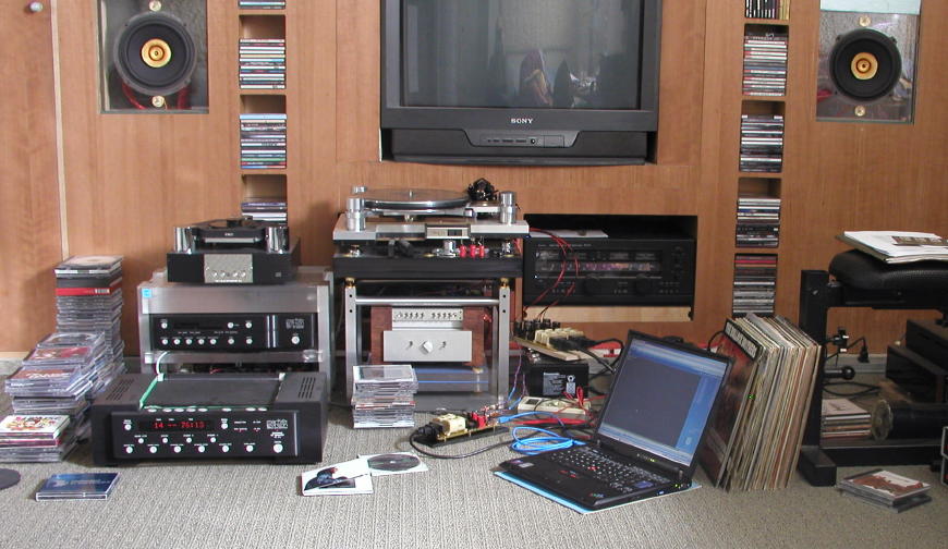

Wow, beautiful looking system Peter - does this mean you don't spend anymore time in the basement? ;-)
Do you find you have to cover the tv - are you getting reflections smearing the soundstage from it?
Isn't the F2 supposed to be very good for bass drivers? Have you decided which amp you're going to upgrade the A75 to for the drivers yet?

I don't listen to that system much anyway, it's a nice alternative to a basement system though and both setups have certain strenghts, weaknesses.
The critical listening is still done on a basement system as it's been tweaked for many months. This new one is still long way to go to sound optimaly.
I was considering F4 for bass, running it directly off the F3, but I'm afraid that efficiency mismatch between mid/highs drivers and woofers may be a problem.
I was also considering hypex modules for woofers or parallel LM4780s.
