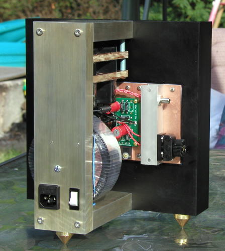

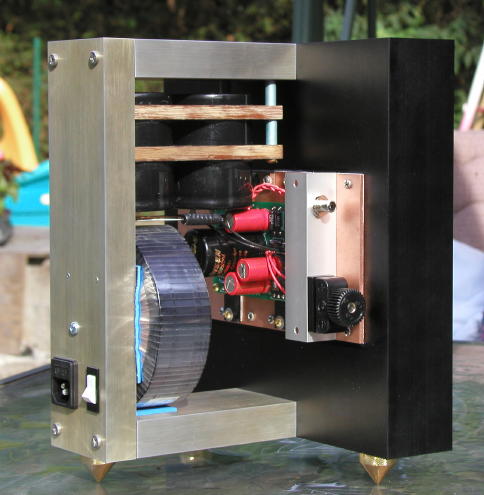

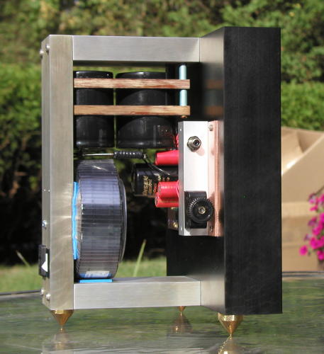

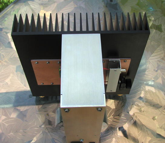

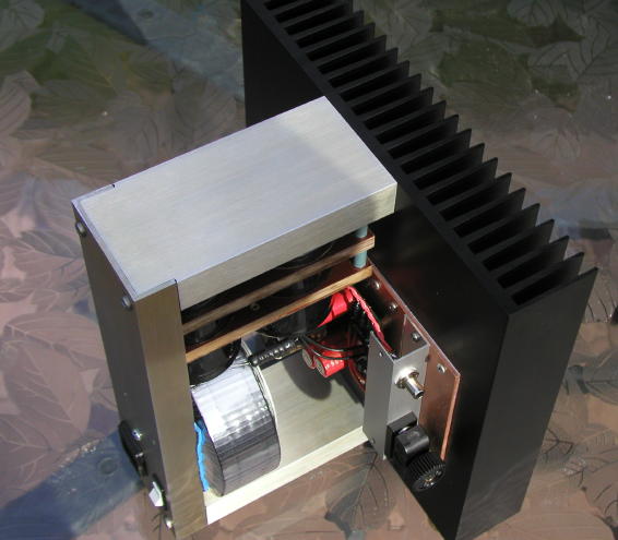

Here's my version of Zv9:
It is a very good sounding amp.

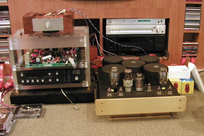

I'm using the amps with Fertins 20 EX which are approx 100dB efficient. Zv9 has much less gain than GC, I can connect NOS DAC directly (2V ouptut) and the sound is about normal listening level.
I only had it on for few hours, so it's hard to draw any conclusions. First impression is that it sounds softer, with less bite and less edge. How desirable it becomes, I will write in a week or so. Beside that, tonality and detail are very similar.
BTW, I didn't switch from GC today, I had Dick Olsher's T-Rex 300B amp in my system last few days. It is a pretty good amp too.

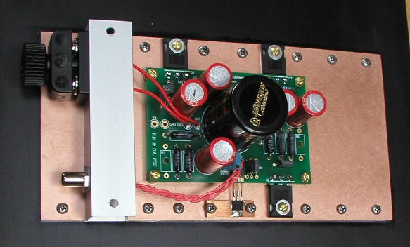

Looks good.
A few questions :
Did you solder the JFet?
Is that a copper plate that all the Fets are attached to?
Is there anything between the plate and the heatsink?
Alot of screws to attach the plate and I see you didn't use the PS board.
Simmonds
Yes, JFet was soldered to a small copper plate that is attached to the main plate.
The copper plate is 1/8" and acts as heat spreader/ heatsink damper. I used thermal grease to improve transfer.
PS board couldn't be used here, as it is designed for different caps.
Looks like a very nice build. I have a couple of your boards and hope to have my ampilifier completed this winter. Once again thanks for making this hobby accessible to me. I have a couple of questions.
In the first photo it appears that resistors R1 and R6 were left out. I can understand R1 being left out so that a value can be selected later to obtain lowest distortion. However why is R6 left out?
What is the size of the heatsink? I am planning on a heatsink measuring 6" x 12" x 2.75" fin height for each channel, do you think this will be sufficent?
Thanks.
I was using 5W Mills resistors, so instead of 3 x 3W Panasonics I decided for 2 x 5W . The combined resistor value stays the same.

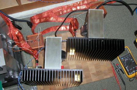

The heatsink is 11 x 11 x 2.25 . It is just about the right size. I used 300VA, 2 x 19V trafo and the actual voltage (with 0.27R resistor between caps) is 52V.

Was the T-Rex amp your build, or a loaner? I don't think we've seen
how you'd build up a tube amp.

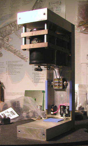

I try to use different approach to chassis building these days. Appearance is always secondary and form follows the function. If the idea of function is clearly defined, the form is not too bad either 😉
The transformer was initially intended to sit flat on a bottom bar, but it came too close to the circuit so I decided to mount it vertically.
T-Rex was built by someone else, but having the taste of 300B I will definitely build a tube amp myself as well. I still don't know which one though.
