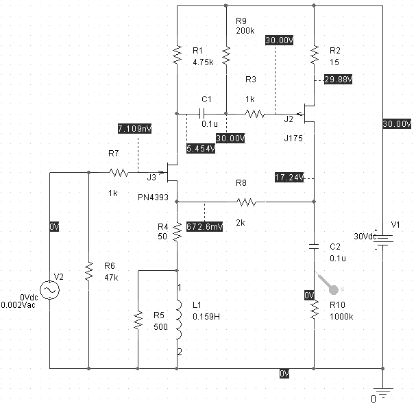

I have read on several occasions about using inductive RIAA filters, and how some pundits think they sound better than RC filters. One opmap-based feedback design that looked reasonably easy to implement was published in Audio Express a few years ago.
Attached is a schematic for a gain cell using 2 JFETs and feedback-style inductive equalization. The equalization is set up fro the first 50Hz corner.One could increase the gain of the circuit and add the second corner, or put the higher frequency corner in a second stage. The gain cell uses capacitive coupling, but nothing's perfect, and the couopling capacitor value is small enough that one could contemplate using a teflon capacitor.
Anyway, food for thought. I won't be building this one for a while, as I have a big backlog of projects, but I thought I'd sling the concept out and let i fester in public...

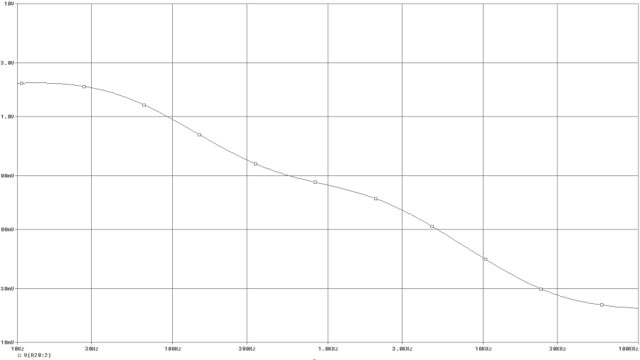

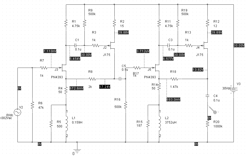

Attached is a picture of a more complete circuit, though I think a follower might be advisable for interfacing to the cold, cruel world. I want to look a the turnover points a bit more closely, though the 1kHz gain as plotted by PSpice is pretty close to my goal of 40 dB.

some cool stuff you have here ;-)
Still, your inductors are huge! I mean 159mH will be the big block of inductors; that beast will in practice maybe pickup so much noise that it's no longer useable for a phonostage. Further, the inductor is then iron-cored which usually limits bandwidth (probably small problem) and introduces distortion.
Have fun, Hannes

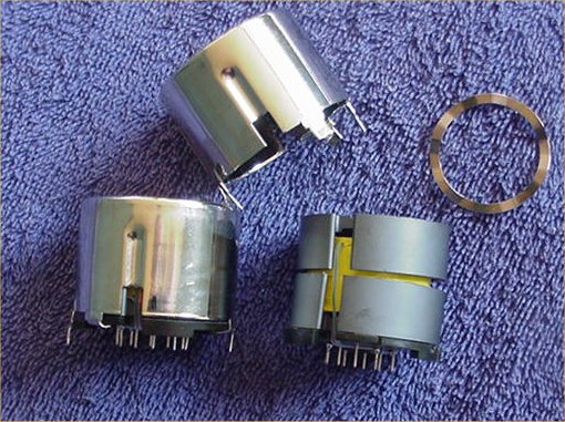

The inductor values are actually rather small compared to many other inductive RIAA setups. Wound on gapped ferrite pot cores, the inductors will also be reasonably sized and linear. The 159 mH inductor is ~500t on a 2616 pot core gapped for 630 nHT^2 inductance coefficient (a standard size and inductance coefficient from many suppliers). A 3019 core may be a better choice, requiring fewer turns. Pot cores are to a large extent self-shielding, and cans are offered as accessories that offer even more shielding. After all, pot cores were developed for use in high precision filter circuits where stability, precision, and freedom from noise pickup are all very important. I'm more worried about stray capacitance, though that can be fixed to a certain exent with a multisection bobbin (also a standard offering). The main thing to worry about is factoring the wire resistance into the RIAA filter settings.
I deliberately forced the design to accomodate a small value of gain setting resistor in order to make the inductor values more reasonable. A standard passive RIAA network would need to be low impedance (the standard ones available are 600 ohms and cost hundreds of dollars). At 600 ohms, the inductors are huge, and it requires a matching transformer or other sleight of hand to drive them. This approach here is very similar to one mentioned in a 2003 article in Audio Xpress, but that guy used an opamp, and I have a fetish for discrete JFET designs...
The local surplus emporium has canned 4229-sized inductors - as a bonus, they have the PC-mount base plates, and weren't varnished, so they're easy to take apart. As a last cherry on top, the bobbins are 2-sectioned, for a lower winding capacitance. These cores are a little larger than I envisioned, but they have everything needed to make at least the low frequency inductor for a L/R-type RIAA filter. Once I get my BA 2009 project out of the way, this might be next up.
That's why I'm using the circuit configuration I chose - it allows me to use 50 ohm impedance networks. This is much more managable and may be workable without all the extra components to compensate for strays. Time will tell. Fortunately, we have a very good impedance analyzer at work, so I'll be able to really scope out the inductors once they're wound.
Just so folks know what to look for, attached is a picture of some ferrite pot cores, one all canned up with shield and PC mount bottom plate, another disassembled so you can see the slightly separated core halves, the bobbin inside them, the bottom plate, the can, and the wavy washer placed inside the can on top of the core so that the ferrite pieces don't get crunched when the can is clinched tight to the bottom plate. These cores happen to be 42 X 29 mm,pretty much the largest size commonly available. There's a host of smaller sizes, for this application those from 26 X 16 mm upward are probably most suitable.

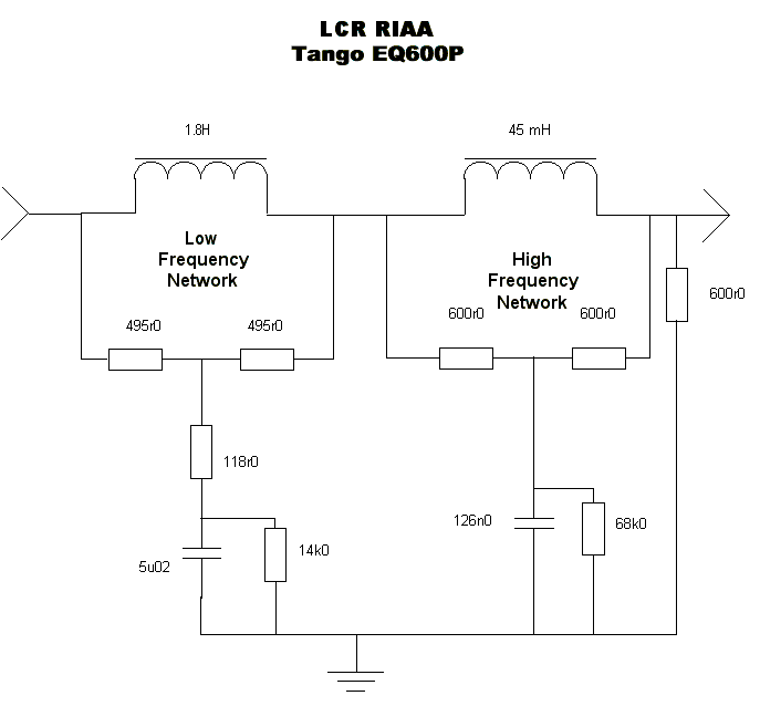

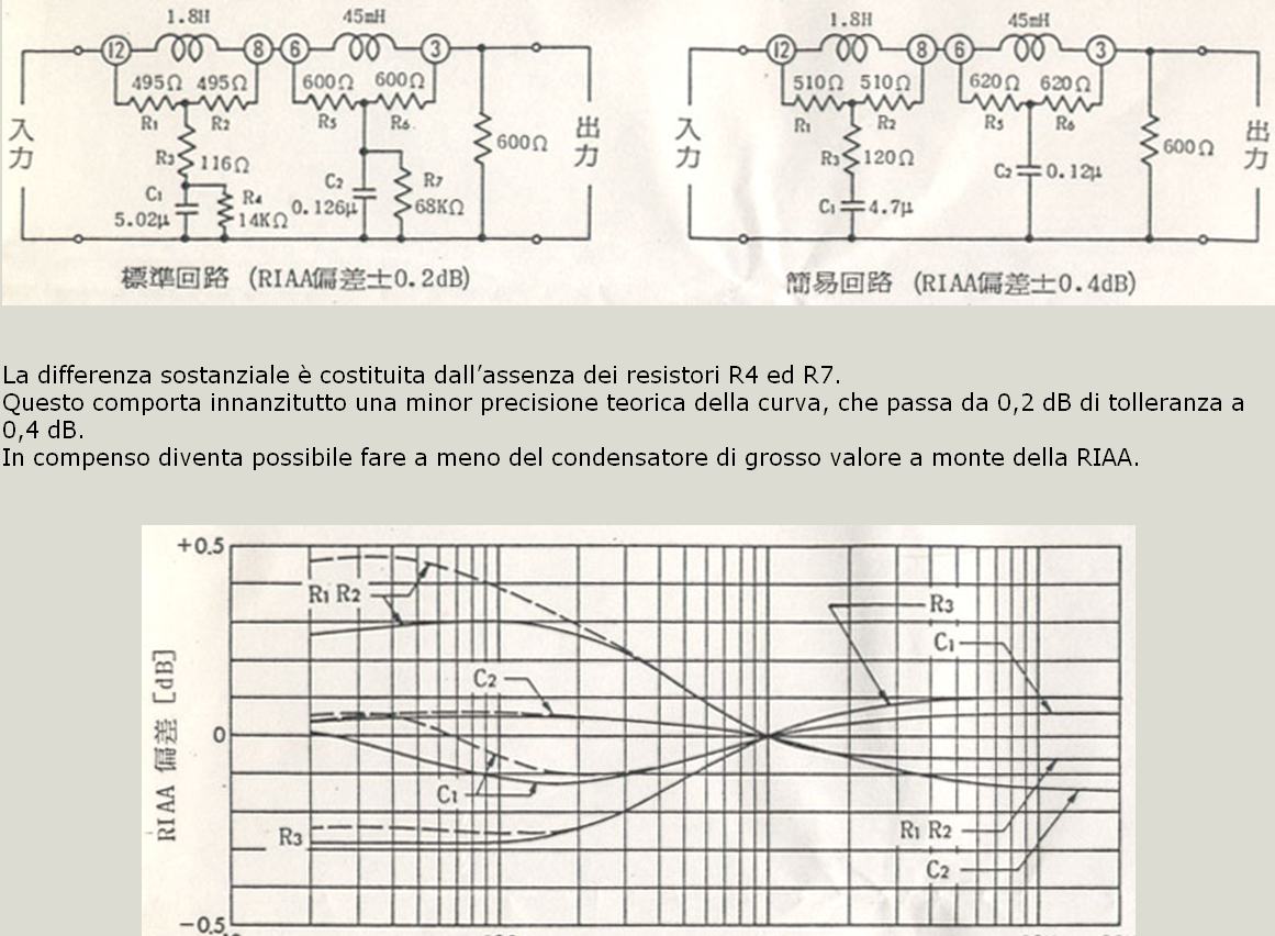

I start to build a lcr tube phono ,thorsten design he use the
s&b600 , this one is more simple rispect the tango eq 600 , but riaa is in the 0.3db (0.4) rispect tango 0.2db but this can put the dc bloc caps after the riaa on low value0.1µ

wrenchone sorry if you thinks that I disturb your work ,I no need info, I try add as I study for a month in all world wide web
if we can trust Bench-Thortsten-Mayer and a lot skilled diy ,this coil works a lot better then RC riaa at last on tube,as they put under x-ray with real misure....only problem is$$$
