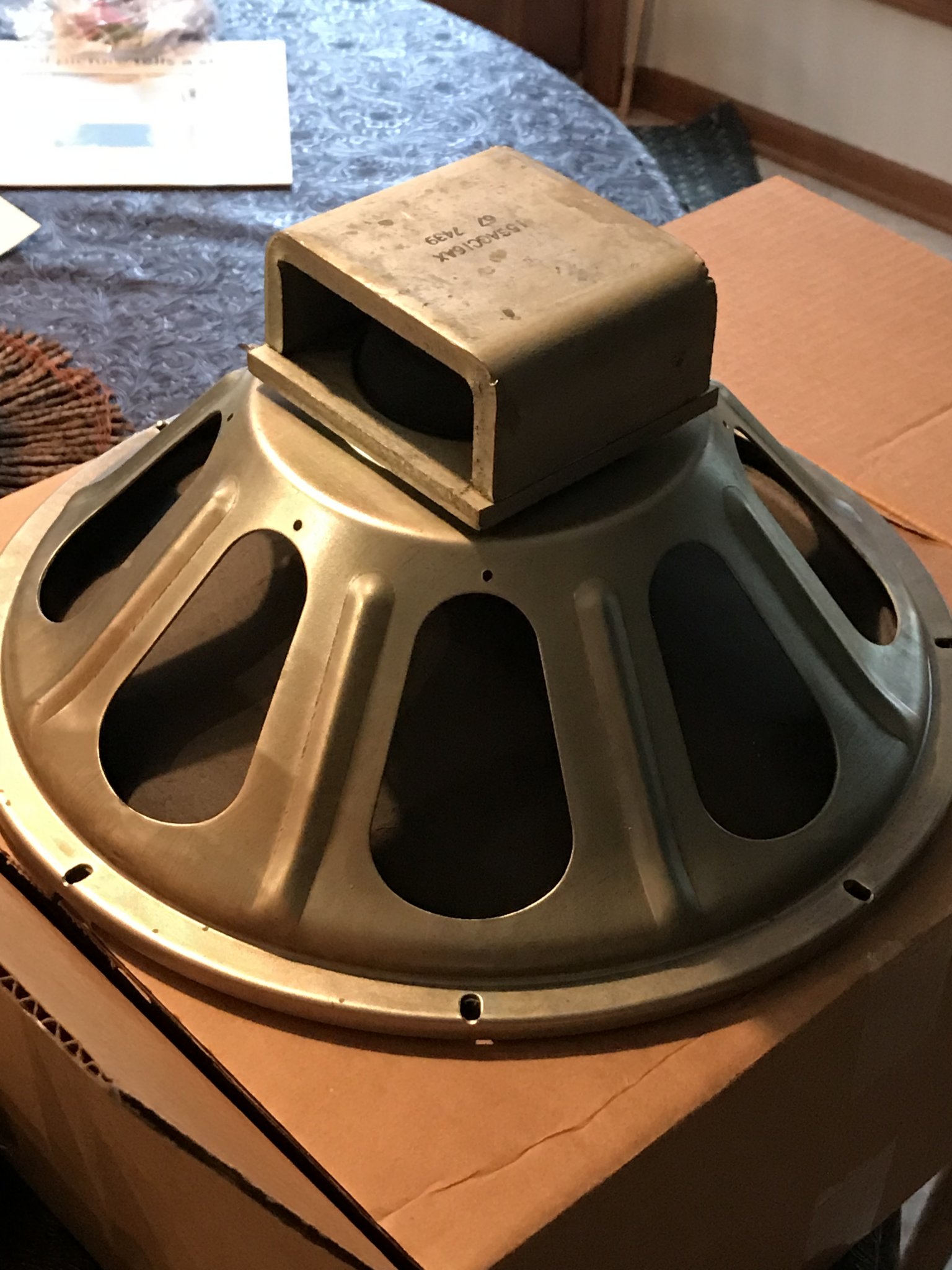

So I’ve already searched for eminence 15” vented aluminum dust cap and the numbers on the back with no luck. Guessed at Eminence as the “67” suggests they we the source, but no other reason to assume it. Any ideas?
No writing on the cone. Should have mentioned that in the first post.
It came in an eninence beta-15 box, which also suggested eminence, but I’m betting the beta replaced this and they reused the box as this doesn’t look enuf like a beta-15.
But its not blown, so nonetheless happy. Just wish i knew more.
lol, here were a plug is 240v 16A, that's 3840W at 50hz, so lightning and thunder...The number indicates Eminence made the 39th week of 1974.

BTW. I suspect the bass player who tried this speaker didn’t like it because it isn’t a bass speaker! Light cone, highly ribbed, and curvilinear, 2” voice coil. No way this is a bass player’s speaker.
Not sure I’d play lead on it either. I more expect it was made by Eminence for an organ or console stereo.
That would be my guess, maybe a bit more than that since I did take it out of somethingEminence for an organ

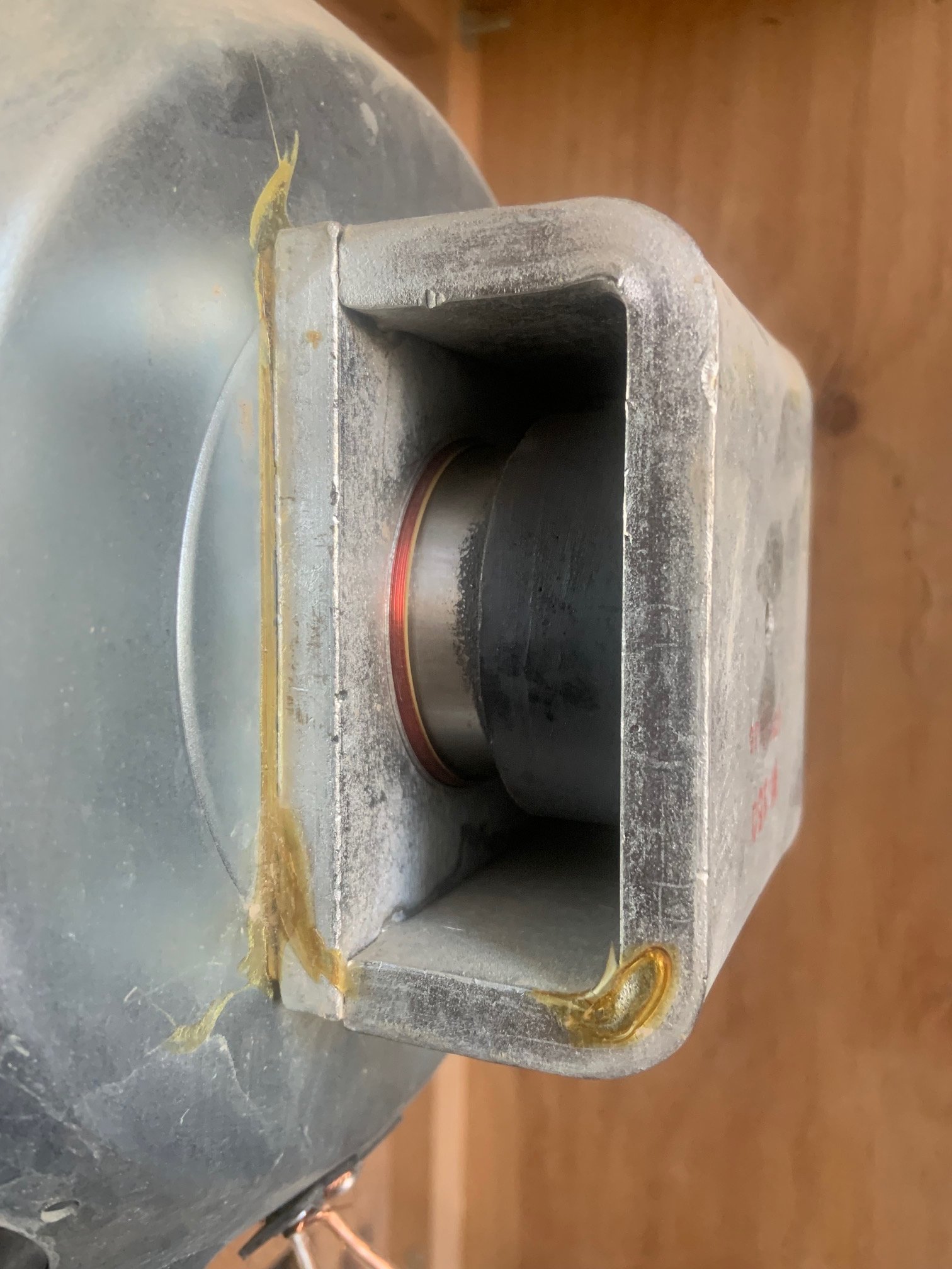

Can you get a better side shot of the magnet?
I may have a pair with identical stamped frames and a full range cone instead.

DC. Let me know if you need a different pic.

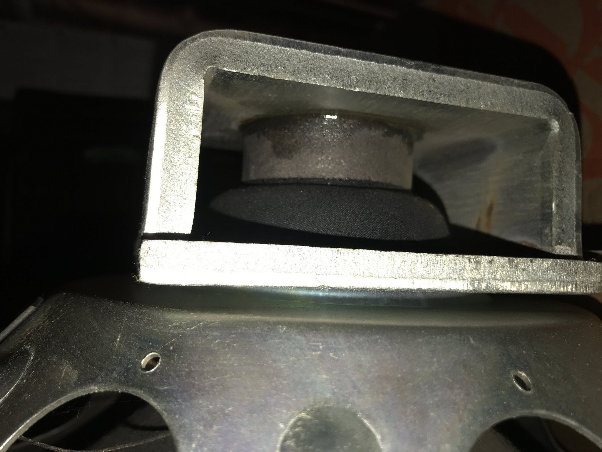

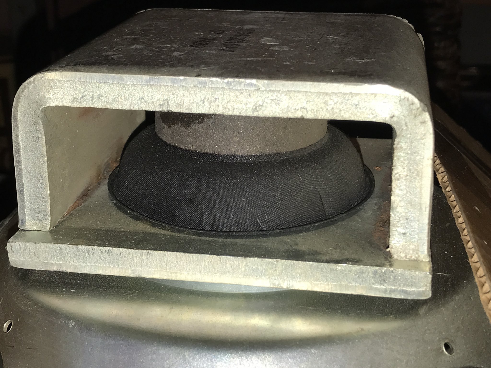

My driver looks more like this as far as magnet structure. You may be able to measure xmax by pulling up the cover and measuring coil overhang.
Likely would be a good midbass driver.
Just measure with REW to see if there is much upper midrange breakup or not.

Did you move tgat cover fir the picture or is yours missing?
Mine seems to be held down against the basket pretty well, so not going to force it and, of course, want to keep it in place to keep dust out
I pulled the cover to get the picture. Cover was sort of glued on but is also magnetically attached.
